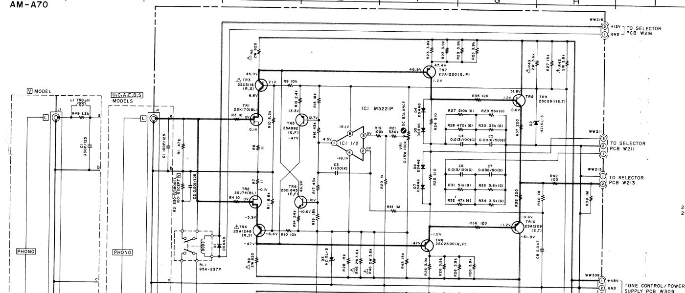

Glad you asked. Here is a cheap integrated from a distinctly non audiophile company. Regulation is similar to the Accuphase. Part quality likely is not.

We should not forget, that the development of the AD-9 Phono module may several years ago. Today it is more wise to use an LT1115 or similar and a nice little Op-Amp for DC-servo.
But I often heard, that some "magic" is inside discrete setups. I never understand this personaly; all the thermal issues as well as the accurate selection of the FET/Transistors used for the differentional amplifier will lead you in lot of problems and.. is more expensive as an integrated version.
