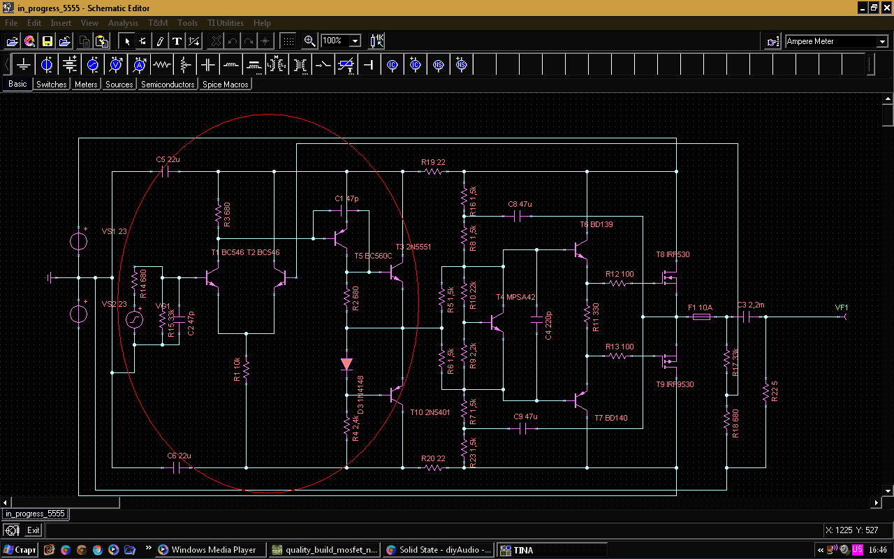

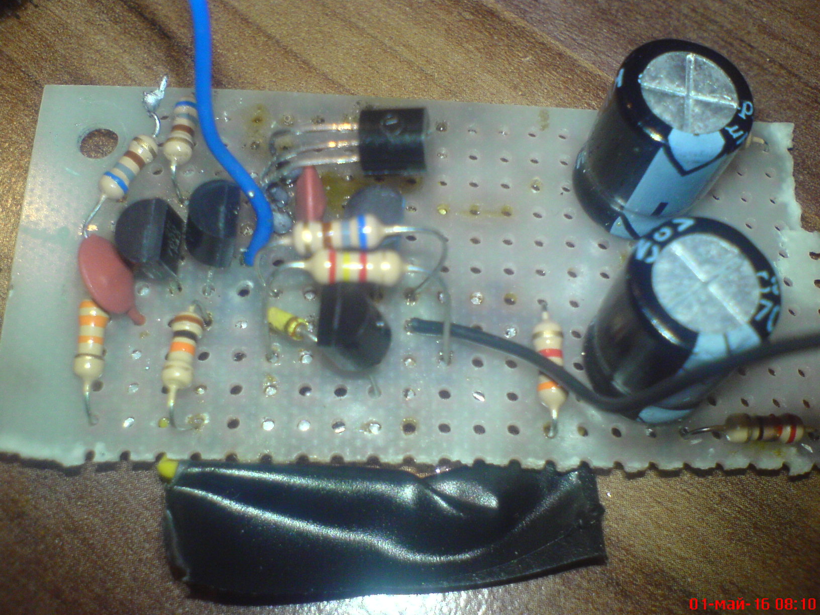

Hi, i built this and the 22 ohm resistors start to burn, protecting the bc560 from death
Any suggestions why not working, frying T5 ?
Im using 2n7000 mosfets instead bc547.

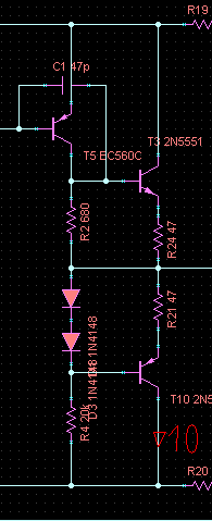

OK, there are many sub-optimal things in the circuit, but the main question again - how do you choose the quiescent currents for the cascades?
T5 quiescent current is around 1mA (a bit low to my taste), the one through T3, T10 - around 10mA (this is rather a lot for TO-92 transistors). You don't see it in the simulator, but in real life these two will be rather hot.
Although, having all this, 22R should not be burning, so there is something wrong in your implementation. Are you sure all the transistors are soldered the right way? BC5XX and 2N5XXX have got different pinouts (just in case)...
yes im sure .. 🙁 with 1ma gived best distortion result.
how they getting hot ? i am pushing them to 1/2 of their Pd limit 625mw ?
High frequency oscillation?

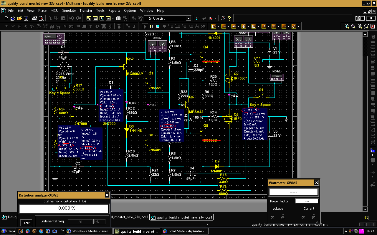

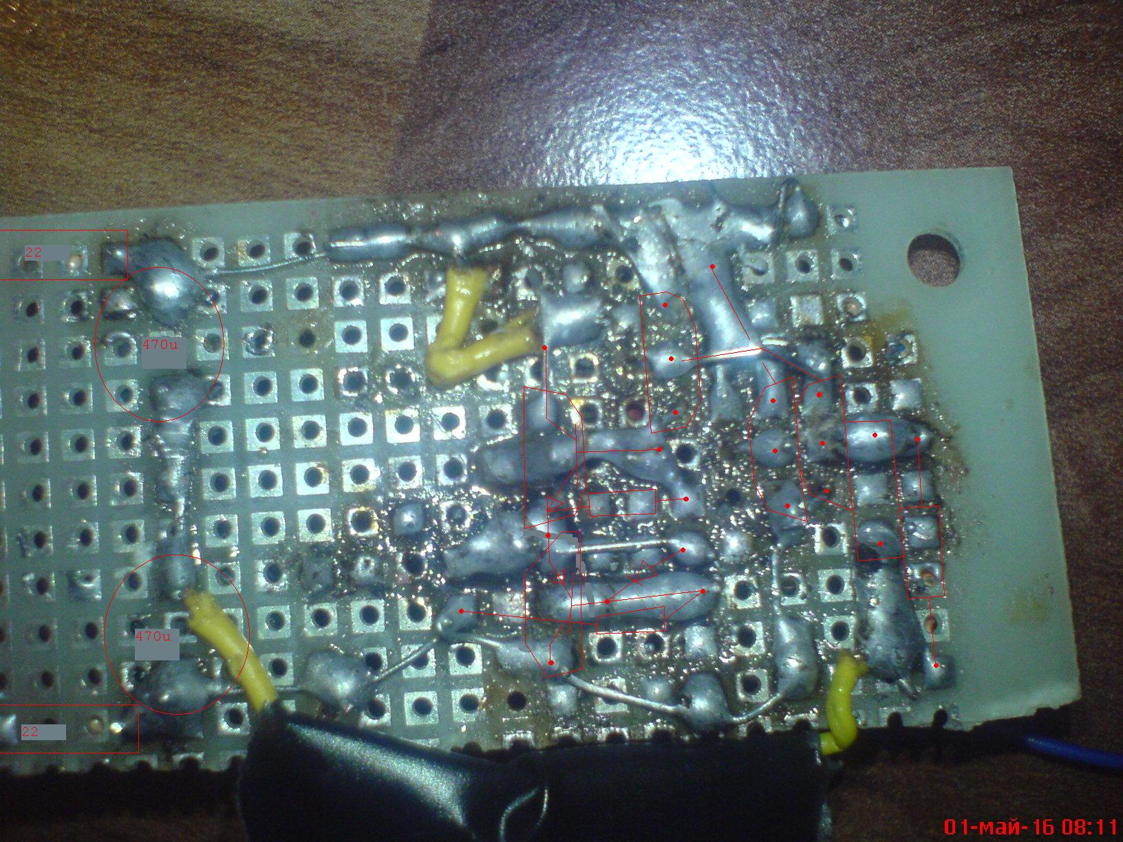

i added attach where i drawed the components in paint, open in full size to see the drawings.
R4 sets that current at about 9-10 mA. Yes?
R2 sets Vbe of T3 at about 6.8V...if it could get there.
So actually most of the 9-10mA is going to be base current for T3
What is current gain of T3?
That is the current through 22R...more or less.
Close?

Guys, what are you talking about?
In normal operation, the current through those 22R resistors is roughly 12mA.
Simple calculation (P=I*I*R) gives us dissipation of 3.1mW on those resistors.
Even 1/8W will work fine there.
The point - it's far from normal operation...
OK - you asked for it.

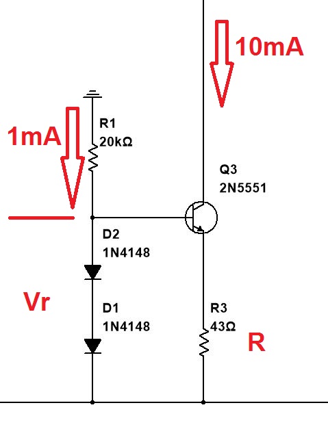

Look at the way your dynamic load is organized (T10).
It's only partially dynamic (I would say - very slightly dynamic).
In fact, only 3.5mA from overall 10.7mA goes through T10.
The normal way of arranging the dynamic load is using a CCS.
A simple CCS is arranged the following way:
- take a voltage reference Vr, more than 1 x Vbe (2 diodes = 2 x Vbe = 1.4V will be OK; 1 Red LED = 1.8V will work as well);
- take NPN transistor;
- set your voltage reference between the CCS transistor's base and the negative rail;
- use a resistor R between the CCS transistor's emitter and the negative rail - that's the one, setting the CCS current, which is Iccs = (Vr - Vbe)/R;
- now you can convert the formula in a way that R = (Vr - Vbe)/Iccs; that's the way you find your R value.
See attached.

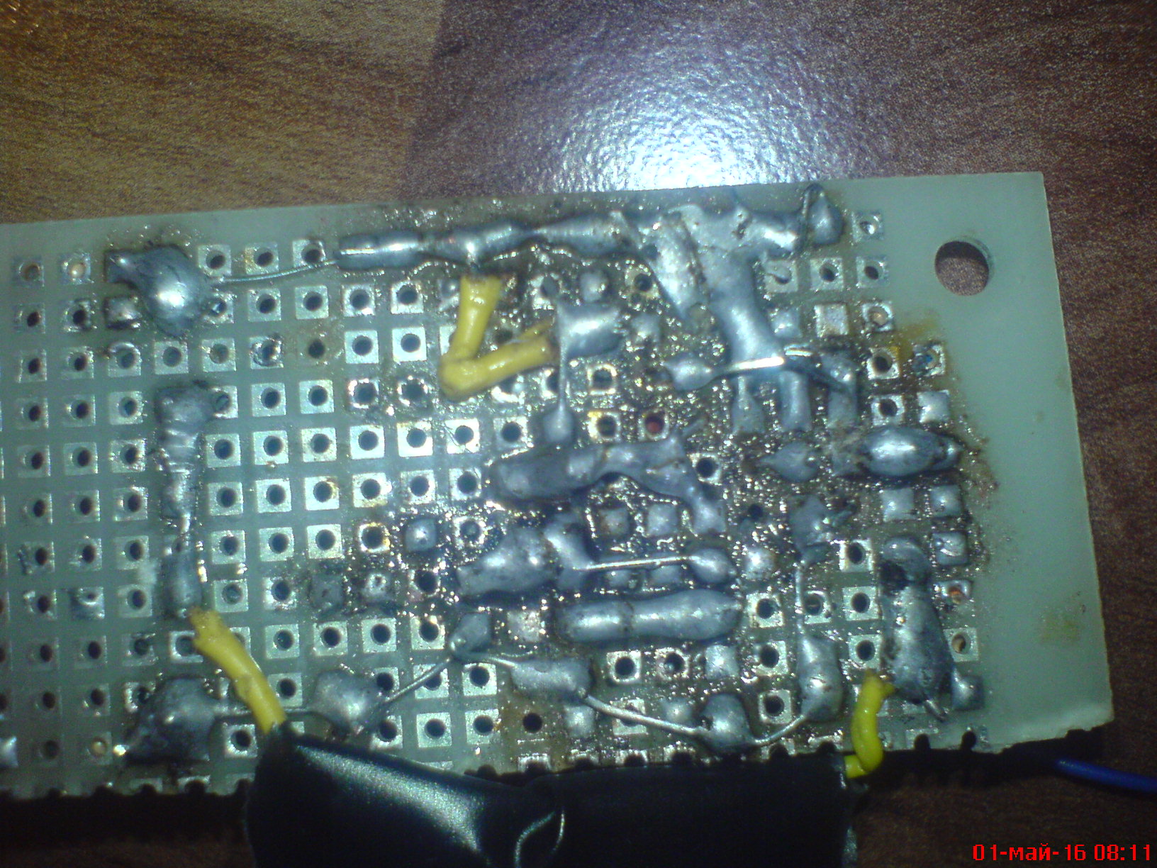

Soldering quality. There are lots of flux remains everywhere. I don't know what flux you use, but most of the liquid or paste ones conduct rather badly. Accept a simple rule - make the board clean and dry before you switch the power on. Otherwise many surprises may arise, very difficult to diagnose.

you said "Look at the way your dynamic load is organized (T10)"
i am not using dynamic load since the local feedback (R2(two purposes)) lowers the distortion as dynamic load. i dont have good common sense about dynamic load.
im using T10 for another purpose, (if you drive lateral fets directly)(capacitance)

i dont have smth to clear the flux.

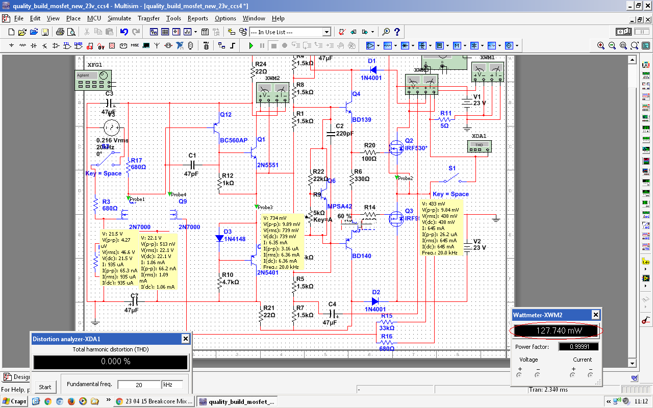

what is the maximum Pd without heatsink ? 1/3, 1/4 ?

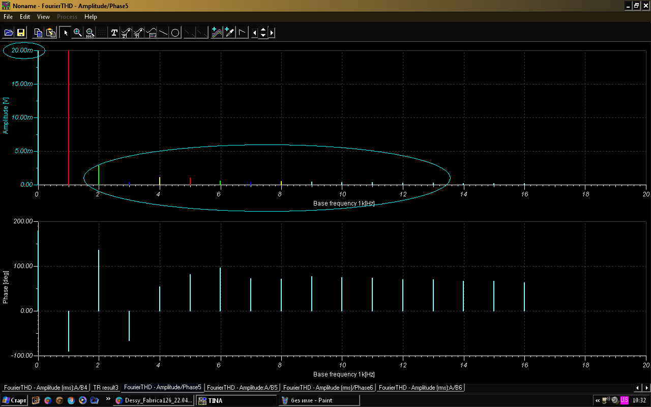

if you want dynamic load this is the way (the attachment), but,
@ 20khz fft is worse than mine's fft (mine is beauty and H2 dominant). (uploaded fft is @1khz).
mine theory is that this current must'n be constant !

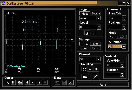

this is the version i will use if 128mW is ok without heatsink 🙂
gives me THD 0.068% @ 20khz and perfect square.
WHat else ?

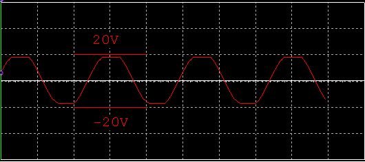

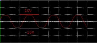

and this is the clipping @ 316mv rms

Those resistors are normally used not to protect something - they are parts of the simple RC filter, used to decrease the rails ripple for the front-end.
Stick for 1/4 or less - more or less safe for now.
In some cases, if no thermo-compensated references used to set the operating points - even if the transistor is barely warm, a small local heatsink is recommended in order to stabilise its operating point.
This is not a dynamic load. Can you see the difference of what I have attached to my previous post and what you have attached to your previous post? Nothing close to dynamic load. The structure on your schematic does not make sense at all - what's the reason of having emitter of T10 connected to the front-end output. The result is the opposite to what you are trying to achieve.
This is the wrong theory 🙁
Unless it's a push-pull, driven from the both ends, or current-mirrored.
But let's stop here for now - at this stage, just take as granted, that the true dynamic load will give you much less distortion than any reasonable resistive one.
