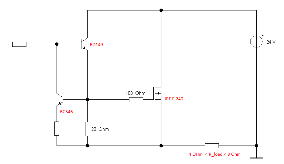

I am currently trying to sort out the content of your thread and find a common red thread for myself. After the second page of discussion, I'm already counting and looking at almost 20 circuit examples and inserted ideas ... In the meantime, the entire thread seems rather frayed to me personally.
What can we actually get involved with - a modern JLH that, like the original, impresses with its simple and very clear structure and is beautiful at first glance?
Although I can completely understand all your ideas (the ramifications), I would like to see a focus on a topology, a final definition.
At the end of the entertainment program, I wonder if there will be a rebuildable construction proposal for a Henk_JLH_2024. And also whether a beginner can learn to develop their own JLH here.

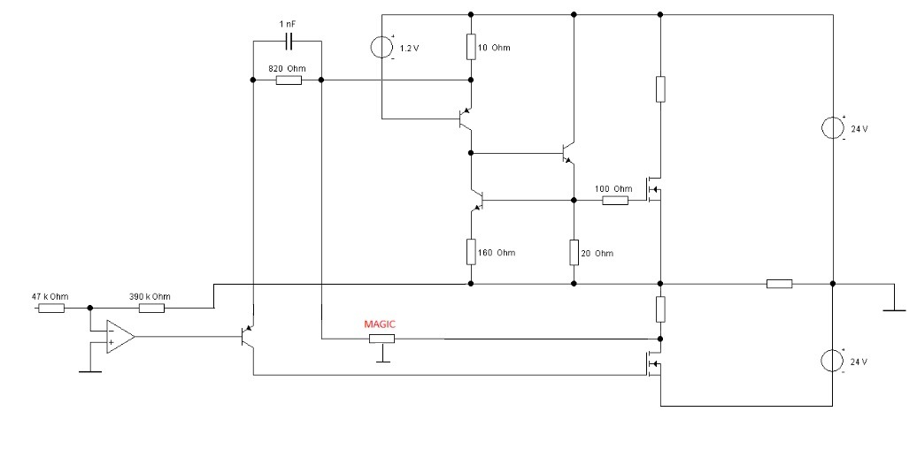

I figured out the location of the parts for a version of the circuit with common-mode stabilization:..
I think a board measuring 100x100 will be just right for the model.

I looked at the service manual for this amplifier - no, it doesn’t even come close in topology to the variant with common-mode stabilization.Do you know the power amplifier of the NAD C300? Take a close look at it, it immediately popped into my head when you introduced the MOS-Fet's.

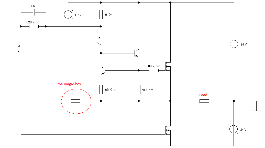

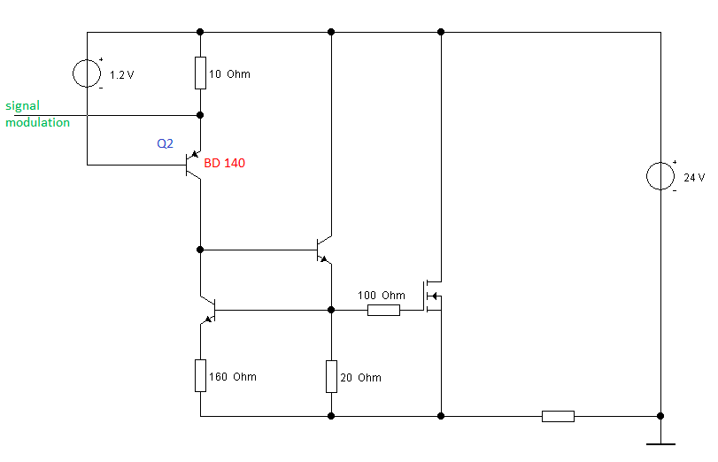

In my version, Q2 blocks nonlinear feedback through the upper of the power transistors.
Let's see what the phrase "commen-mode-stabilization" actually means: "Gleichtakt-Aussteuerungs-Stabilisation"

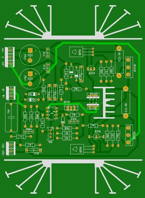

But we seem to be approaching our goal, and a first layout is now available: the Henk "Gleichtakt-Aussteuerungs-Stabilisierungs JHL-Ding" Amplifier 2024 with Hex-Fet IRFP240.
Well, that's not what I said.I looked at the service manual for this amplifier - no, it doesn’t even come close in topology to the variant with common-mode stabilization.
Well, the output power transistors of the same conductivity type are controlled for symmetry by a common-mode signal. stabilizing this signal increases its symmetry.Let's see what the phrase "commen-mode-stabilization" actually means: "Gleichtakt-Aussteuerungs-Stabilisation"
This is for the bipolar option.But we seem to be approaching our goal, and a first layout is now available: the Henk "Gleichtakt-Aussteuerungs-Stabilisierungs JHL-Ding" Amplifier 2024 with Hex-Fet IRFP240.

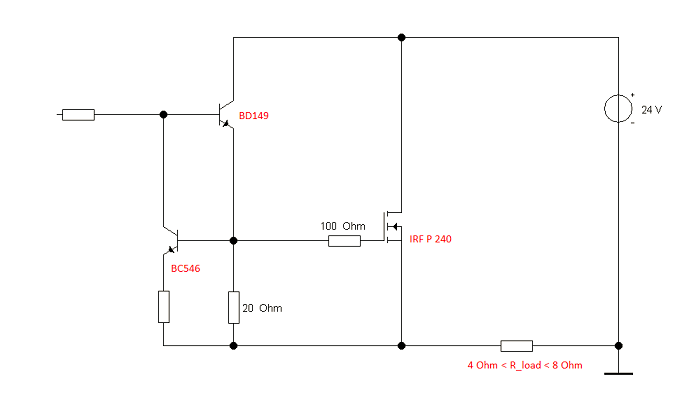

For the unipolar option there is already one and it also works very well:
https://www.diyaudio.com/community/threads/hennadys-take-on-the-1969-jlh.409972/post-7636101
+ electronic filter: https://www.diyaudio.com/community/threads/hennadys-take-on-the-1969-jlh.409972/post-7635766
Please explain this point in an understandable and technically correct way.

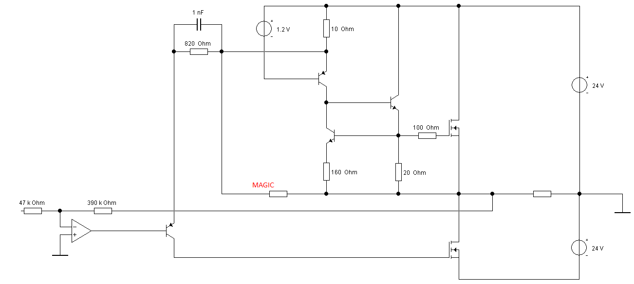

Now you take an operational amplifier and put it in front of the input as a differential point. This is not art.

the whole egg dance revolves around the so-called quiescent current stabilization (nothing else).
Your 40W at 4 Ohm load specification is very brave of you with peak currents of 4.5A sinusoidal, let's see how long a single IRF on its tiny heat sink can survive.
Now please put an iron in the fire that can really be forged, everything else is just playing around with MicroCap12 - and you know it.

That’s right - that’s what common-mode stabilization is called.Dear Hennady,
You simply don’t see (don’t want to see) the result of this stabilization.
A distortion in the current of the lower arm of the power transistor leads to a distortion in the symmetry of the control transistors, this is necessary so that the sinusoid becomes more similar to a sinusoid.
