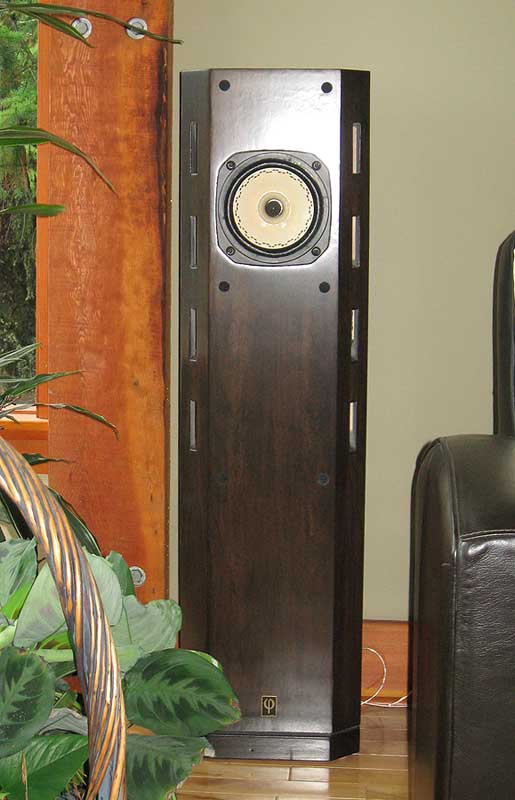

If you're considering the half-chilli, I can tell you that Dave's Fonken167 design is an excellent performer. It's approximately the same footprint as the half-chilli, and has very high WAF, although much higher build complexity.

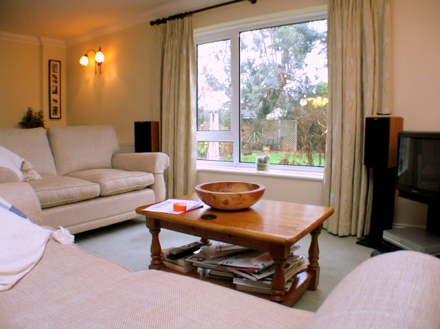

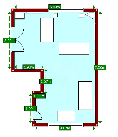

I have attached a picture of my listening area along with a plan.
I hope this helps
Richard
Richard, unless you can relocate furniture or speaker placement, I'd imagine than the the half-chilli design would have some performance issues with the left side's vent firing directly into the sofa.
(the placement of speakers in photo doesn't exactly match the floor plan)
FWIW, the slot ports on the beveled sides of of the Fonken167 design are high enough to probably clear the sofa.
I'm prodding Dave to get the in-room photos of those posted on his site gallery, or at least in this thread.

Richard - having built at least a dozen pairs of the stand-mounted Fonkens (FE127), as well as several floor-standers by both Dave and Scott, I can agree that the Fonken is not the easiest build.
