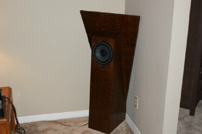

I made my own filter and it probably is specific to my cabinet. I did frequency responce and impedance plots of both the driver elements and they intersected at 612hz . The high frequency out put is 6~7 db stronger than the bass so a "L" pad was made using 10watt ceramic resistors to pad the high frequency out put I used a 12 db slope Linkwitz Reily configuration and crossover point was set at 612hz with a slight hole in the middle. so basicly the bass is crosing out at 600hz and the highs coming in at 620hz. on the impedance curve for the high frequency the peak impedance is at 500hz so the driver should be crossed higher to stay away from the resonat point. I can look up the values for you if needed. here is a picture of the Vanderhorn Angel cabinet using the co15V I'm still very happy with this set up and it remains un changed for 2 years which is a record for me. i am also making smaller versions with the singel driver format 8inch also very impresive sound in a very compact rear loaded corner horn.
Compact 8inch rear loaded corner horn angel
Hello I tryed to post the pictures I think the file is too large, if you email me I can send some pictures I just finished the 6.5 inch version as well and I am very surprised with the quallity of the bass and performance it is still putting out 90db of 30hz at one watt.

I tried the picture again and reduced the file size. Hope it works. If not, email me.

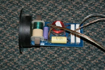

The crossover shown is the same as the one I made when I had the co8 in my angel cabinet.i sent this to Perry so maybe that is where it came from? I still have the response curve I took when I used that set up, it should work well for you . what type of cabinet do you plan for it ? Here is a picture of the crossover, I still have them...

Thanks for the pic again.
Yep, that is it alright. The design I have came from Solen (was pen drawn) and I did that design in Photoshop.

Hello spacies, yes thats the crossover then, more of a scribble, than a drawing I didn't know it would get sent like that.

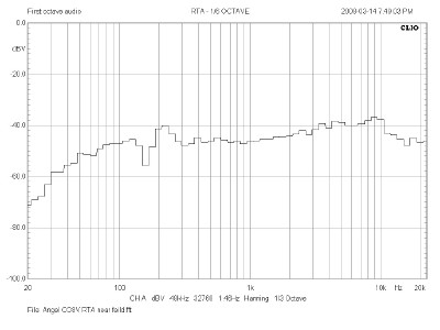

I looked up the file for the responce here it is if it not to big a file this time.
I don't have the co8's any more,I just had them on loan from Perry to make this angel cabinet for the 8 inch. I have the co15v in the larger original angel cabinet. The configuration seems to scale down nicely. I would recomend it if you can do a corner placement.The sound is very much like an open baffel with extended bass responce. Yes I will sell the crossovers if you want them i'm open for offer.Here's the response plot

Yes Micheal it's the same. I had used an iron core inductor but probably a litz air core inductor and better caps would be better. I had scavenged the inductors from parts I had pulled out of some old crossover, I don't know what the brand was. The drawing was the one I sent to Perry. i'm sure you will have no trouble making that ,and tweek it further. are you making the cabinet from the 1965 popular mechanics artical? I have another drawing that I received from my lawyers when I did the Patent search for my corner cabinet, it looks interesting too.

I can sell the crossovers for $20. for the pair and shipping but you would probably want to remake some with better components. Yes the 15inch version is increadible. I get a cabinet fc of 22hz! the corner loading is the way in my opinion. I'm going to remake the 15inch cabinet to be more appealing visualy,but performance is wounderfull as is. It easily out performs the vita vox K horn clones I had listened to for 30years. (39hz was the limit for them) I am finding that the even smaller versions still keep the low bass and the driver quality remains unaffected from 140 hz and higher. In the 15 inch the bass excursion is so small I don't know how it can make bass, but at the same time I can literaly bounce the picture on the wall above it. The bass is very well defined with no boom or mono tone,or any cabinet tone at all. The angel design has a 7 ft horn lenght for the 8 inch version and a 9ft horn lenght for the new 15 inch version,the mouth opening is the space above the wave guide so it is quite large. I don't think you can beat that in somthing that uses less than 1 sqft of floor space for the 8 inch and 2sqft for the 15 inch cabinets. i'm working on some 6.5 inch cabinets,and then I will redo the 15inch,and then start on one for the 12inch. Fun wow.

Thanks Dutch! I did model those values in software and it looks like a x-over point of about 1200Hz, with a big dip at that point. But that's just based on a flat 8 ohms in each section, not real curves.
It's that big cap in the LP section that puzzles me. ~13uF would be the more expected value.
If I get a chance today I'll run impedance plots on the drivers, that would be better for x-over modeling. FR curves will have to wait.
