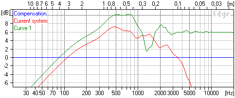

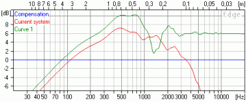

Regarding the baffle width: The diagram below shows the response of a 40 cm wide rectangular OB on axis (green) and at 30 deg (red). A baffle of that width is not optimal above 1 kHz, if constant directivity is a design goal.
Rudolf

Hi Rudolf,
The falling response below 300 Hz is purely due to the dipole baffle loss. The driver itself does not work less below - it has to work more!
It is absolutely necessary IMHO. And you will need at least 12 dB/oct.
this seems to contradict what have been said in previous posts. I am still confused about the relation: OB vs excursion.
Rudolf
How did you get this simulations? So what would be the optimal baffle width according to your simulation?
With EDGE.
There is no "optimal baffle" width per se. It completely depends on your individual preferencies. If you strive for best controlled response off axis, as I do, the baffle width has to be small enough to keep the lowest dipole peak at the upper end of the planned passband. This will raise the EQ demand somewhat.
If you want to minimize your EQ demand, you make the baffle as wide as your wife allows. :rolleyes: And forget about constant directivity.

Isn't that true?! The green line is typical of the Jamo R 907 Open Baffle with the dip at ~1KHz.:p
if the baffle is "wide" relative to frequency, it seems that the response drops and becomes ragged.
What causes this?
The lowest dipole peak is followed by a dipole dip at twice that frequency. Both are followed by more peaks and dips. Peaks whenever front and back wave are in phase, dips whenever they are 180 deg out of phase. Off axis those peaks and dips occur at different frequencies than on axis:
See Linkwitz:
That's right. We have tried to explain that for the R 909 at Open Baffle Speakers. Look for reply #4 and 5.

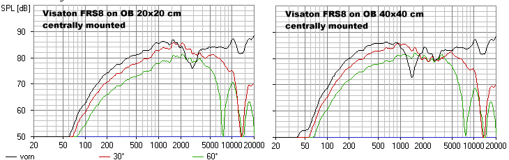

Hi Rudolf,
are you interpreting Linkwitz correctly?
If the baffle gets wider, then the rear radiated path length gets longer.
Yepp.
That is not addressed by the graphs you linked to.
That's right. The graph is only about the dips and peaks and their change with angle.
When the path length gets longer the first null will be pushed higher in frequency and less deep.
In this case it's the other way round.
Please explain further in case my cursory scan of Linkwitz has picked this up incorrectly.
I am not sure I understand where you want my explanation. So I just did a sim with two different baffle width. Would you mind to guide me to the effects you were writing about - if they show up in the graphs?
If a design goal is best controlled response off axis:
. . and gainphile your rule of thumb: baffle width <= 2x driver diameter is accurate,
which it seems is broadly supported by Rudolf your sims with two different baffle widths for the Vistaon . .
