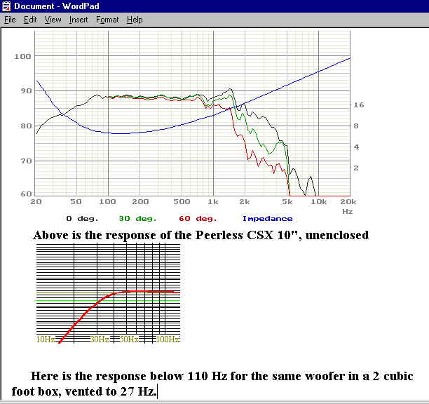

Here is a chart of the CSX response in free air, (unenclosed), and the bass response in a 2 cu ft box tuned to 27 Hz. The latter was derived using the WinISD free software program.
Here is the chart:

Yes. David Weems in one of his books recommended adding a small value cap, say 0.47uF in series with the peizo to tame the top end. I tried this once on a speaker I repaired for a friend and it did work. Hi Fi World on one of their published DIY Audax kits using the Audax gold dome piezo used a similar solution to smooth it's top end as well...

The rule of thumb is that speaker stuffing is to be counted as the thickness you get when you squeeze it as tight as you can with your fingers. In most cases, an inch or two of stuffing squeezes down to virtually nothing. Do not fill a vented box with stuffing-just line the walls with an inch or so of the stuff.
2.18 cubic feet sounds just right for the woofer. For a 3" inside diameter port, use a port length of 10 3/4" long. Add your tweeter, and you are all set. All for under 100 bucks a speaker.
