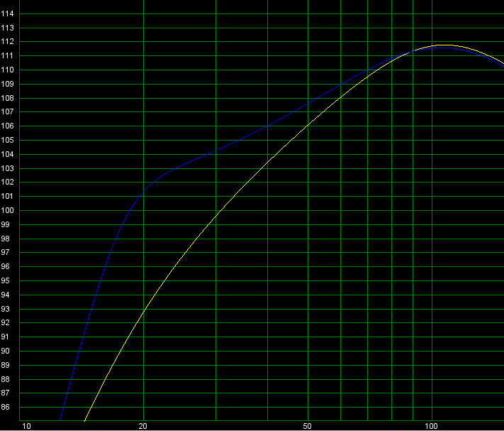

Ok, I've come to a nice compromise with 2 designs using the Peerless XLS 830500 driven by 200Wrms plate amp with 17Hz hp:
Critical Q=0.5 sealed sub: 32.5L box
or
Vented 65L (tuned to 18.5Hz)
Port: 100mm diameter Pvc pipe x 1.0m long
Flares: 50mm each end

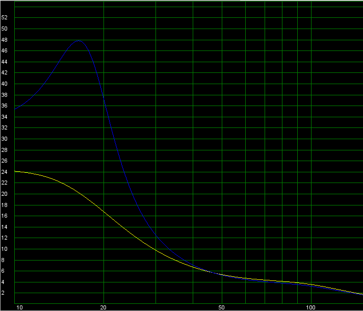

This vented arrangement including the highpass filter at 17Hz ensures that the cone stays within its excursion limits below 20Hz. Also, the port velocity never exceeds 20m/s so port flare of 50mm at each end is heaps to prevent chuffing (should be fine up to 30m/s, will make bigger if I can be bothered).
Group delay is a maximum at 48ms at 16Hz, which, according to the GD wiki, should be unnoticable at such a low frequency.
Here is a graph of group delay vs frequency for the 2 subs above:

And graph of SPL vs Hz (without lowpass crossover):
(yellow = Critical Q sealed)
(blue = vented)

I see you have included a high-pass filter in the model. This does make the initial design harder IMO. I start off by getting the low end right then doing another pass at the design with the filter added. You may have done that, I don't know.
Both of those designs are going to need EQ. I think you can shrink the vented box down a bit.

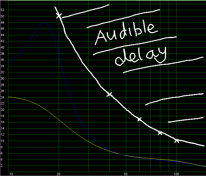

Btw here is an updated graph showing the theoretical fitted curve of inaudible group delay superimposed on the graph above:
(NB: Paul Spencer says these extrapolations are purely experimental, there have been no tests to verify this. Still, it's good to fall below these values i think.)

Over here (the Netherlands) most people seem to use, GD max= Frequency x Delay = <400, i.e. 10 ms at 40 Hz. The shape would matter here. Rather a smooth GD as one that is peak like.
The line as in the thumbnail above would suggest that the GD of about any 6th order bandpass would stay well below audibility while it's supposed not to be. Even more so, it would be rather difficult to create a sub with audible GD if this truly is the case.
The groupdelay as showed looks like as it is without lowpass filter? In that case you can add an aditional portion of GD to the graph. If you cross the sub lowish the overal GD will (in lots cases) be high enough to delay the top with 6-10 msec. Which would ultimately result in a relative very low GD.
Are you seriously going to compare the 2 design on difference in GD? Or am I missing out on a joke here? :xeye:

I left out the lowpass filter on the graph of GD yes, I will try again and post a new one. I'm trying to make sense of the advice in Paul Spencer's group delay wiki page found here. If you have better advice on GD please update the wiki.
I wanted to explore audible GD because it seems to be the main difference between a vented sub and a closed sub... of course I would expect any vented sub has much larger GD than a closed one. But if it's possible to reduce GD in a vented sub, it would be better sounding bass for music reproduction correct?
The whole point is that you can get higher SPL for the same driver if you make a clever ported box, but at a cost of introducing unwanted delay.
So you are saying relative GD is what's important not the actual GD. How can I draw a graph of relative GD? Relative GD = GD / GD @ crossover freq ?

Thanks for your comments Rademakers, here is a graph introducing your GDmax curve:
I would trust yours better because Paul's was just a rough guess. We are trying to create more accurate models so we can improve the simulations for everyone.

The vented box is too big and I say the Fb is too low. What will happen is the xmax will be used up quicker and you will lose efficiency.
With good flares, you don't have to go larger than 90mm ports.
It is promising to see GD being considered seriously in a design but focusing on this aspect alone is sure to be a bad idea. You need to consider a balance of parameters.
You will not have sufficient room gain to naturally EQ your design because it begins rolling off from such a high frequency. Room gain is a bit of a red herring IMO anyway. If you listen with a door open or you have a fairly open plan house it can negate a lot of the effect anyway.
Depending on the type of music you listen to and your tastes in sound you might actually want an anechoically flat design and take advantage of the extra bass from room gain. In my own case I like a bassy sound at times and I can set my sub to be anechoically flat to 20Hz. My room gain begins around 33Hz in my 17x12 ft lounge, so I can get a real impact when watching movies and when real deep bass comes in on music!

Damo, please don't call it my curve regarding the GD!!! It is based on the study by Bauert and Laws, and a relationship was found with frequency and audible GD and it was related as cycles. It was not purely based on a linear relationship between frequency and GD, but rather there was a number of cycles which reduced as you went lower in frequency. John Murphy made a suggestion as to how you would extrapolate down further, and I merely calculated some values following his suggestion.
As for the other suggestion, I don't know where it came from.
