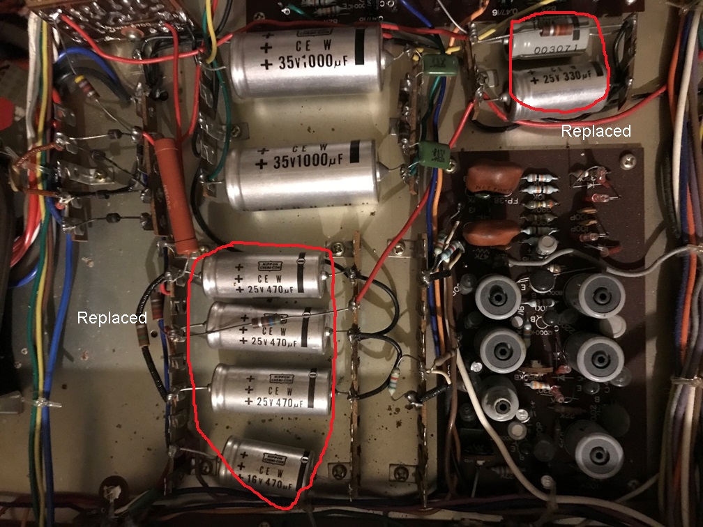

Still curious if I should replace them 1000uf/35v caps for the speaker outputs?
I works and get's plenty loud and very clean sounding so I most likely won't.

So I replace those 1000uf/35v caps with Panasonic 1000uf/35v caps and doing so introduced hum in both speakers. I did replace some of the others that are circled in the pic. I ended up putting back the original 1000uf caps and the hum disappeared. Dead quiet! Sounds very good with plenty of bass and treble. Very clear.
Were those 1000uF the actual speaker coupling caps?
If so and replacing them introduced hum then that is a sign the originals are very deteriorated indeed and not passing the low frequency content... which in turn leads to the obvious thought that the hum is probably originating from similarly deteriorated caps in the power supply.
Those almost have to be the output coupling caps. There is a very obvious zobel network connected to the negative side of each of them. The big clamp mounted cap is the power supply cap. Another potential reason for getting a “hum” all of a sudden is if something started oscillating at a super high frequency above audio. That can cause power supply hum to become audible when it otherwise isn’t. Most amplifiers actually produce a power hum when driven hard - but it’s usually masked by music that is also playing loud at the same time. When you can’t hear that “music” you will hear the hum. Hard to imaging changing the output caps causing that but I suppose anything is possible. Do those two 10 ohm carbon comp resistors near the caps (in series with these green “chicklet” caps) warm up when this is happening?
Were those 1000uF the actual speaker coupling caps? Yes
If so and replacing them introduced hum then that is a sign the originals are very deteriorated indeed and not passing the low frequency content... which in turn leads to the obvious thought that the hum is probably originating from similarly deteriorated caps in the power supply. I changed the PS caps as well...
Those almost have to be the output coupling caps. There is a very obvious zobel network connected to the negative side of each of them. The big clamp mounted cap is the power supply cap. Another potential reason for getting a “hum” all of a sudden is if something started oscillating at a super high frequency above audio. That can cause power supply hum to become audible when it otherwise isn’t. Most amplifiers actually produce a power hum when driven hard - but it’s usually masked by music that is also playing loud at the same time. When you can’t hear that “music” you will hear the hum. Hard to imaging changing the output caps causing that but I suppose anything is possible. Do those two 10 ohm carbon comp resistors near the caps (in series with these green “chicklet” caps) warm up when this is happening? They do not get warm.
I really appreciate all the info on this thing. I'm sure there is allot more work I could do to it. It would take some time to replace all those 50 year old electro's on all the other boards. I'm going to leave it as is. Not getting paid for it except parts and this thing is not fun to work on. 😀
