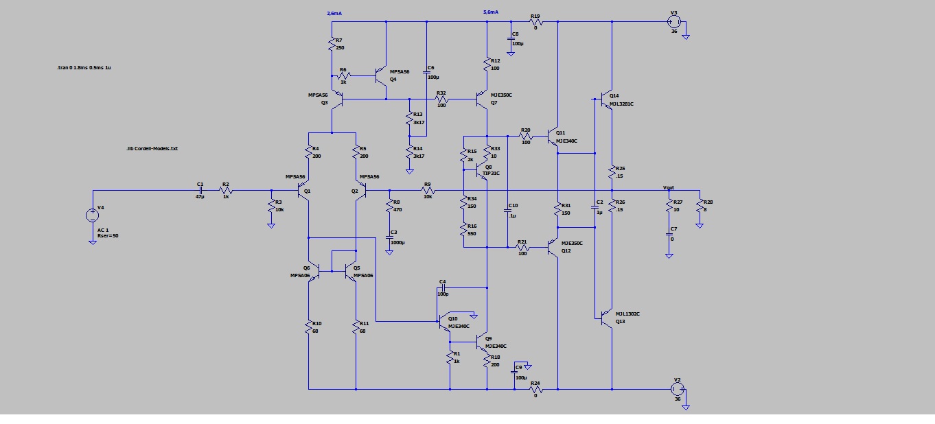

I built a blameless amp based on a PCB from Jim's audio, but have been doing some tweaking to some component values. Mostly due to VAS problems relating to CCS. The rise time was really poor from the beginning, so I wanted to improve that, and it did not seem stable at transients. Also transients were carried over to the IPS CCS as it was.

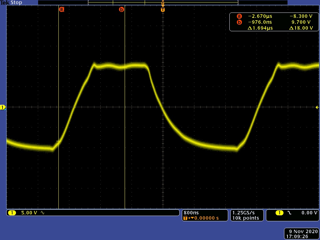

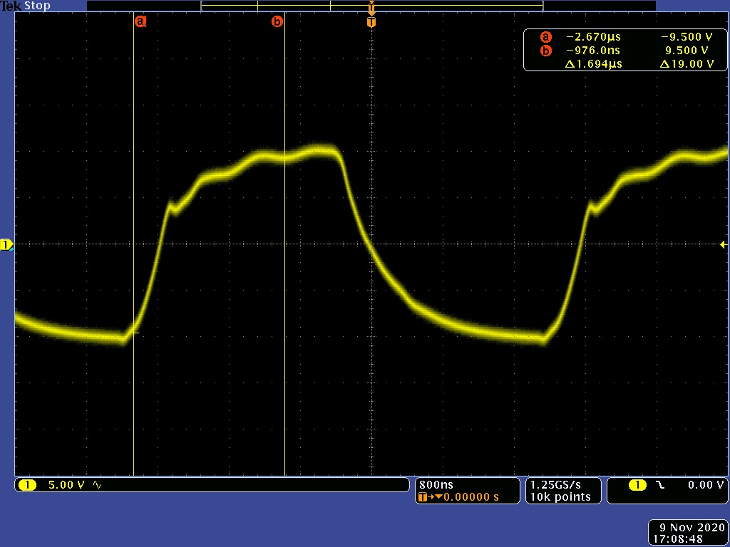

I see ringing on the current of Q7 collector, and I think this is the root of my problem.
I tried replacing the VAS CCS with a resistor in sim, and then the square wave is super clean. Real life is worse than the simulation, and I see a significant change in the waveform when touching Q7 (VAS CCS). (see scope pics)
I plan to change the compensation later, but as it is now, it's standard miller.
Hope somebody has some easy fix for my problem 🙂

The standard experiments which people perform in situations like yours, are
1. Increase R6 to 10K and test the circuit
2. Reduce R6 to original value; add a 10,000 pF (10 nF ; 0.01 uF) capacitor between base and collector of Q4 and test the circuit again
Also I recommend that you ask the simulator: "What is the DC bias current in resistor R7? Is it really 2.6mA as someone wrote on the schematic?"
I believe the connections around R33 are incorrect as well. The base of the upper driver should be connected after it, not before
The value of R32 is too small. It should be at least 1K - this prevents the VAS CCS robbing all of the bias voltage from the LTP if the amplifier is driven into clipping
MJE340/350 make rubbish drivers. Try MJE243/253
fT 10 times to short
That may be not significant if you use these in the driver stage - I have used them accordingly.
The mistake here is to use them in the Vas - a Vceo of 300 does not put an MJE340 at the top of the list of desirable attributes.
The relevant specification is the Gain Bandwidth product of the circuit and for this device fT is important. The latter information on this is absent in the datasheet but some sources put that at 10MHz - not enough starting capital.
There are better suited small signal transistors for use as Q10, and Q9 which will allow higher aim points.
As rough approximation re 10MHz, this has be divided by 20 for the closed loop gain and multiplied by 0.707 to allow at the -3dB frequency point where-ever that lies.
In a race to the bottom line of unity, phase will always get to -180 degrees first without any compensation.
Phase shift is more rapid than decline in gain and starts to change a decade in frequency in advance of the frequency point where gain is down to 70%.

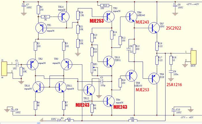

Thank you for all the replies!
Self wrote about improving slew rate in his book, and mentions capacitance between base and emitter of Q7 as a problem, so I simulated this before and found decreasing R13,R14,R32 improved things a bit.
As you see in the attached original schematic, the 340/350 were replaced as suggested, but since that is what I could get locally, I went with them. I have a few 649/669 that I could try if you think those are better? However, I have not seen any real stability improvements in simulations when trying other transistors. I guess changing these would allow better OLBW, but for now I would only like to get better stability in the VAS.
I did as Mark suggested in the simulation, but did not see much improvement, and I can't do it on the amp right now since I don't have the capacitors.
I am a bit reluctant to add caps too (to rail or ground), since I don't know how it will affect PSRR. The PCB has no RC filtering on the rails for the small signal part of the amp either, making things worse I would guess.

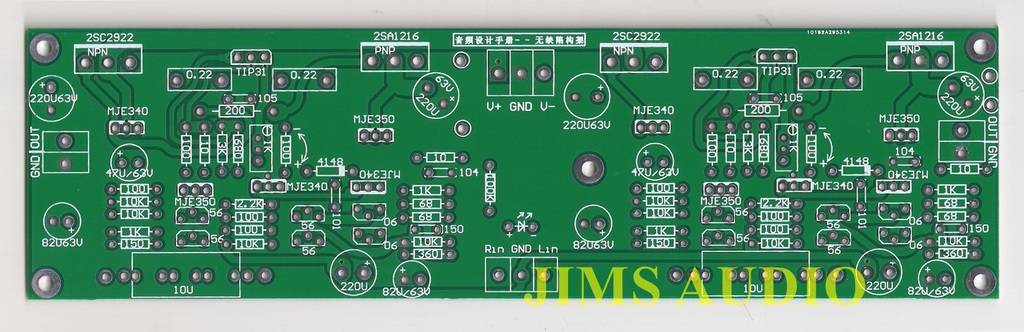

EDIT: as seen, the actual PCB markings does not really correspond to the schematic either.

I replaced Q7 with a 2SB649, and it improved it a bit. I would say it's almost acceptable now.

Ok, distortion problem solved. It turned out that running one channel with load while measuring the other without load caused a problem. Some kind of crosstalk on the PCB. I added resistors to RC-filter the supplies to IPS and VAS, and the distortion in now looking quite nice with 2nd harmonic at abt -90dB, and not much variation depending on load.
