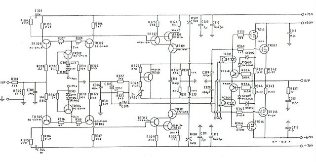

For comparison it may be useful to have a look at the schematic of Bowers
and Wilkins MPA-1 power amp, see picture attached.
This circuit is close enough to most what has been done to mistreat innocent
semiconductors in the Eighties and may be straightly applicable here.
