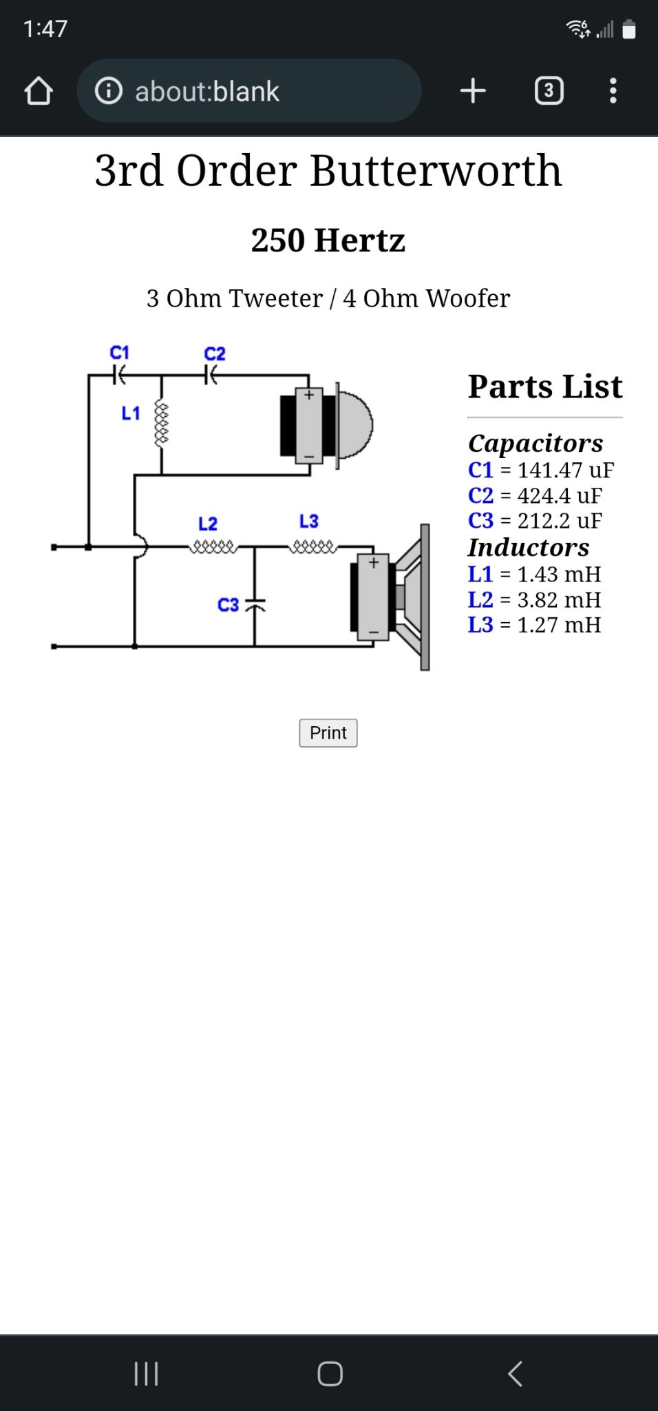

Bfb1963, do you plan using one sub under the table? Or two small woofers on the desk under the planars flanking the monitor?

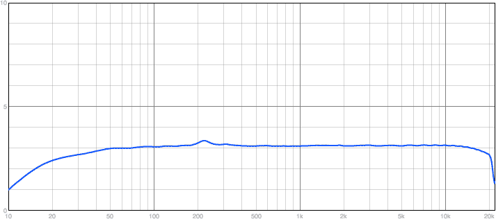

Thanks for the impedance curve. I measured it at 3 Ohms at static, and assumed it would 4 Ohm driven.
I will be going with two small woofers under the planars and flanking the monitor. No subwoofer. The Monsoons have holes on their bottoms for the metal peg legs that I can use for dowels to connect it to the woofer module.

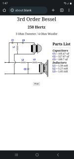

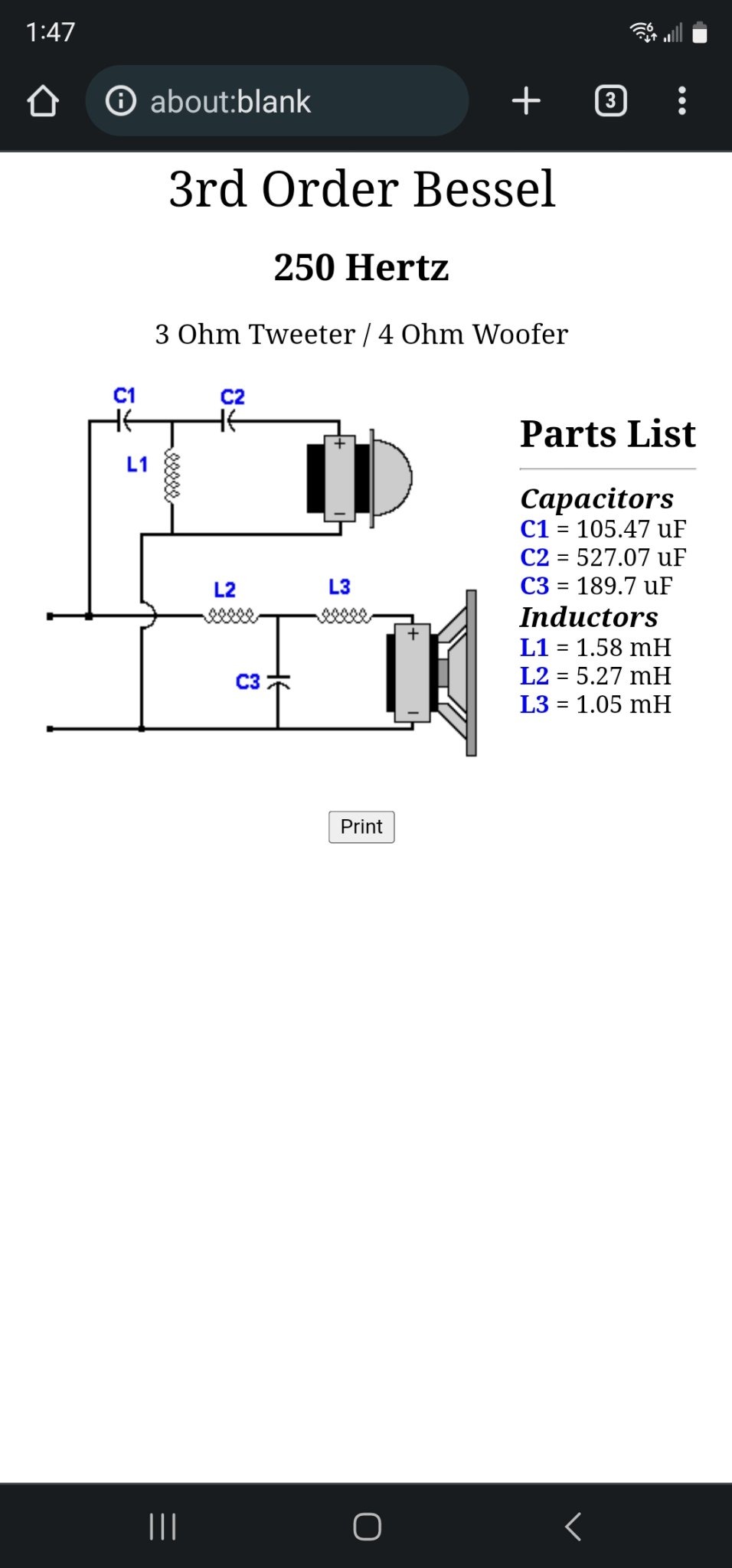

I originally was going with a 3rd order at 300Hz, because that is what the guy I bought them recommended. But if they were meant to be 250Hz, then I will go with the Bessel 3rd order at 250Hz you posted. I wont consider the Butterworth because one of the inductors needed is on backorder from PE.
I've never built a crossover from scratch before. Some of the inductor specifications are off a little. Is that OK? I do not want to do any unwinding since I can't measure inductance. And I understand that capacitors can be configured in parallel to meet specification.
L1 specified 1.58, available is 1.5
L2 specified 5.27, available is 5.0

Well, if you are using two small woofers on the table, you can cross higher. Its totally up to you. If you cross higher, you can have lower order slopes, even just one cap for monsoons, utilizing more from woofers.
The whole point of steep crossover at lower frequencies was for sub not to be localized too much (which should still be much lower that 250/300, at least 150).
If you run two woofers higher, you save a lot on crossover. First, select what woofers are you going to use, then decide on crossover.
You can put inductors in series to obtain desired value, btw.

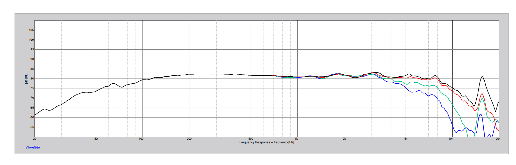

This is the data for the raw driver, not the enclosure. The enclosure includes a single driver and two passive radiators.Post measurements of the woofers. On axis and off axis.

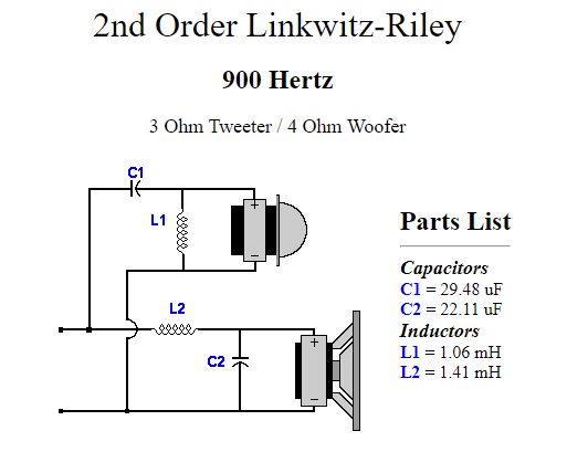

That looks very good. You can cross it anywhere below 2-3kHz. But i would avoid crossing in this part of spectrum, as ear is most sensitive.
My suggestion would be to cross at 900Hz. I would use 2nd order for midbass, and just a cap for monsoon.
This is the crossover result, but I do not understand how to design it with your suggestion of "just a cap for monsoon."

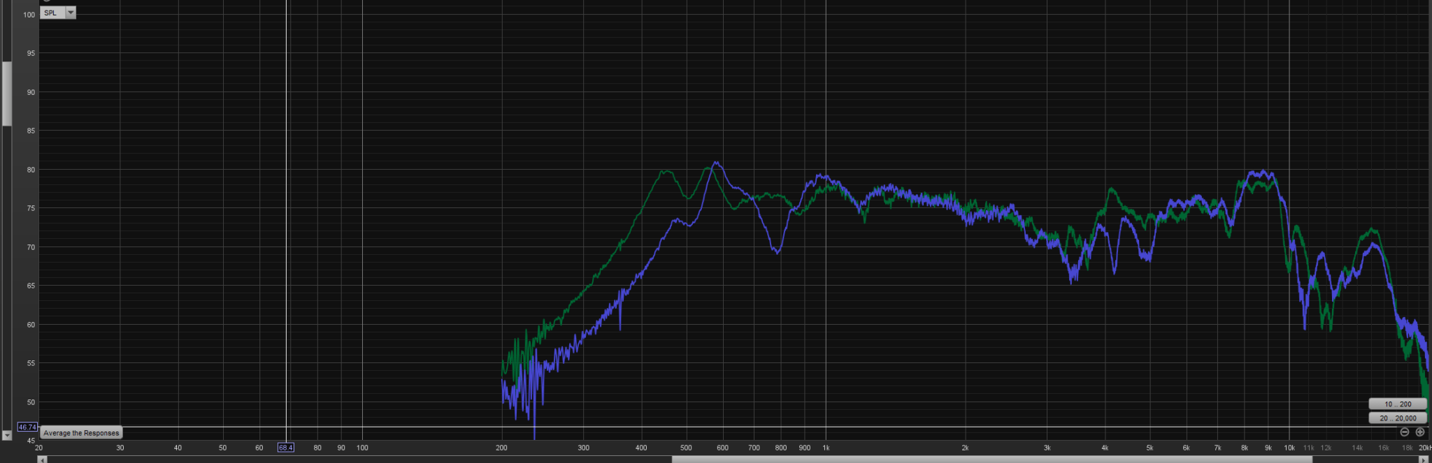

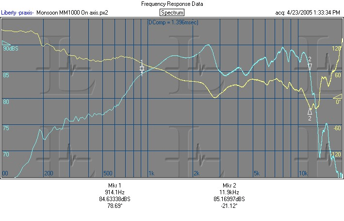

I checked the frequency response of the Monsoons from 200-20K. Looks like one or both are defective.
Looks like they would be happier at 500 Hz highpass.

Do they have a built in passive components?
Impedance curve on planers always impressively flat
so hard to tell what resonance is.
Looking at post #22 maybe about 230 / 240 Hz
basically double that to 500 Hz
or looking at measurements if their is passive
components in there, looks like blue channel has
drifted or anomaly/ reflection from measurements

No sense redesigning anything with planars that are that mismatched. They would need a lot of active DSP to even try.
Unless a speaker is measured in exactly the same way, it's hard to get the same results as someone else in a home environment. Or get identical results twice.
Are you proficient with in-room quasi-anechoic measurements? And the series of questions that go along with that:
What distance was the microphone from the speaker?
What windowing/gating was used? Was that sufficient to eliminate room reflections from the measurements? You seem to have a lot of resolution in your measurements, which makes me wonder.
Were the two units measured in exactly the same location with exactly the same microphone location?
The overall character of your measurements look similar to those shown at Liberty Instruments for a similar Monsoon product, other than the low end (which may be a result of your measurement method - it's hard to tell from here 🙂)
http://www.libinst.com/what_makes_a_speaker_sound_good.htm
