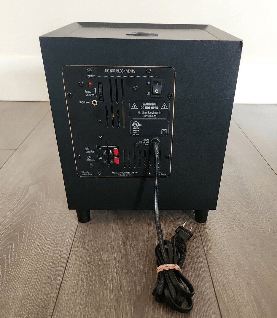

Just bought a pair off Ebay for desktop use, but did not realize I need to fill all the way up to 300Hz. Any help appreciated designing a single driver solution for 300Hz and under. Trying to keep cost low on the driver. Thx!

Those are all the right questions. I am using a Loxjie A30, USB DAC amp, 40w x2 @8ohms, with a single subwoofer out. The single sub out has no crossover setting, is mono, and may even be full range. Now that I have thought about it, I am concerned I might be missing out on localization/directionality of the 100-300Hz region.
So, I think a stereo 2-way configuration with a yet to be determined crossover point is my goal, all powered by the Loxjie. I do want a smaller footprint, internal box dimensions around 0.125cuft (6” x 6” x 6”)

Ported or with a passive radiator, but the footprint must be small, .125 cuft
Price? Like to stay at $100 incl. crossover, $80 tops for drivers.
Thx!
Yeah, I saw those. In fact, I think the Passive Aggressive Mini Speaker Kit at Parts Express has a design I will go with. It is the ND91-4 paired with two ND90-PR passive radiators, recommended enclosure volume of 0.045 cuft. It goes over my cost limit (like that ever holds true), but it is a small footprint. I'll just delete the tweeter.
I will measure the Monsoon MM-700D when I get home tomorrow. Then will need help with crossover design that might need an attenuation circuit.
Ok, they are 2.9 Ohm static, so must be 4ohm drivers, same as my planned bass modules. I have no idea what would be the best crossover point or type of crossover. I read somewhere that electrostatics like steep crossover points. And, which driver will need to be attenuated, the bass module or the Monsoons? I will build the crossover pair as a separate box, so it would be accessible.

No plans to put anything under my desk. Since I am going to go with the small form factor bass modules (.045cuft), I will just place them next to the Monsoons on my desktop (I have a big desk). A true 2-way setup. Also, this lets me just use the Loxjie A30 for power and does not necessitate an extra amp for a larger single sub.
What is likely to be attenuated is going to be influenced by what frequency range you want to go to the planar. The lower it plays, the more response shaping you'll need on it (to make up for the dipole cancellation mentioned earlier), which is going to cost sensitivity. In that scenario you may need to attenuate the woofer.
If you cross higher, you may get a better sensitivity match between the woofer and planar. Or you might even need to attenuate the planar, assuming the frequency response plots here are at 2.83 V and 1 meter.

The Monsoons are planar magnetics, which often have more excursion and output per unit area than an electrostatic panel. Like most mid/high frequency speakers, if you cross them higher you can normally get away with a more shallow crossover.

That thread helped, and I see that Adason (wish I knew how to tag him on this forum) thought they should crossover at 500Hz, but he was building a 4-way. I found some specs for the MM-700 and it turns out they were given 11 watts each with an active 3rd order crossover at 250Hz.
