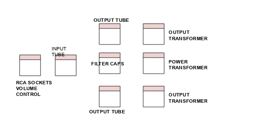

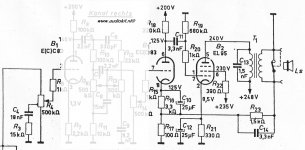

Hi I have all the parts to make a philips ag9016 but struggle to turn the schematic into a layout like the one in pic. The blanked area on schematic the tone as I want to build it without.
Can anyone please help me thanks.

You don't really need a tag board, just three terminals/channel, plus ground returns.
Mostly wire it point to point, using the leads of parts instead of wires where possible.
Keep the input tube/wiring away from the output tube/wiring. Do you want two channels?
Set the parts around the tube sockets and adjust their positions for the simplest routing.
Don't like that short circuit switch across the secondary though, WTF is that about?
....Don't like that short circuit switch across the secondary though, WTF is that about?
It is perfectly safe to short the output of a self-biased SE tube amp. How is it going to hurt?
It is NOT safe to leave the output open and hit the amp with large signals. Flyback will puncture the OT insulation.
If you look close at 5F1, its speaker jack shorts when speaker plug is removed.
