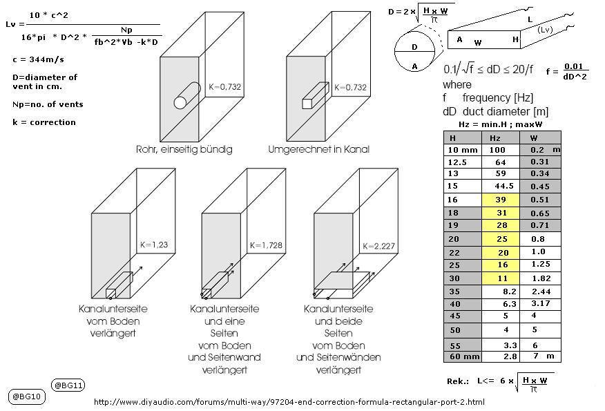

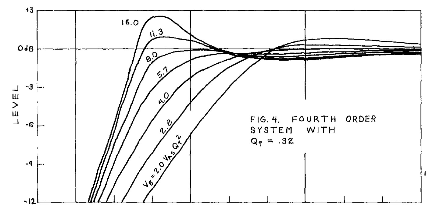

The Onken calculator spreadsheet is based on the Snyder's "Simple formulas and graphs for design of vented loudspeaker systems" 1977 article (please find attached).Secondly, what is the impact of changes to the "n=" / "Onken alignment" parameter on the final result? I'm assuming the 6.34 was what the original bass cabinets 60+ years ago (presumably designed by trial and error) ended up having once more modern simulation/calculation methods were applied to the old designs, and the 5.7 is a better compromise that has since been identified mathematically, but I'm not sure what it is compromising on or what changes up or down from this 'ideal' value are likely to do.
There you can find some graphs for different Qts and different "n" which might be interesting to you.
Unfortunately though, this spreadsheet is just an attempt to reverse engineer the Onken design and has little to do with original Koizumi's approach.
Yes, you should use "corrected" length for the build. The correction is needed because real port is not just some theoretical "pipe", but is "half-flush" on the front and has walls adjacent to it on the rear, so it "appears" longer that it actually is.Firstly, why there are separate fields for "effective vent length" and "corrected effective vent length" and what is being corrected for? I'm assuming the corrected one is what I should be aiming to use in the final design, but wanted to make sure I'm using the right one, as in the tests I've done it is usually 10-20% different to the 'effective' one.

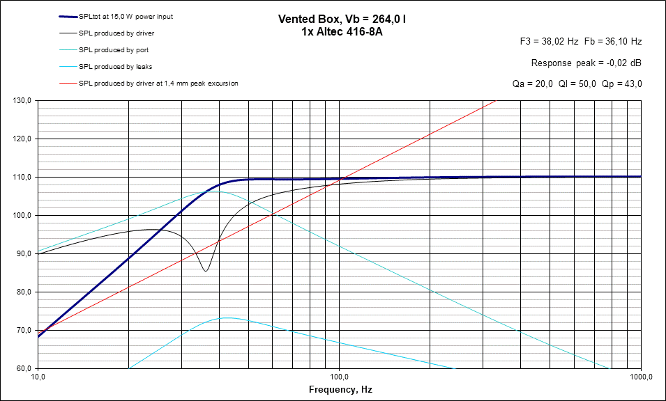

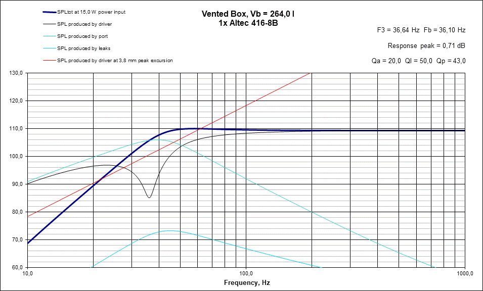

The Onken, despite numerous esoteric claims, is just a bass reflex design. Slightly unconventional in terms of construction and port area, but still. Of course, we should give credits to Eijiro Koizumi, who developed the system long before Thiele-Small theory was a thing.As mentioned in my reply to waxx, I'm probably not clever enough to do my own simulation at this stage, which is why I was hoping for an easy way to come up with a reasonable approximation. Thus, unfortunate to hear that the spreadsheet is an attempt at reverse-engineering. Do you know if it gets reasonably close to useful parameters despite this (particularly since we've now established I'm doing something in the Fonken/MiniOnken aperiodic style, not the original Onken design this is presumably working towards), and is there anything better / newer (given it is now 25 years old) that I could use instead that would do what I need without learning how to simulate an apparently complex enclosure myself?
Below is my quick Unibox sim of the Hiraga's 1977 published Onken design (with Altec 416-8B, can't find the TS parameters for the 416-8A):
And then the screenshot of the Snyder's article mentioned before:
Given all that, you can use any enclosure calculator software you want.

The "effective port length" is the length of the theoretical tube with zero thickness walls sticking "far enough" of the both sides of the panel. In practical design there's always something near the port end (or ends) and that something affects the port behavior. Thats why the thing called "port end correction" exists (just about any software is able to take these effects into account).

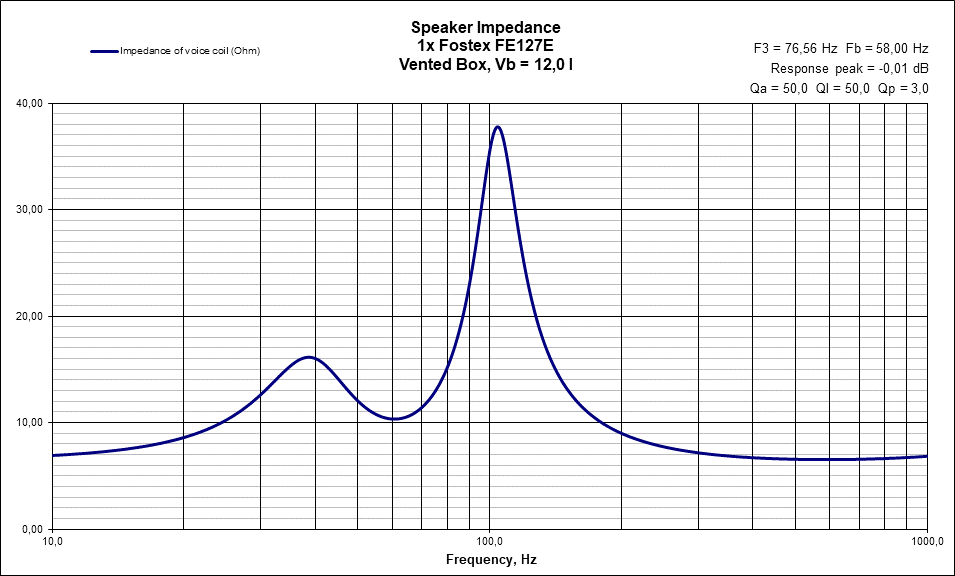

What you have to adjust to simulate very lossy ports is Qp parameter (port quality factor).
The default Qp value in most enclosure simulators is 50-100, and you have to lower it to 5 and below.
Here's the impedance plot for Dave's Fostex FE127E Fonken speaker with dampened lower peak:
And here's my quick sim with Qp set to 3:

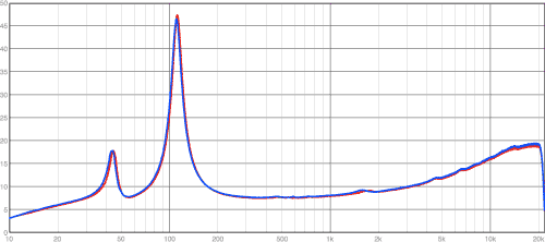

This is true -unfortunately, the Qp factor, being a lumped value, does not provide any hard data on how best to accurately determine & provide the target level of frictional losses / resistance in the vent structure. So while you can certainly get a reasonable approximation of them in lumped element simulations, ideally you need a variety of concrete examples with measurements [acoustic / electrical & physical] to analyse & then establish the necessary dimensions to hit whatever your target alignment happens to be.
