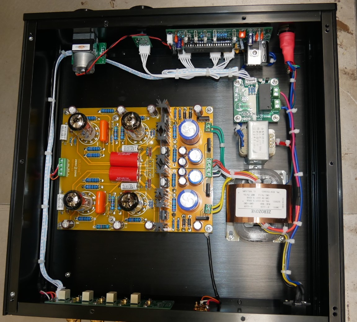

A little help please...I just bought a Chinese, Zero Zone preamplifier that purports to be a Conrad Johnson clone. It has four JJ ECC83S tubes currently. It sounds great! But if I wanted to roll some new/different tubes, what would you recommend? Do I gain anything in a preamplifier design with matched tubes? Sorry, I cant find a schematic anywhere on it's design topography.......Only this quote in the literature..." This preamp is reference the famous conrad-johnson CL Circuit , designed with double-single independent design, physically separated 100% left and right channels, independent hierarchical grounding." Thanks

Very Chinesium and I wouldn't believe a word of it.
An ECC83 is a 12AX7. Knowing this type of pre amp I wouldn't think there will be any gain to trying different valves apart from some may have a quieter noise floor.
If you still want to spend money on valves, 12AY7 is different, sound wise, because it has different characteristics, as all of them do.
Ensure the heaters are wired the same way as the ECC83.

I would have turned these around, keeping the board and the input/outputs flush to the backside. Sliding
the board to one side the power cables can be routed to the power switch and transformer mounted at front.
The power cables could be screened to prevent noise leaking to the board. But the main point is
to keep signals as short as possible.

Back to the OP's question: As J/J ECC83S feature frame grids, hence represent the most recent step in tube development, I don't think theres any good reason for replacing it by others. Remember Telefunken's overly hyped and eye watering expensive ECC803S are of the very same technology.

"The JJ ECC83S uses the anode construction pattern of the frame grid designed Telefunken ECC803S. Though it is not a frame grid valve this design has many advantages when used in guitar amplifiers. The solid internal rigid structure which is internally braced makes this valve very low in microphonics".
1. The JJ ECC83S tubes have Spiral Filaments. A good thing for any AC powered small signal tube filaments.
Does your preamp have AC power, or DC power; but remember for all preamps that do have AC filaments Spiral filaments are best.
2. Eurotubes.com re-tests all the ECC83S tubes that they get from JJ in Slovakia.
Very importantly, that includes a test for Microphonics, Hum, and Noise.
3. Eurotubes also sells the ECC803S, it is the Long Plate version of the ECC83S.
They have Spiral Filaments too.
They also are re-tested the same way, after they come from JJ in Slovakia.
Your preference, or get both and try for yourself.
