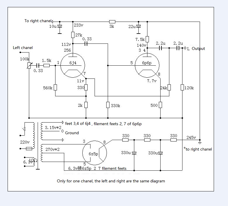

I just purchased a Chinese preamp from aliexpress, can someone tell me the tube equivalent I can upgrade too. Here's the product name
JBH 6j4 ( EF94 ) 6p6p ( 6v6 ) Tube Pre-amplifier HIFI EXQUIS best sound high density bass preamp finished product
this is the schematic. can you guys help me with some optimum choices

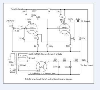

Hi.
I have the same chinese pre-amp and to be honest it works pretty well for the price.
I would like to ask the experts here if it is possible to add an output for headphones which are 30 ohm.
Thank you 🙂
Found another thread here, looks like the same preamp...
6j4+6p6 hifi preamplifier kit!
Anyway, based on the schematics 2 post up, can someone help me identify the feedback resistor? I only see a single 24k...assume that is the one? Current gain level means my volume knob at 7 o'clock is pretty loud. 9 o'clock will make ears bleed.
Could anyone help with advice on what would be the ideal feedback resistor value so i get the most volume fine tuning without messing up the sound?
