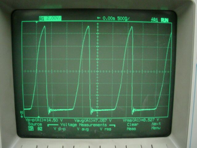

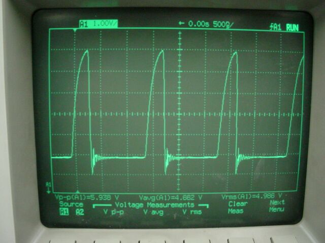

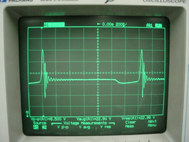

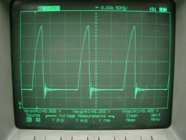

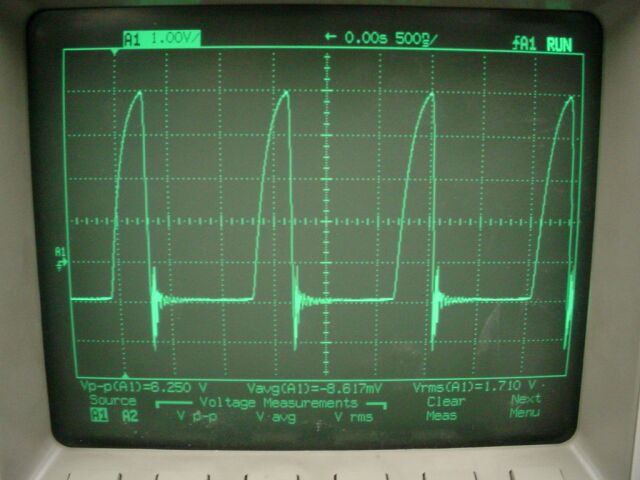

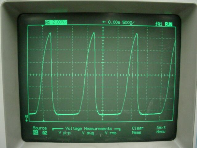

Here are some pics of measurements taken with a scope.
I tried moving Q1 and it had no effect, I also replaced Q1, Q2 and Q3 with new ones and i still got the same results. I have also replaced as many of the passive components as i could and still it had no effect. I then rebuilt the entire circuit on a fresh piece of board and i still get the same results.
Whats going on???
This is the output.
Whats going on???
This is the output.

Mmmmmm ....
Kram,
I wish I could be more help, but, in case it's useful :
Some comments
[1] Is there an input signal applied, if so what is it ?
[2] What is the output load ?
[3] What is the sweep speed (timebase, secs / div)
[4] Q3 appears to be doing its job from c-b-e measurements !
(wierd signals though)
[5] Q1D looks strange - thats a 12V swing on the +24 rail ?
(can't see the voltage measurements - guessing swing between 12V-24V)
(this can't be right !)
[6] Q1S is showing some nasty ringing - also it should be centered around
12V but it is showing Vavg 23V
(have you mislabeled QID & Q1S measurements ?)
