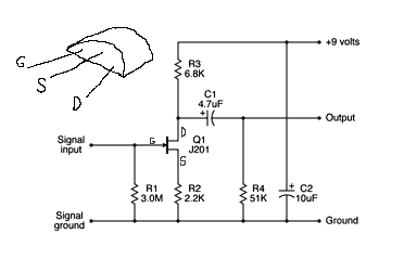

Hi folks. I'm hoping someone can point me in the right direction with this preamp project I'm working on. I've been trying to build a JD Tillman-designed piezo preamp using a single J201 JFET. I've assembled it about 3 times now and cannot get it to work - no signal at all at outputs!
The circuit is here.
I'm wondering if I've perhaps got the pins on the JFET wrong? From the schematic, it would seem that the Drain and Source pins should be interchangeable, but I don't know for sure.
On a related note, I've tried Tillman's JFET Preamp Cable design as well. My build seems to work intermittently, with periods of horrid static/noise invading the audio. Anyone experienced the same sisue and perhaps know what the problem is?

How did you connect it? You did notice that the electrolytic goes from +9 to ground, and is NOT connected to the output? Can you post the voltages on all three of the FET pins?
Hi Jarno. I'm using a patch of Fairchild J201's bought off ebay. The seller provided the datasheet, so I know the pinouts on the JFETs are (L-R) D-S-G. I'm hoping someone can confirm the pin positions in the circuit schematic.
Currently I've wired the F201 as follows:
Pin 1 - to R3 and 9v+
Pin 2 - to R2
Pin 3 - + signal input
Is this correct? I'm guessing not, as I can't get a signal......

drain voltage should be around 5v.....6v (from drain to ground).
......if it is not change r2 (source res) so that you get this voltages.... (try out other values for r2).

Thanks, mjf! At least I know I'm not wrong on the pinouts. I will dig out the old Voltmeter and see if I can get a decent reading. Then I guess I'm back to searching the perfboard layout and my possibly dubious soldering techniques. 😕

Ive built this circuit before , Ive noticed that some fets just plain don"t work well , I had to try a few j201 before I could get one that would bias properly with the posted resistor Values ..... also realize that this preamp doesn"t do much preamping , it only has 3db of gain ......
