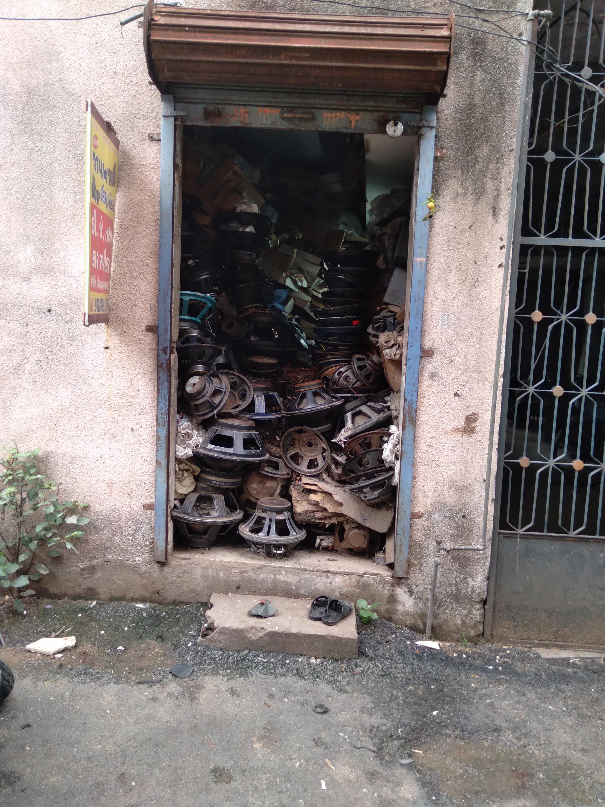

As of edge treatement/doping, a Pro repair guy will use the proper stuff , which is a water base Latex emulsion (same as "acrylic" roof tile sealant, but 10X as concentrated), white when liquid, bluish as it dries, transparent when fully dry, paper looks blacker than before by comparison.
And it never really dries, being Latex based is always fkexible (good) and tacky (annoying).
Some fake it by using diluted vinyl carpenter´s glue or solvent based adhesives (contact cement) which is wrong.
PS: surprised he reused the voice coils, since at least one was presumbly damaged.
And even if possible, those paper and nitro adhesive vintage coils sound good but stand "nothing", think 12-15W tops.
Maybe he used vintage style coils, which to boot raises power handling.
Paper cones used to be made in Jaipur, Rajasthan State, seen repair men using those.
But getting and transporting a few cones...hassle.
Here the old coils are not reused, they put new coils, and the repair sounds good if done properly, which is really based on the hand skill of the person doing it.

I also thought the same thing, I mean out in here somewhere nowhere. Lol 🙂, I felt lucky to get them repaired like this.
Speakers are routinely re built here, no big deal for us.
Quality can be erratic, found a good shop here with same day service.
6" full range re coning, new coil, 100 Rupees, about US $1.35.
