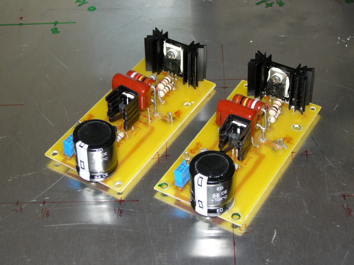

Let's calculate. 250V on Zeners, 200V on 15K resistor. Current is 200/15k. Power dissipated on Zeners = 250 * 200/15 in miliwatts, that means about 3 Watt on all 3 Zeners. But total current is 13 mA. If your tubes draw 13 mA that means Zeners will not work.
I usually start from requirements, how much current should supply your power supply, then decide how to stabilize the voltage.
If say when tubes are cold all current flows through Zeners, it must not be higher that causes 5W dissipation on 100V Zener. That means no more than 50 mA. So, according to current consumption of yout tubes you may now calculate value of resistor, instead of 15K.
Oh..yes, you're right. Since there is 13mA channel and 150v/0.013= 11.5k. 11.5k of 0.013 = 1.94w. What if I could get some 200v zener, could it be better ?? But still I'm going to source and or design a simple regulator amount those 3 legs that I have and they're TIP50, MJE350 & IRF840. I'm aiming at something 30-40mA channel.

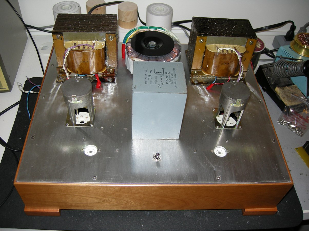

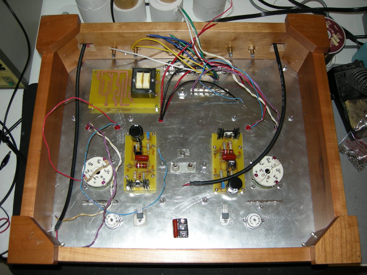

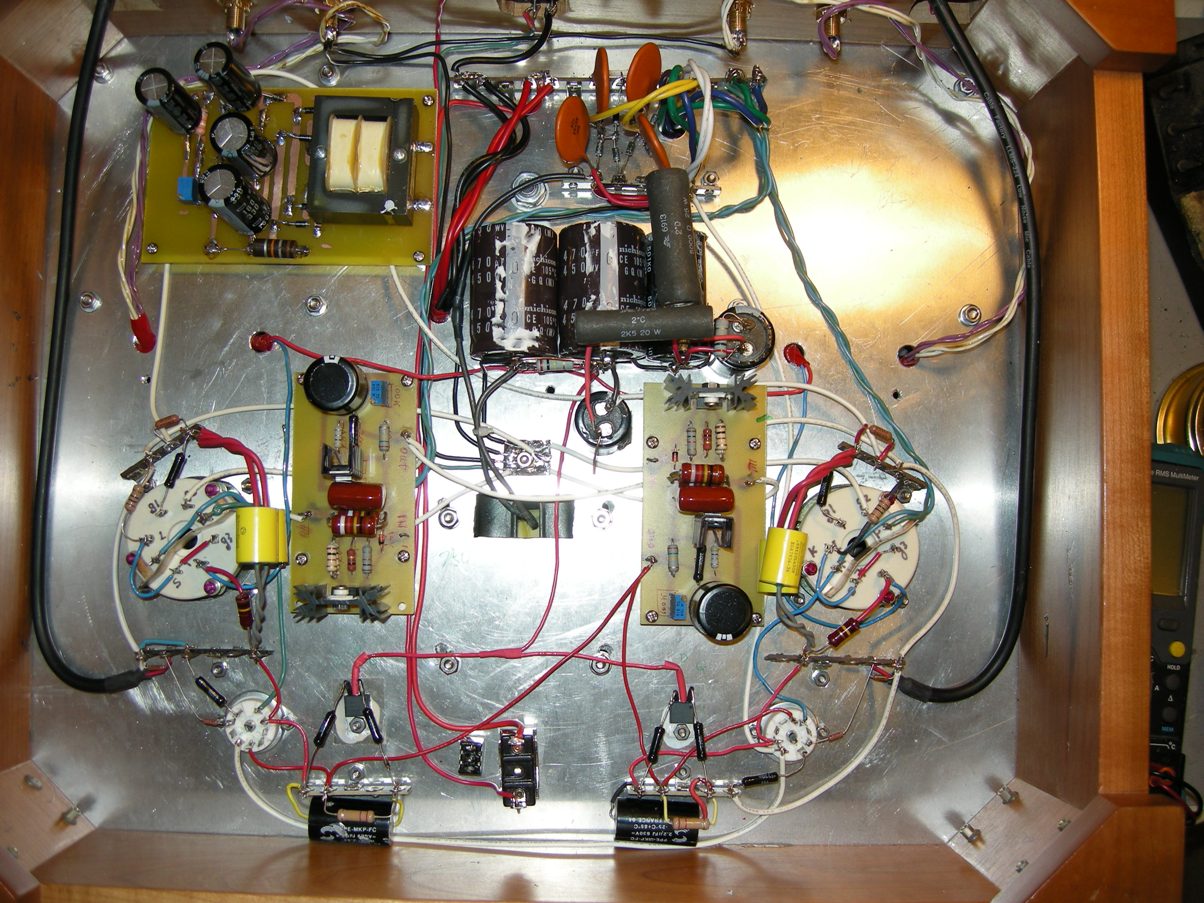

It's almost time to put everything together. Please comment if I could do better on lay-out and wiring.
I still have one question since the choke is only good for 230mA, but the tranny is good for 500mA. I'm thinking if I could re-route - RC after the rectifier - to make another supply for the 200v/& 250v supply ??

It seems taking too long for me to finish populating all the parts. I did have the filaments and HV checked. I didn't have gut to test it with tubes on, even after checking the schematic for couple times. Is there any way I could safely checking both channels step by step.

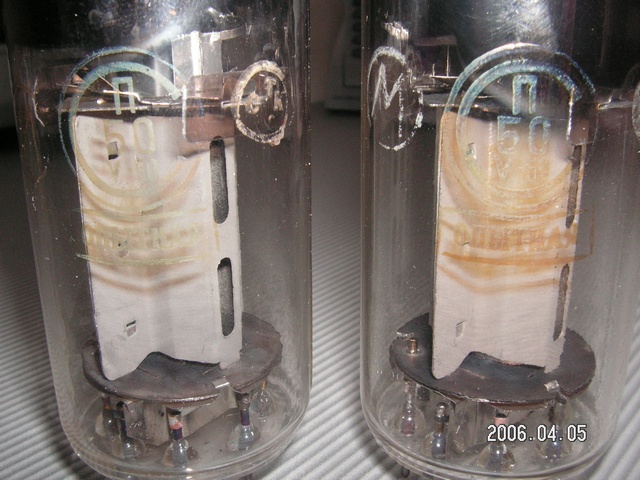

Look what I found in the Net. It reads, "P50 Experimental".
Later was renamed to Gu-50 when they started production.
Well, due to the fact that this tube was produced in the formerly GDR as P-50, this leads me to the assumption that it had found it's way to Russia via Eastern Germany. Am I right?
Best regards!
Best regards!
Yes, and they had to pay a lot of License fees for the right to "copy the russian transmitting tube"...
at the former Telefunken Tube Factory in East Berlin where the LS50 was made - also known as "WF".
regards
Edit: this tube ist the SRS552M and SRS552N
