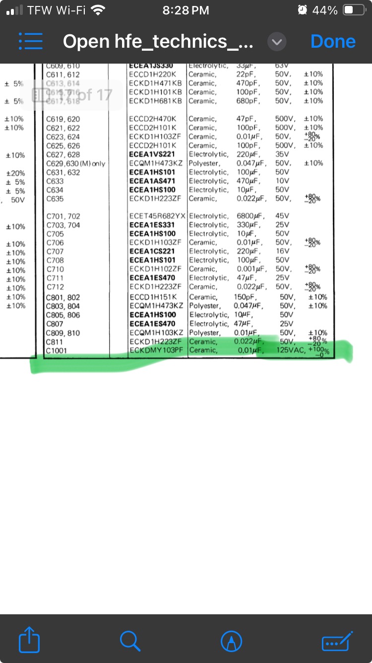

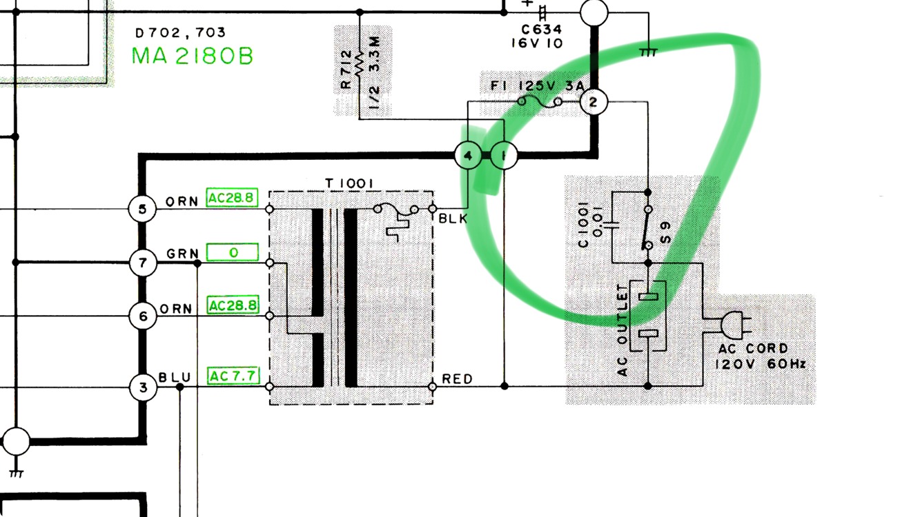

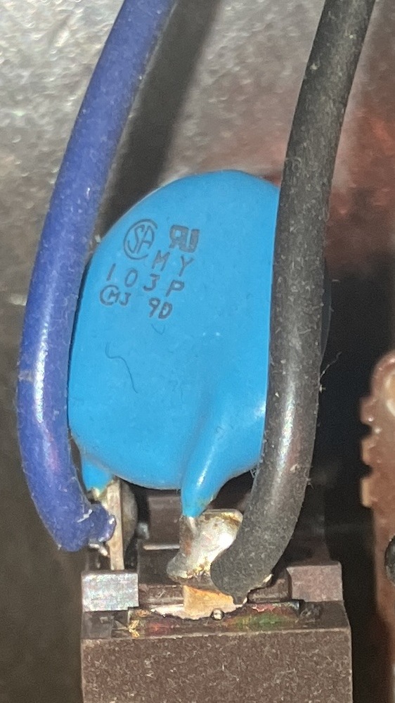

Hi folks,
I recently purchased this receiver for parts (no audio output) at a local pc recycle store. Luckily cleaning out the switches brought the amp back to working order, except for a rather loud thump when I turn on the receiver. Would replacing the factory ceramic capacitor (C1001) with a polypropylene film snubber capacitor reduce the thump? Or is the thump more common on amps of this vintage? Photos of the factory capacitor, and schematic attached. The service manual is too large to upload here. It can be found on hifiengine. I’ve attached screenshots pertaining to C1001 from the service manual and schematic. Thanks.

I’m not familiar with this amp, but my guess is that it’s the “nature of the beast”. Some amps have output relays to delay connecting the speakers until PA bias has settled. You could add such an accessory. If you’re not using remote speakers, you could use the REMOTE selection position for a few seconds during power on, then move selector switch to MAIN.
