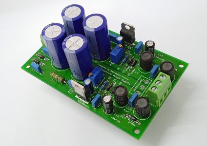

Replaced with 40US cents fake NE5532. touched the input with fingers. There was humming buzz on both channels, so connected TT<>Phonopreamplifier<>Computer Speakers. Lots of hissing noise. Replaced 33uf C3 capacitor as it measured 15uf on multimeter. No change. My power supply is from CNC Phono stage with DC output set at 15-0-15v. 0V wire connected to pin number 7 of phono board. So I guess that is ok./?
However when I switch off the power supply at the end the music sound comes loud and clean(as if everything is fine). Hear attached file at lower mid volume. What coud be the cause ? Any parts to replace ?
my power supply
my power supply

Looks like the board has many parts missing, i see not a single resistor there. Probably you should rebuild the circuit following the schema.
Then you should check every component or replace everything (it'll cost nothing except your time) because your power supply looks good to me.
