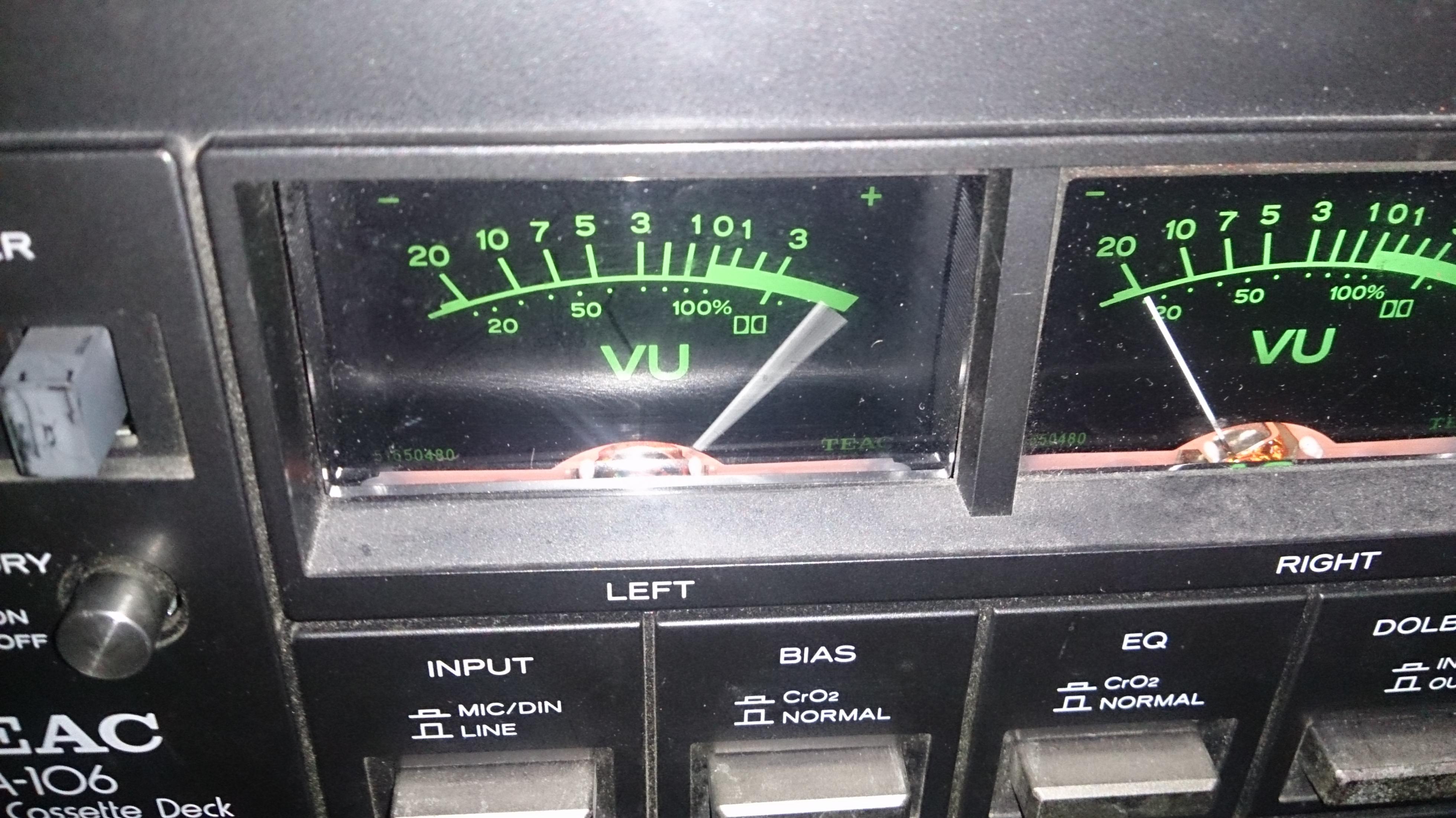

But yesterday when I powered it up, both channel meters (needles) were bouncing at the very end rapidly (absolute peak).

Interesting would be to hear what it is actually outputting, since You have pegged VU's.
Is there a headphone output ?

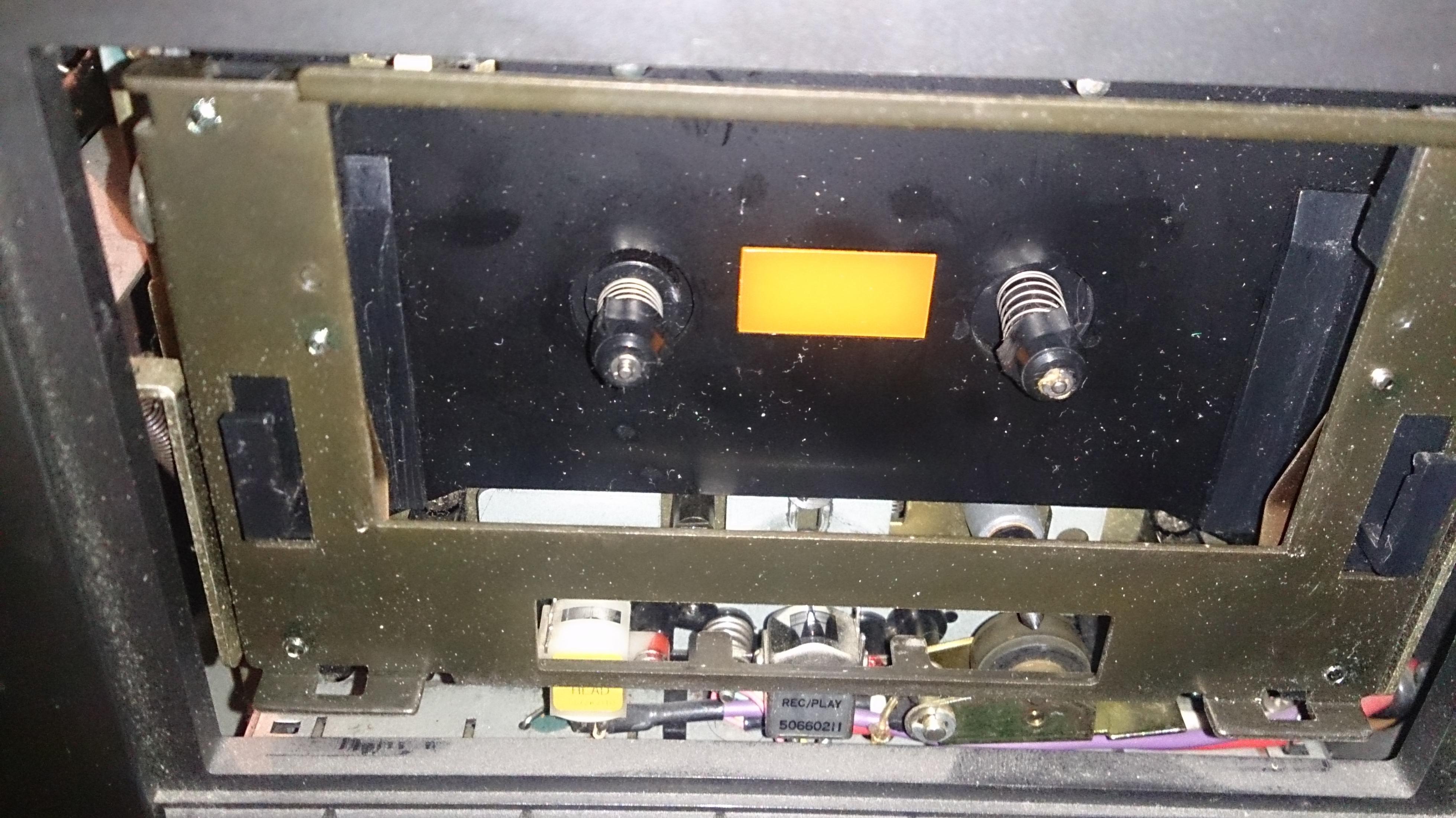

Immediately I noticed really bad and slow movement of the tape (the music was coming several pitches down and detuned) and no way of going the tape forward or backwards. So I guess the problem now is around the base pullies and their controls and the next step is either cleaning them or replacing belts or other parts etc.
Any new ideas or advice please?

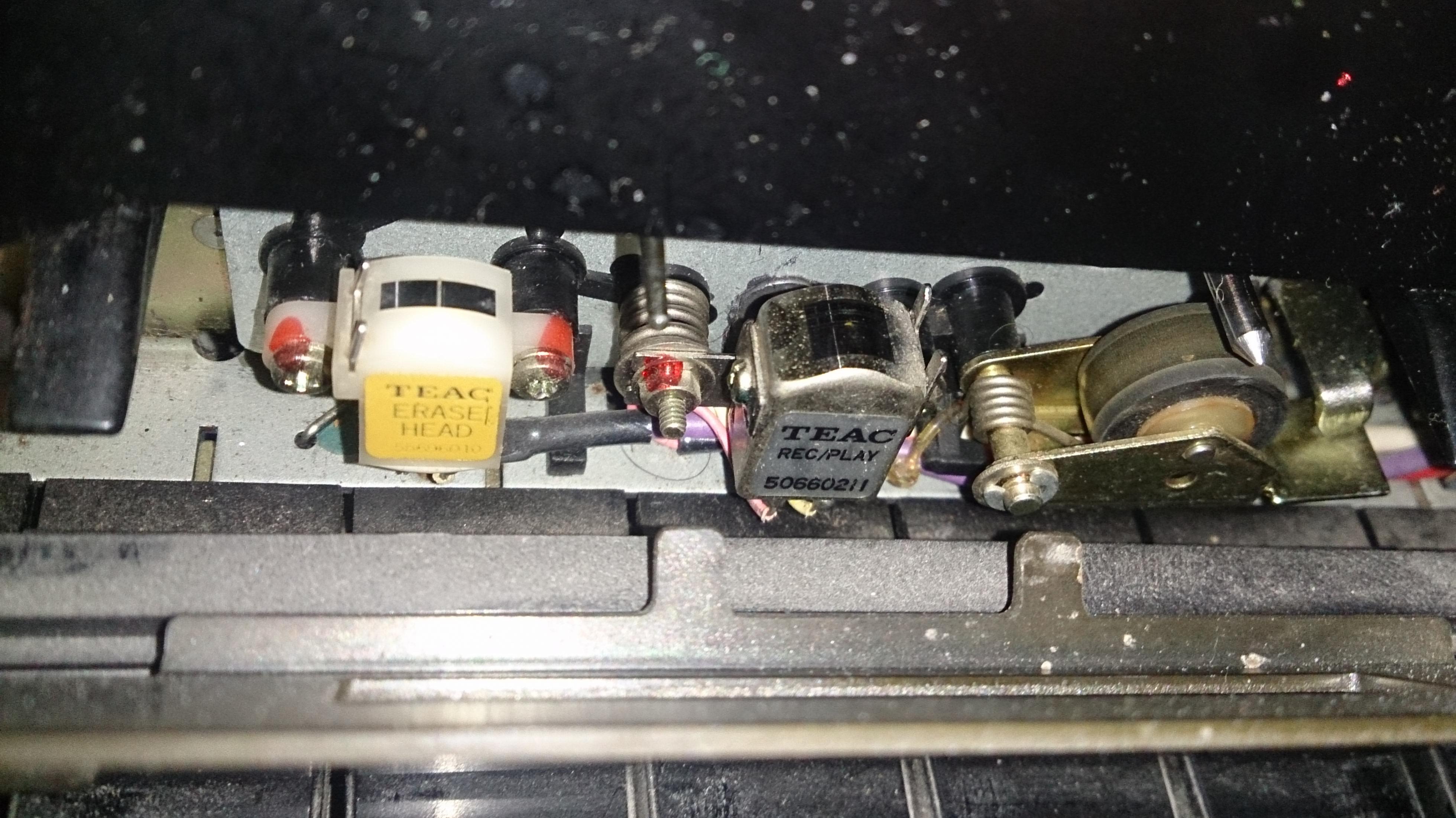

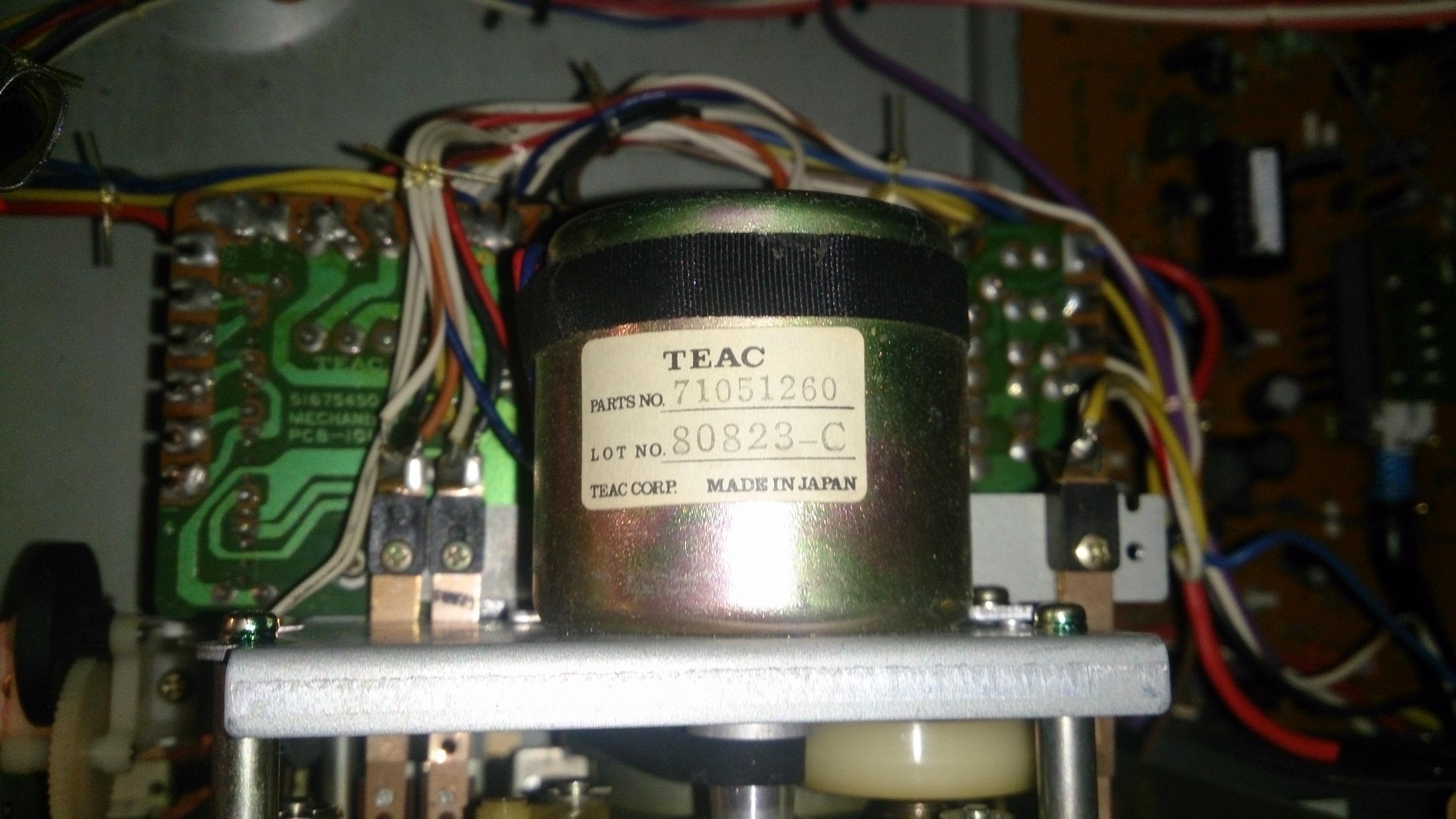

News. Quite bad news. While cleaning the capstan and the roller, there was a small explosion and smoke coming from the mechanism small board. I guess a capacitor exploded. Even if it powers up and seem working.
So now it's time to change all the electrolytics (I will replace the large power filter ones). And the hard part is disassemble the thing in order to reach the pcbs.
I attach some pictures of the mechanism and the level meter pinching. Now it peaks only on the left channel.
What do you think?
