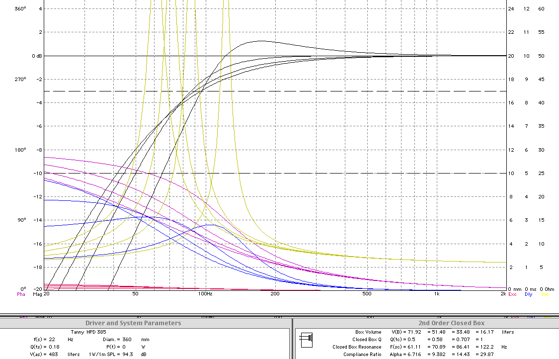

Sim suggests ~30 litre damped box will give you a 2-pole butterworth HP at 85 Hz. Adding helper woofers is gonna give you the best mids.
dave
So, I picked up a set of the hpd-385's .......Are we talking 300L+? what about if I wanted to go sealed? (which I tend to prefer)
Well, the pioneers concluded that Vas/1.44 was the optimal compliance balance and due to driving them with a high output impedance, tuning was always to Fs, so ~335-340 L based on a couple of different specs and guessing the 300 L cab spec is an average of the various models available at the time.
Max flat sealed/0.707 Qtc is tiny at ~51 L, so a ~48 Hz F6. If driven with a matching impedance though, it swells to ~300 L/25 Hz F6 with Qtc dropping to 0.5 transient perfect as the performance perk.
At the 300+ size, a well damped MLTL has proven to be a nice trade-off between vented, sealed WRT the 'fast'/'tight', etc., bass response required for a good match-up with compression horns and with such a low Fs/Fb, the ultimately faster roll off down below tuning will be moot even if playing pipe organ symphonies if tuned to ~16 Hz. Such alignments tend to blend well with room gain to boot.
