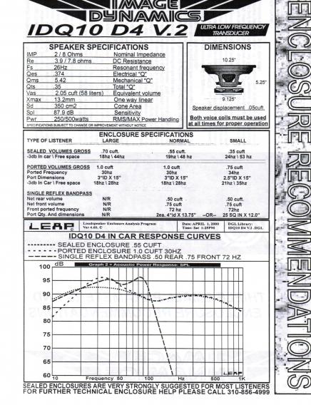

I would like to use the two IDQ D4 v2 10" subs that I currently own from my former SQ vehicle. Spec sheet is attached.
I also have a Bash 300 watt plate amp.
I am thinking of a dual 10" sub box with the plate amp installed to power them.
I have access to a full workshop but I am totally new to this.
How big should the box be? sealed? would interior bracing be required, if so how much? How much foam is required? How do I wire the two subs into the amp and what parts are needed? Any other key points would be appreciated.

The spec. sheet you have, has all the information you need.

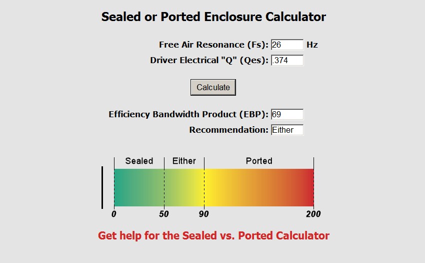

A 0.7ft³ = 20L (each driver/volume) large enclosure looks better because the free space F3 is 44Hz (vs. F3=48Hz with 0.55ft³ = 15.5L for the normal vol. of the enclosure specifications).
So, for home, building a large enclosure with minimum size (note that this is the interior volume not counting with the extra volume for driver and interior bracing) 40L as in specs sheet would be better, make it 50 or 60L (1.7/2.1ft³) (2xdrivers) to take advantage of the low extension.
In your case also an isobaric would not be a bad idea.
Look at isobaric systems and 4th order bandpass systems (SUBS).
I am convinced that the best musical system is the sealed one but you need the large box.

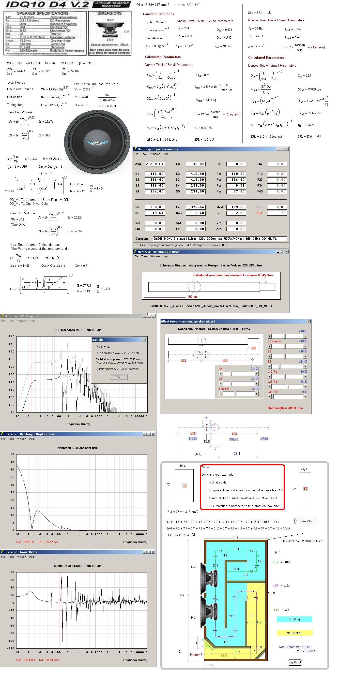

I dug up an old simulation attempt using 2 of the IDQ D4 v2 drivers in a OD ML-TL box:
If the flared port at the input/output is substituted using a straight tube, then the max output power for the box is ~cut in half and limited by
the Port Air Velocity.
b:)

bjorno,
This project you posted looks awesome. I hope OP takes advantage of it with a few pictures and final observations. :D
Thank you Inductor :) . If someone move the simulation into Sketchup or a Cad: program,the unclear ? dimensioning of the Port system would be much more clearer....

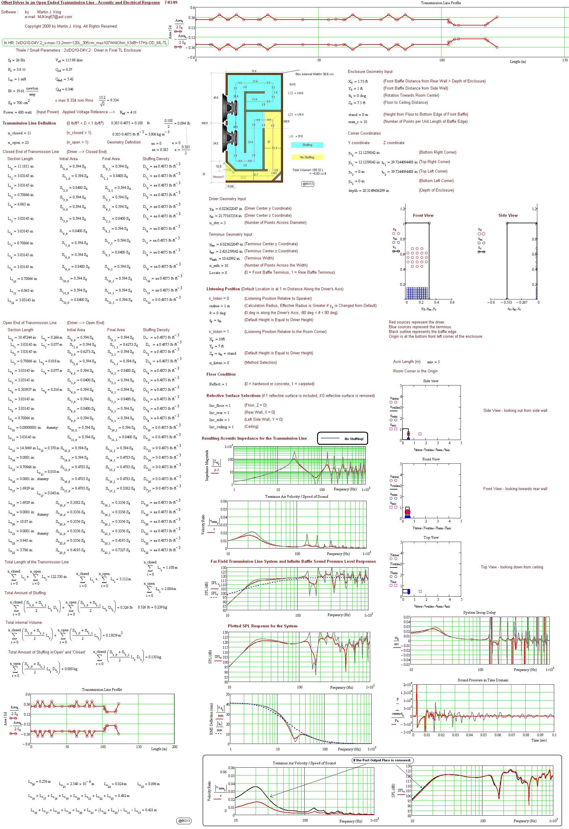

Here are more on the same subject: A lot more numbers to dig into :D

bjorno,
I learn so much from your posts.
Things like several mistakes and bad assumptions that I made in building the first Lab 12 OD_ML_TL.
I was wondering why the stuffing material was so hard to fluff up enough to fill almost the entire line:(, and
I have finally come to fully understand port end effect corrections, and it is not the same as when modelling intakes on 2 stroke engines as I was thinking it may be.
