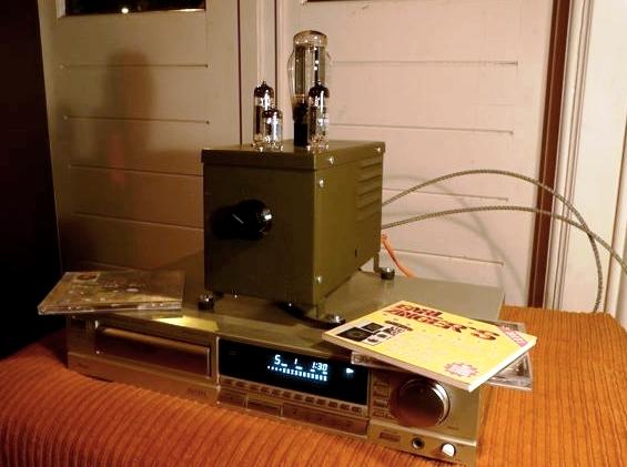

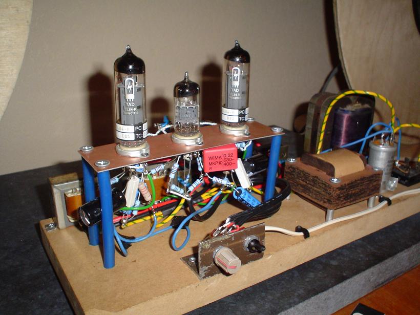

Hi CivicProtection,
Yes, the RH84 is popular, and very much appreciated, at least by me.
So much, I actually build two versions of it;
the first being my very first amplifier build; keeping it open for experimenting,
the second in a nice case (re-use of a relais housing from army surplus).
I've build a whole lot of amplifiers since, but I still use the second RH84 daily.
Look around these pages for the various comments on the RH84SE.
Please note that however lots of people use this design as a First Build,
there are quite some experienced builders who build it and even they like it.
Don't worry about the tube-rectifier on the original schematic,
In my first build I used a diode-bridge, in my second I used a tube.
There's a difference in sonics but both sound absolutely fine to me.
But be sure to have a sturdy PSU with minimal ripple.
It may not show on normal speakers, but when you want to use it as
a headphone amp aswell..... You'll hear every tiny bit of ripple.
This goes for any SE amplifier really, wether you choose RH84 or not
My advice: Walk the RH84 road !
