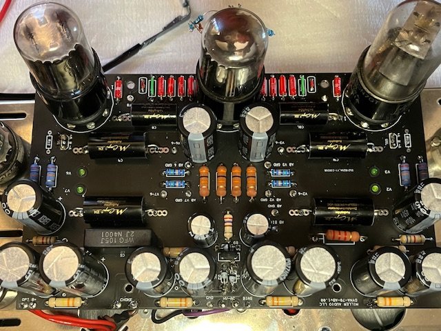

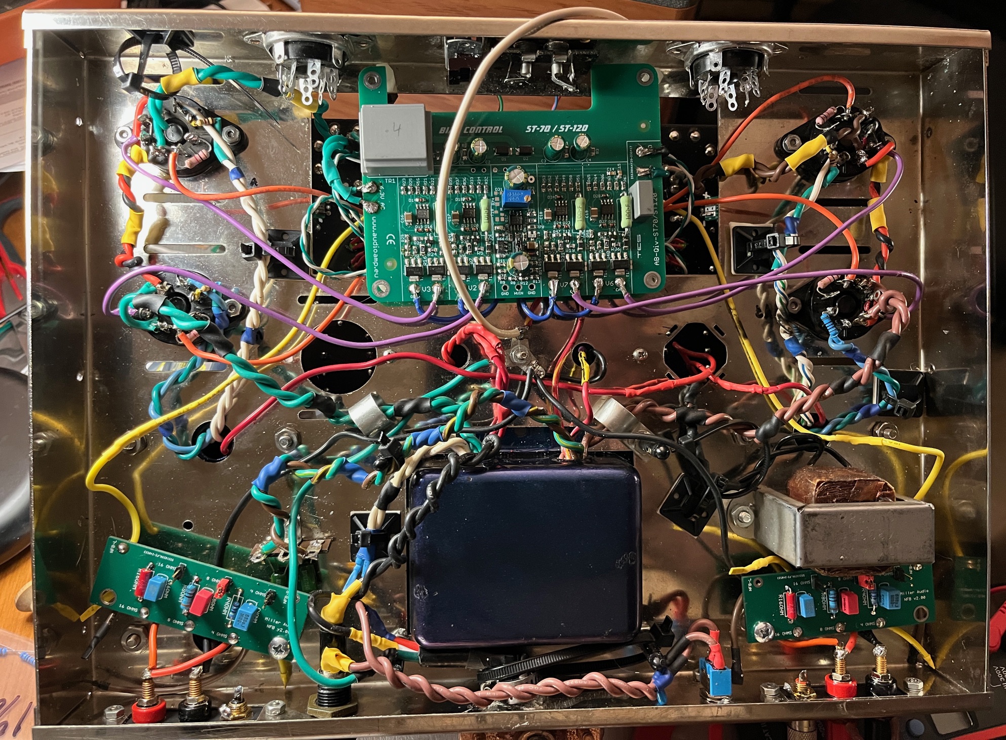

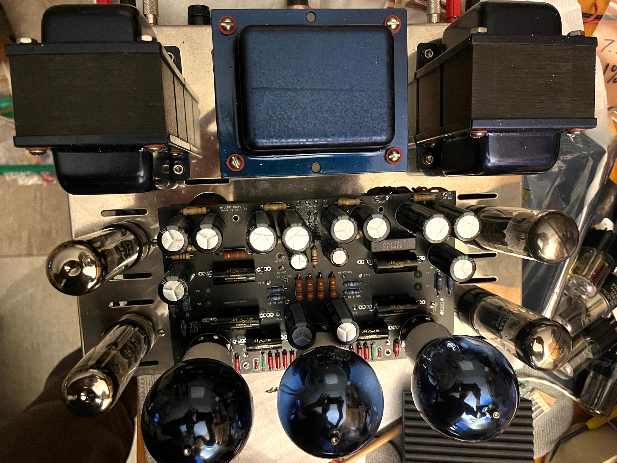

Here's how it looks right now, except that the white wire that you see extending out of the chassis is gone. That was just for testing some stuff.
The PCBs are not attached to their mounts at this moment as I need access to the bottom of the main board for some of these modifications.

At the advice of someone online, one thing I'm just starting to do now is to replace the long run of wire for the negative feedback with a shielded wire. In this picture you can see the long yellow wires for each channel.

Power supply ground (ground of the power supply filter caps) should be separate (grounded to the chassis) from the signal ground. Only the signal ground should be connected to the ground loop breaker board.
OK, this is where I start getting a little lost, @hifiamps.
I'm assuming those are the electrolytic caps rather than the film caps. But if the main PCB has one connection to ground (and the auto-bias board gets its ground through the main PCB) then how would I separate the ground for the power supply from everything else?
I mean, I don't think it's possible to separate the circuit ground from the power supply ground within the board itself, right?
It looks like the row of eight electrolytic caps along the bottom of the picture are the main filter caps. The choke connects there, and there are diodes. The ground of those caps should connect to a chassis ground point. There is a pad marked GND near the middle along the bottom edge of the PCB. That is probably the ground wire. Be sure that ground wire connects to a different point on the chassis from the other grounds. Not to the lifted ground.
@hifiamps, that ground wire connects to the ground loop breaker board along with everything else.
But this board is power supply and signal processing in one so I don't know about moving the ground to the chassis. That would move almost everything to the chassis except the common/negative from the speakers and the center tap from the transformer and the shields from the negative feedback wires.
I suspect that what you're suggesting might not make sense when the power and signal stuff all shares a ground through the board. But I'm just learning here...

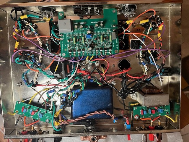

I tried to follow the wiring in your picture but a couple things aren't clear to me. The red/yel HV CT, where does it land? Also the 16ohm output tap, yellow wire, runs to the driver board for feedback it appears but the speaker ground lands on the chassis star ground. That's a pretty big ground loop for the feedback. The common for the feedback should land on the common side of the input stage cathode resistor. Feedback is measured at the input tube relative to signal common. If the common reference for the feedback is on the chassis star ground and then the star is connected to the board via another wire, any noise in the ground system will be modulated into the feedback. I also notice that the right side in the picture has the yellow feedback wire and the speaker common wires surrounding the choke. That's a sure way to pick up noise. The two wires should run on the same side of the choke and twisted is better yet. I've done several ST-70's for friends with horn speakers and to get them quiet you have to do everything correctly. They were dead quiet on 107dB sensitivity horns so it is possible. Since we don't know how the pc board is arranged it's hard to be certain about some things.
Yes, and don't believe everything you read.I suspect that what you're suggesting might not make sense
All good fortune,
Chris
Hey @nerdorama and @hifiamps,
The red/yellow center tap connects to ground...at this point it connects to the ground of the ground loop breaker, not to chassis.
That yellow wire that looks like the 16-ohm wire is actually the feedback wire from the main PCB back up to the OPT. I have since replaced it with a (white) shielded wire. The 4-ohm and 16-ohm OPT outputs just have heat shrink over the ends and don't connect to anything. I only have an 8-ohm speaker tap. There are a couple of short wires (yellow and brown) attached to the feedback selector boards in case anyone wants to switch to 4 or 16 ohms later but since the jumper is on the 8-ohm selector, I'd be surprised if they could be impacting anything. (Tell me if that's wrong!)
The only wire running next to the choke is the shielded feedback wire.
I don't understand what you're saying regarding what should be going on with the common (black) wires from the "ground"/"negative" speaker terminal. You're right that they go to the "star ground" which is now connected to the ground loop breaker, not to chassis.
The white wire is the ground connection of what I think are filter caps. (Two caps with the outer leg of each going to green and brown transformer wires, respectively, and inner leg of each tied together and to ground (to ground loop breaker.)
Where you see screw of the former star ground, that is the lug that has only the power cord ground attached. Then the other lugs are actually connected to a terminal strip that is connected to the ground loop breaker board. (You can see it next to the circular opening in the chassis.)
