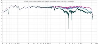

I was hoping to get some thoughts on what might be wrong with my speaker's tweeter. I've attached a summary of nearfield measurements I've done on my good speaker, the bad speaker and the bad speaker after I opened it.
The bad speaker had an indention in the wire mesh covering the tweeter after a recent move. Thinking this might have something to do with it, I opened the speaker to pop it back out. However, as you can see, in the process of opening it, I did something to further damage the speaker. Any thoughts on what the issue is? I can post pics of the speaker and internals, provide more info, etc, if needed, but I'm not sure where to start at this point.

Perhaps you can try straightening the voice coil former (the damaged silver tube with the voice coil wound over it). It looks like it's been crushed somehow and will now rub on the magnet assembly. I'm surprised it works at all. It needs to be perfectly uniform and cylindrical and centered in the magnet gap with no actual contact. Be careful not to damage the voice coil itself in the process. You've got nothing to lose at this point. Otherwise you should buy a new matched pair as different production runs can have variations. Are there any stamped or printed numbers on the tweeters? An email to Usher might sort this out. Good luck.

It looks almost like the coil-former had been crushed on the back edge. Could this driver had encountered a moment of DC? I'm thinking some "negative DC hit it & drove the coil rearward ...smashing the former way past X-max (linear).
Since it seems to have plenty of "extra" former before the coil itself starts, I'd find some small curved scissors & try to trim away the damaged part, 2-3 mm worth. ???
