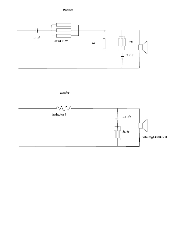

I want to modify the crossover a little bit. Nothing fancy, just some better resistors for the tweeter and mayby change the Solen FC cap also. My goal is to maybe get the tweeter a bit more open but to keep the original values.
But i have some questions. The designer used 3 parallel resitors instead of 1. Why did he do that? I have read somewhere that it wil create a faster flow?
So, can i replace the three cement 6r by one 2r resistor or will this afact the overal timing?
I have made a fast drawing (hope i did it correct)
It looks like the designer had a surplus of 6 ohm resistors he wanted to use up.
Paralleling resistors will certainly 'create a faster flow' as it reduces the resistance.
Resistance is the opposition to the flow of electric charge - the smaller the resistance, the faster the flow.
That isn't much of a crossover to modify. Conceivably changing out the high pass capacitor 'might' make an audible difference and 'if' the original resistors are slightly inductive changing those might make an audible difference but the high pass is single order. You could try disconnecting that 2.2uf cap as that is pulling down the extreme top end and see if that makes it "more open" but since the original designers thought to put it there that seems unlikely to be beneficial. Probably just make it too bright.
Resistors don't "slow down" any electrons, they convert some of the energy to heat so that less energy passes out to the following portion of the circuit. Using multiple resistors is a common way to get a value that was hard to arrive at with a single resistor and of achieving a total power capacity across the set that was hard / expensive to derive with only one.The capacitors and inductors actually do 'slow down' the signal in the sense that the signal changes phase as it passes thru the tuned circuit but that is th every nature of the circuit.

Thanks. That make sense. I wil try to lower the 2.2uf just for the effect.
Agree with changing just one side at first. That way you can very easily hear the effects. With cheaper resistors, when you parallel a bunch together, the inductance goes down as well as the resistance. Higher quality resistors designed for crossovers have a much lower inductance than the cheaper kind (in general). Even a better quality capacitor usually benefits from a small value by-pass capacitor (many disagree with this but I have done many listening tests and know for sure the improvements are real; sometimes VERY obvious).
YES! Some tweeters can cross quite low. Even if you think 10 Watt resistors are good enough, 3 in parallel would give a much better safety margin. I always have 25 Watt rating or higher even if I have a tweeter rated for 100 Watts and cross above 4 KHz. The lower the crossover on a tweeter, the better resistors and higher Wattage rating may save you from distortion or worse; a burnt VC!
That 5.1 uF series capacitor would indicate a crossover frequency of around 4,000Hz with an 8 ohm tweeter (8,000Hz if 4 ohm), albeit with a shallow slope.
I doubt the paralleling up is for extra power handling reasons.

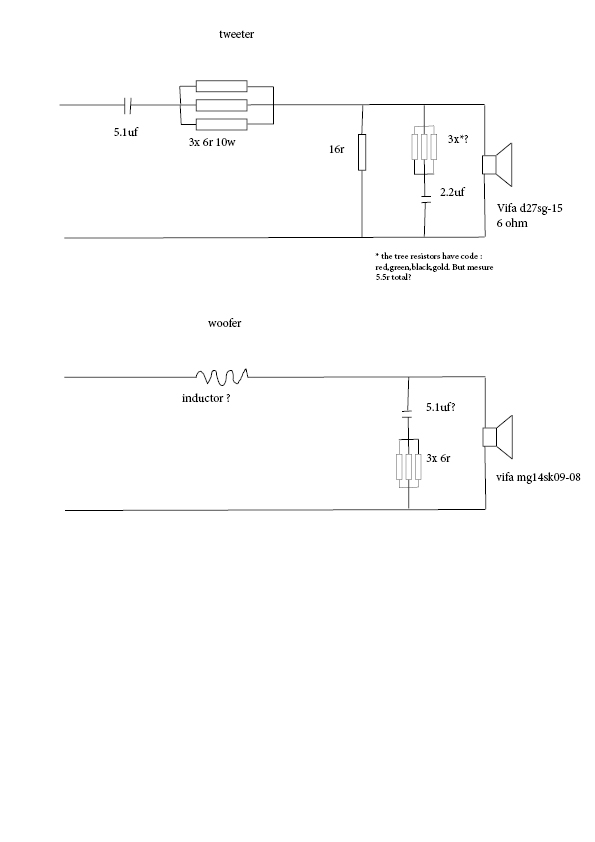

P.s. the crossover is hardwired. And the components were glued on the tweeter and woofer. So mayby thats why he used resistors in parallel?
