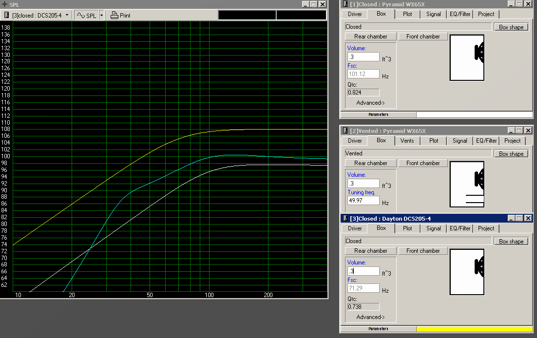

For an 8" "tube sub" I'd suggest slapping an 8" driver in it, and then using equalization (look up linkwitz transform) to flatten out the bottom end. Use raw amplifier power to overcome the small box size, pick a driver with reputable power handling claims (read: not pyramid or pyle) to do this.
Before doing that, you might try adding a ~2" x 10" port to the current box. The resulting gain in the bottom end might make it sound acceptably natural, but keep in mind that the system is Xmax limited to around 10-15W regardless as it stands currently, an 8" with more Xmax would make for a much better sub in this box..
In the simulation below, the white plot represents very roughly your current maximum SPL across the listening range. The light blue plot represents the maximum SPL if you add a port but you should ignore anything there below 40hz as it would be unloaded, the yellow line represents the maximum SPL if you use this woofer instead: [ Dayton Audio DCS205-4 8" Classic Subwoofer 4 Ohm 295-200 ].. The 8" dayton sub there delivers about 7X the displacement capabilities and can pretty well and handle the full 150W thermal rating before running out of Xmax in that box size, which makes better use of available box space if you have the available amplification power and a way to EQ it flat.
