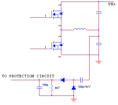

To the original topic - Half-bridge current sensing:
recently I found in one of commercial supplies Half-bridge current sensor based on measuring voltage ripple on the sentral point of Half-bridge capasitors. Looks interesting, and there is a healthy logic in this - this voltage is really proportional to the Half-bridge current, but I have never heard of such solution before... What do You all think ? Is it used somewhere?
The overcurrent output signal should be a rectified and proportional version of the coil current. With this circuit I'm not convinced that the output will respond to coil currents flowing in both directions. Or am I just being exceptionally dense today?
Response time? The rate of current rise is limited by the coil inductance. For a given current I through the coil, C*V = I*T, so
that the change in voltage, V = I*T/C. It looks to me like the cap value is going to have an impact on the response time.
