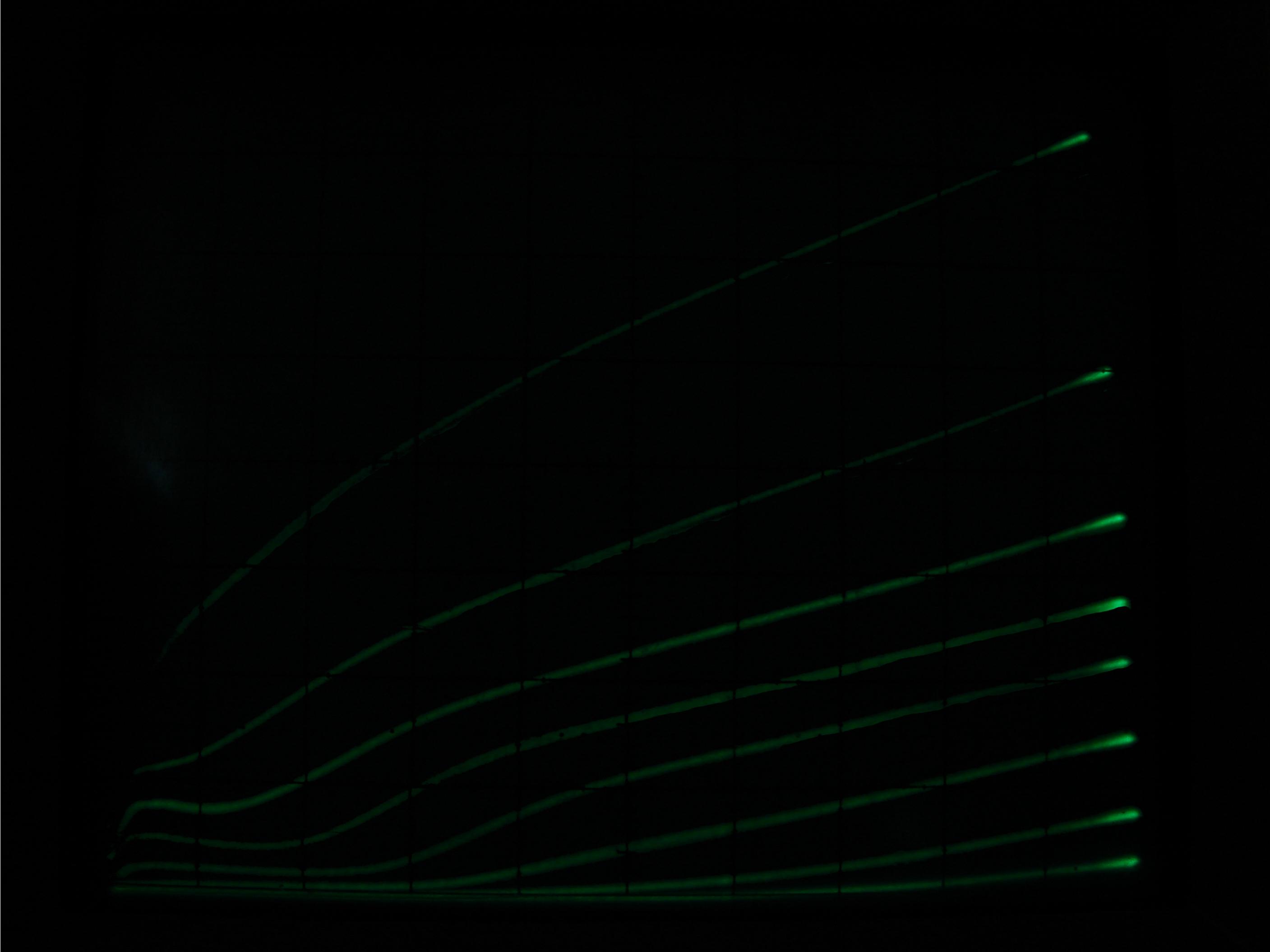

I purchased some cheap JAN 1619 tubes and I could only find the pentode curves. I traced the triode curves using my oscilloscope and a digital camera. Picture is attached. I hooked up a 300v ct transformer into a bridge rectifier to get a Plate driver signal. Connected a 10 ohm resitor to the cathode and G2 to the plate (with 100 ohm resistor). I used my bench DC supply to set the control grid voltage and took a picture with each voltage setting. I brought the pictures into the PC and combined them into one.

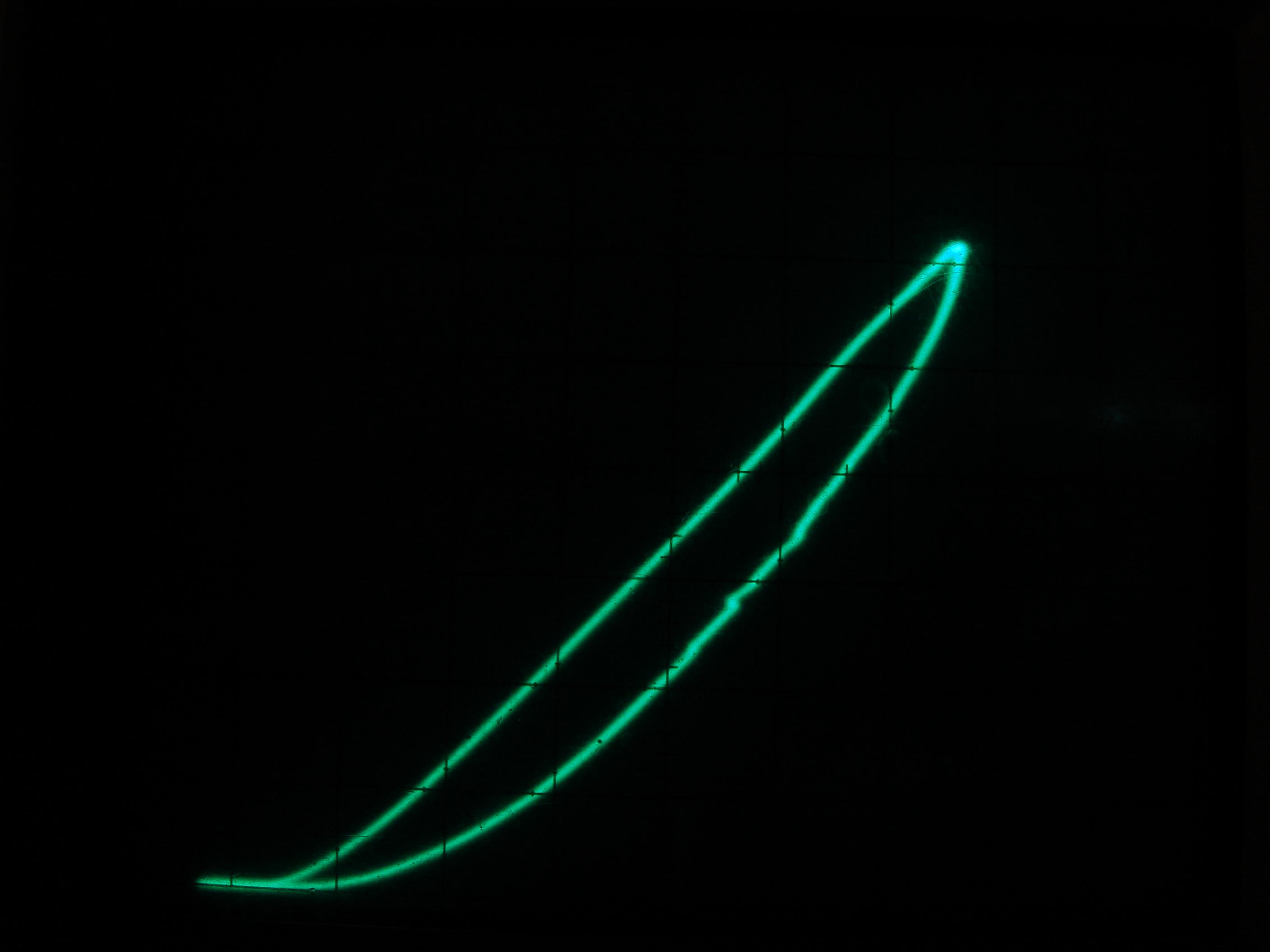

I tried tracing the UL curves but my setup does not seem to work. I tried tracing them with an edcor SE transformer with 42% taps. The do not come out clean. The trace look very linear on the positive slope of the drive signal but on the negative sloped side they look distorted.
I want to find the optimal tap value for the Jan1619 tube.
Does anybody know the proper setup to trace the UL curves?

Hi, connecting G2 (screen) to the plate will give you triode operation. That is also what your curve traces show. To trace pentode operation, you will need to tie G2 to a fixed supply. To trace the UL plate curves, you will need to hook up G2 to a fixed divider off the plate. The 42% taps on your transformer will work nicely. Also, you should pu the 10 resistor in the plate, otherwise you are measuring plate+screen current. BTW, 42% will be pretty optimal. But then again, what is optimal? it is just a tradeoff between power and distortion - what are your goals for each?

Thank you both.

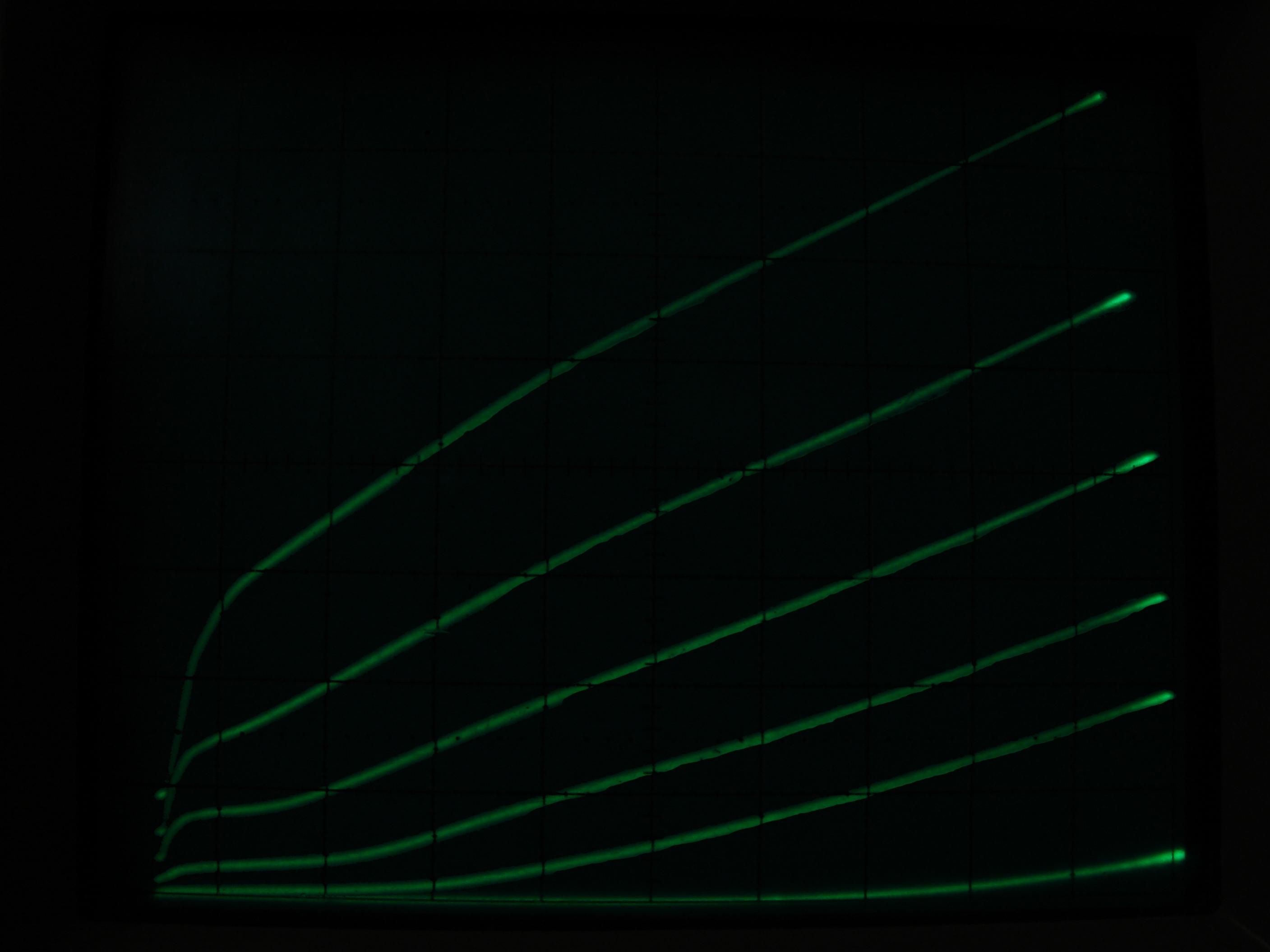

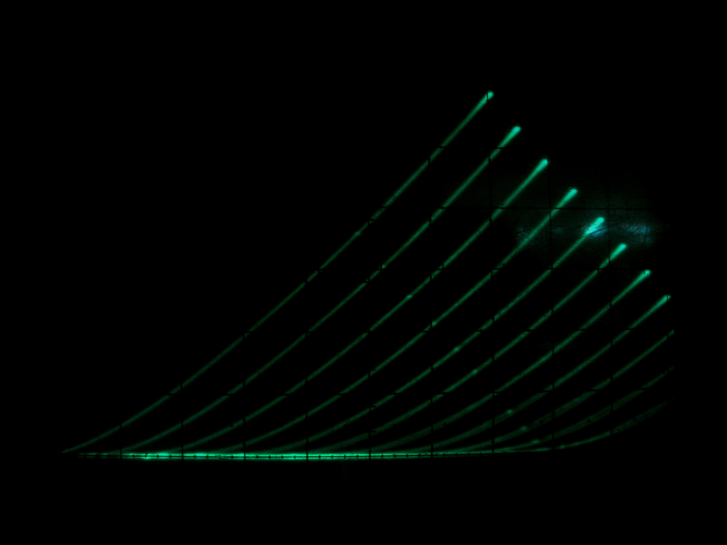

I have attached more pictures. One is the digitized triode curves.
I have drawn two PD curves, one for the Plate PD only and one of Plate plus Screen.
Another shows the problem I reported on my UL setup. The picture is for a single g1 voltage, see the loop I am referring to. The loop exists with our without load and with both the SE Edcor transformer and a cheapo 7010. I cheated and erased the lower portion of the loop and produced a combination graph of 25,35 and 50 percent taps from the 7010 transfomer.Colors are in that order from top to bottom. I wonder if these are valid curves. I also have heard that lower taps would suit the 1619 better, this is why I wanted to check.

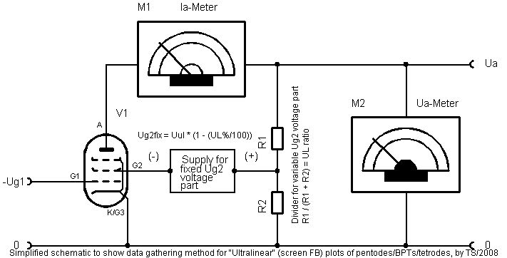

Sure ;)
Attached you will find what essentially I use myself - okay, shown somewhat simplified here, but you sure will get the idea. All necessary formulae are given. Depending on the tube you want to measure, be sure to have "enough" current running down the R1,R2 series chain divider, say, about 3x of what you expect (or know) to be the peak Ig2 requirement (within the a->g2 current takeover region) of the TUT.
All the UL plots on my homepage were done using essentially the same principle. Example here.

Hi Alfredo,
For the fix UL voltage portion formula, what is Uul AND UL?
Uul is the "ultralinear voltage", meaning the iddle voltage you want your tube to run at, hence the voltage where Ua=Ug2 (or Ea=Eg2, if you prefer). Never mind in real world (using an OPT w/ UL taps) Ea probably will be a very few Volts less than Eg2 due to the additional ohmic (copper-) resistance between the UL tap and the anode tap of the primary of the OPT.
UL% is just the UL ratio given in percents, as usual. Counting from B+, 0% means g2 to B+ (pure pentode operation), 100% means g2 to anode (pseudotriode operation).
Tom

Hi Alfredo,
On your setup, do you use pulsed drive signals? Are these from a PC source or a dedicated hardware circuit?
I am using only a few PSUs and DVMs plus the graphing functions of good old Excel 2k for visualization.

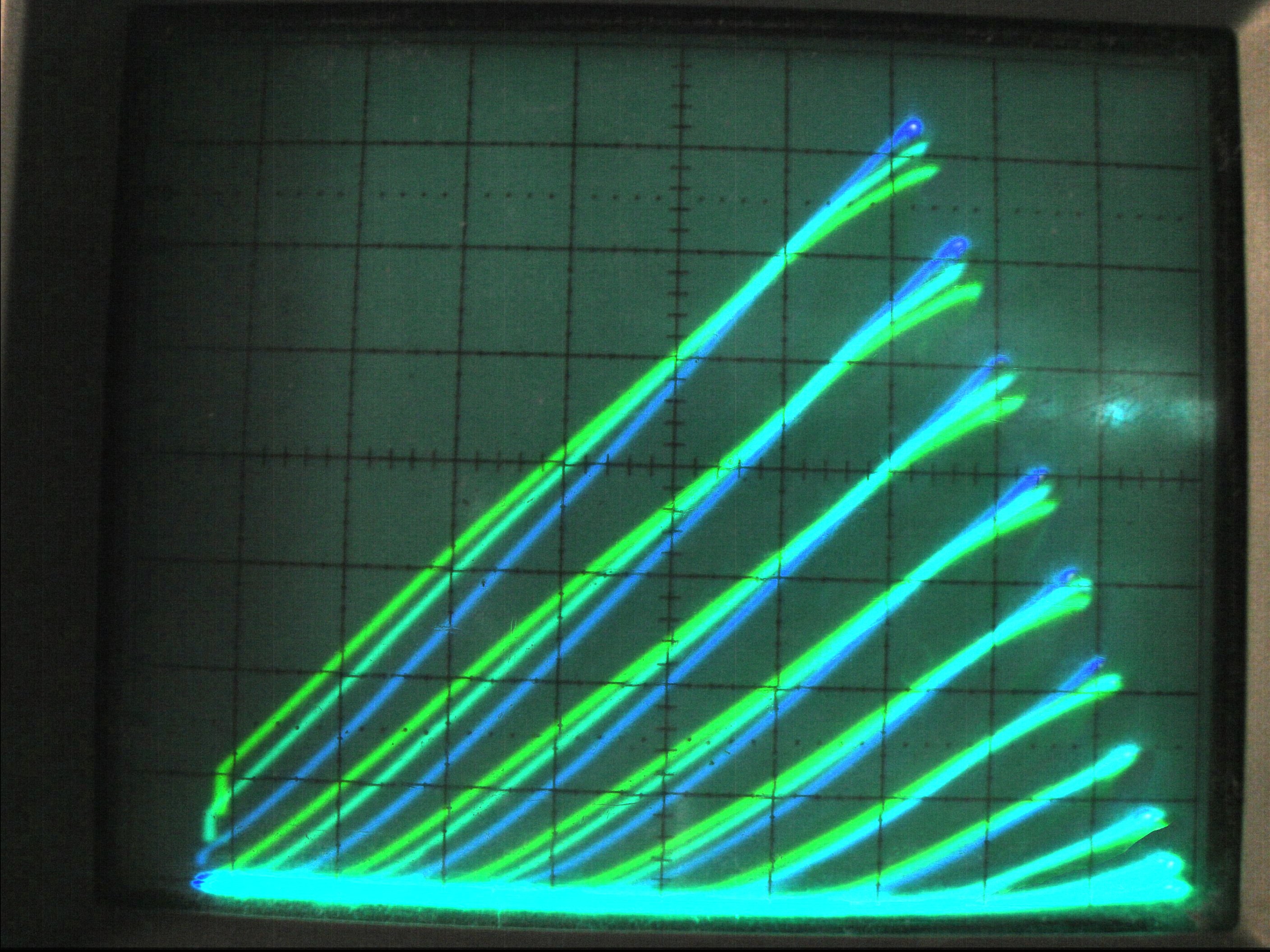

Was able to get some new curves using Tom's proposed setup but still using a rectified signal for the plate voltage.
Tom, the only way I was able to get current going to the tube was by inverting the polarity of the supply for Fixed Ug2.
Did plots for 42% and 20%. I missed a g1 step closed to the bottom of the 42% plot. Seems to be that both appear to have too much nonlinearity under lower Plate voltages. I played with voltage dividers with total resistans from 50K to 1meg. Didn't see much improvements on the plot kinks on the lower Plate voltages.
I like the look of the triode curves much more than the UL curves. I guess I can live with lower ouput power.
