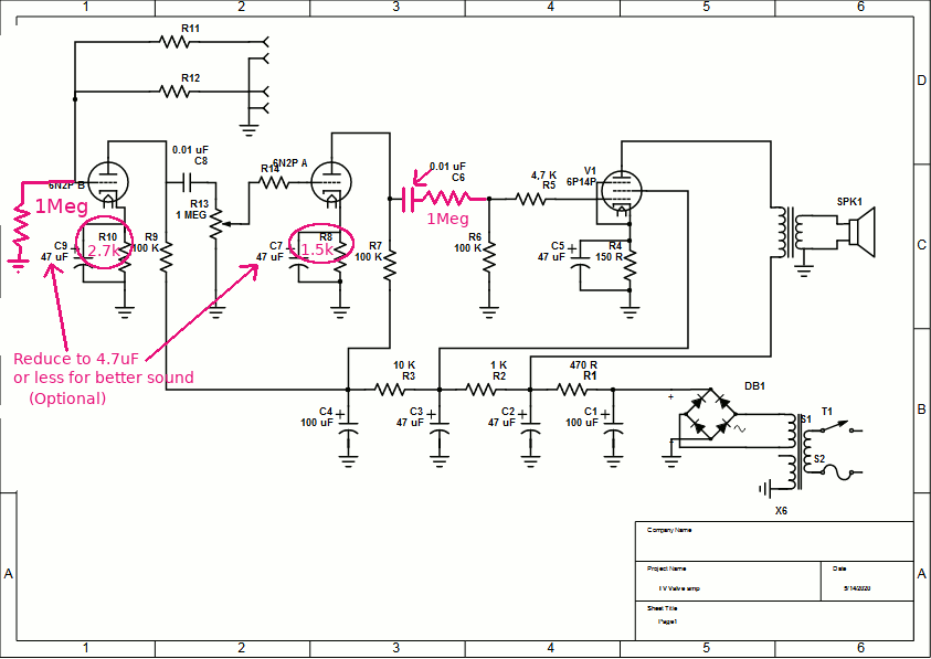

Already for weeks I have been trying to build my first SE tube amp from old soviet TV parts. Tubes are 6P14P on amp and 6N2P on preamp. The amp is working only if I play super mildly and on low level. As soon as I pluck some string heavier a horrible distortion starts. I think I have tried everything - different resistor values, different OPT, different input and pot wiring. Gods are against me! Is there a mistake in schematic? Are the tubes bad? (I have few, all second hand, but from different sources so some of them have to be good.) Probably its just me, but where? Power transformer is 216 Vac on secondaries. B+ is 295 Vdc, B+1 after OPT 260 Vdc, B+ 260Vdc, B+3 = 130 Vdc, B+4= 150 Vdc. Filament Voltage 6.8 V. I have two OPT - one from same TV (measures 485 ohms on primaries, 2,8 ohms secondaries (so WR should be 13:1?)), other one from old radio (WR 23:1).
(The value of R14 is 200 K right now and input has 1 meg resistor that's not shown in schematic).
Can someone help? Thanks in advance.

...changed R8 and R10 to 4.7 k...now the cathode voltages on preamp are 1.9 V and 3.2 V.
1) You can immediately see there is a problem: you have two nearly identical triodes (yes, in one glass bulb, that makes no difference), but with the same 4.7k cathode resistor, they are biasing to two completely different cathode voltages!
This is because you have forgotten to connect the grid of the input triode (6N2PB in your schematic) to ground through a bias resistor. Without that resistor, the grid will float to some unknown voltage, tube bias will be wrong, and the amp won't work correctly.
So your first fix is to connect 1 megohm from 6N2PB grid to ground, as shown in bright pink in the attached image.
2) The value of 4.7k is not suitable for cathode-biasing this tube - it biases too cold. Your second fix is to use 2.7k for the first triode (6N2PB), and 1.5k for the second triode (6N2PA), as shown in pink in the attached image.
I guarantee that these values will work, unless your 6N2P is defective. I'm using these values myself, in a guitar preamp, using the same 6N2P tube and 100k anode resistors that you're using.
You were on the right track when you changed both cathode resistors to 2.2k, but there were other mistakes in your amp, which prevented you from realizing that you had made a step forward. No worries, just go back, put in 2.7k and 1.5k, and you'll be two steps forward again.
(Alternatively, you can use 2.7k for 6N2PB, and 1.2k instead of 1.5k for 6N2PA. This values are also guaranteed to work - I've used them myself.)
3) As others have said, your circuit has too much voltage gain. Normally there would be a passive tone control circuit, either between the two triodes (like a Fender Champ), or between the second triode and your output pentode (like a Fender Blues Junior).
This tone control circuit would cause a lot of signal loss (attenuation, sometimes called insertion loss). You don't have a tone control circuit at all, and because of this, no attenuation, and as a result, you have at least ten times too much voltage gain. This is one of the reasons why your circuit distorts and sounds horrible when you turn up the gain/volume pot too far.
So your third fix is to insert another 1 megohm resistor between the second triode (6N2PA) and the output tube, as shown in bright pink in the attached image. This resistor will introduce about 20 dB of attenuation, just as a tone control normally would do. This will allow you to turn up the volume without distorting the heck out of the guitar immediately.
4) The changes above are mandatory - make all three of the changes above, and your amp will work, unless there are other problems that haven't been diagnosed yet. Once you have your amp working, you can always fiddle with those cathode resistor values, et cetera - but the first step is to make it work, before you can start fine-tuning it.
However, there is another optional change that I'd suggest. Replace those triode 47uF cathode bypass caps with 4.7uF or less (also shown in pink on my drawing). This will reduce a very unpleasant type of distortion called "blocking distortion".
4.7uF will still let all the guitar's bass through, and this may produce a bassy and unattractive guitar tone from your amp. You can reduce those caps even more later, if you find the guitar sounds too bass-heavy. Marshall used as little as 0.68uF in some of their classic tube amps.
-Gnobuddy

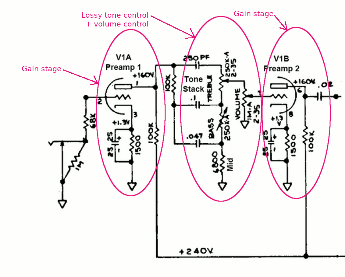

Would it not be fair to assume, with a guitar plugged in, that the input tube grid would find a path to ground through the volume control wiper on the guitar? This would end up in parallel with the 1Meg. Now if the guitar output is capacitively coupled for some reason...
Good catch on the absense of the tone controls - and its corresponding attenuation. I get it after being shown - not on my own!
...the input tube grid would find a path to ground through the volume control wiper on the guitar...
Sure, 99% of the time, yeah (some guitars have active electronics on-board, and may have capacitive coupling without a grounding resistor, as you say.)
But: what about the mighty "Thump!" in the loudspeakers when you plug in the guitar, and the anode of the first triode falls from 350 volts DC to 200 V? What about the wrong DC bias voltages the OP read when (presumably) a guitar wasn't plugged in? What about the little engineer sitting on your left shoulder, whispering to you that it's just wrong to build an unfinished and incomplete circuit like that?
Even the notoriously frugal Leo Fender never left off a grid bias resistor entirely. I can't bring myself too, either!
It would, indeed, but this is "business as usual" with electric guitars. 1M input impedance is more or less standard for the majority of guitar amps and guitar FX pedals.

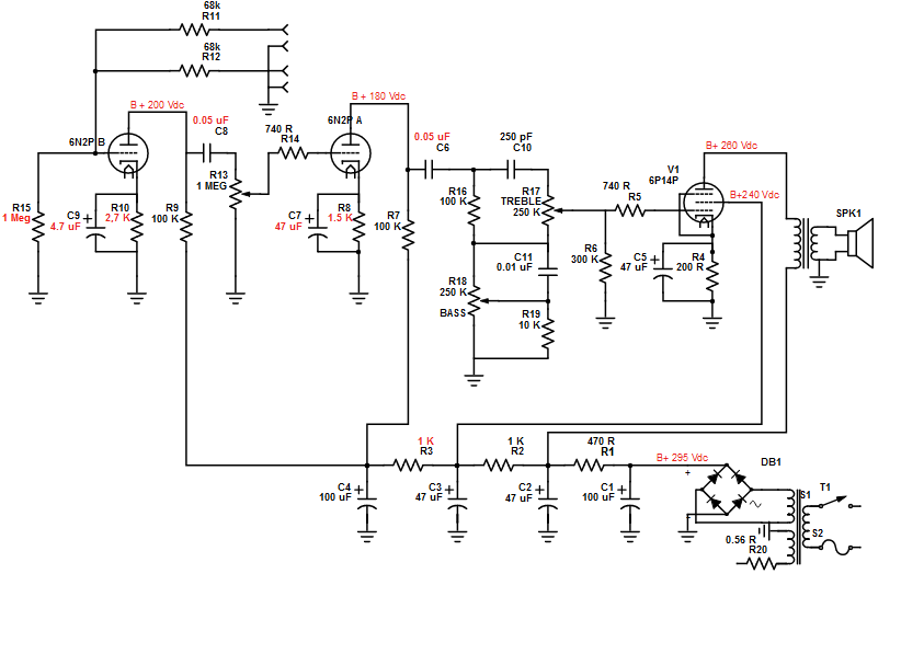

Hi, thank you all so much for help!
I added 1 Meg (well, 940 K to be honest, I use what I have on hands) from input triode grid to ground. I used 3 K for 6N2P B and 1.5 K for 6N2P A, so cathode voltages Now read 1,65 V and 2,1 V (Do I have to get them exactly the same?). Changed R3 to 1 K, so preamp plate voltages are now 190 and 170 V. I tried using 150 ohm resistor, but that did not change anything much.
I was using Gibsonette GA 8 schematic as one of guidlines and there preamp plate voltages are around 160 V, so I assumed thats normal for 12AX7.
C7 and C9 are changed to 2.2 uF. Heater voltage corrected to 6.3 V.
I added simple tone controls and 470 K resistor (not on schematic) between C6 and R5.
Nothing helped.
But I misunderstood Printer2 comment and changed volume potentiometer to 10 K, and strangely enough, that helped. Distortion comes in only when pot is halfway up and it is less there.The sound is lacking bass (I did change coupling caps), but at least its not distorting, I guess that is "blocking distortion"? it doesn't come in gradually, but cuts in sharply when gets to certain volume.
Anyway thats not real solution, probably there is some dumb mistake somewhere.
I will get resistors and caps with more precise values maybe that will help. And I have digital multimeter.
Good!
Do you mean the other way around, right? 2.1V for 6N2PB, 1.65V for 6N2PA? If so, yes, this is fine.
No. But if both cathode resistors and both anode resistors are the same, then the two cathode voltages should be nearly the same. In your post #10, you said you had the same 740 ohm cathode resistors for both triodes, but you measured different cathode voltages of 1.9 and 3.2 volts. This showed me that something was wrong with your circuit.
What was wrong was the missing 1 Meg resistor from 6N2PB grid to ground, which you have now fixed.
Good, that will work.
Gibsonette...preamp plate voltages are around 160 V...
In North America, when we say "B+", we mean the supply voltage, not the plate voltage (plate voltage is much less than supply voltage in the type of circuit in your preamp.) So when you said "B+3 = 130 Vdc, B+4= 150 Vdc" in your post #1, you caused some confusion for other people. No problem, though, we all figured it out now, and you've fixed the problems, so your circuit is now (almost) ready to work.
Good!
This type of tone control (Fender Brownface Bandmaster, etc) doesn't cause much signal loss, so by itself, it won't solve your distortion problem.
Nothing helped.

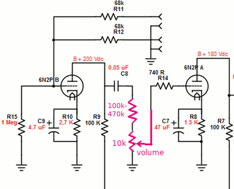

I see that you increased R6 to 300 k (it was 100k before). At the same time, you reduced the 1Meg I suggested to 470k. The combined effect of these two changes was bad. Instead of the circuit cutting down the signal 10 times, now it only cuts it down 2.5 times. Not enough.
...changed volume potentiometer to 10 K, and strangely enough, that helped.
This is not strange - 10k is much too small, it destroys all the voltage gain from 6N2PB (now that triode does nothing), and as an accidental side-effect, it also destroys the bass response of your amplifier.
I'm attaching a way for you to use the 10k volume pot, and solve your gain problem, without losing all the bass and keeping 6N2PB from working. See the changes in pink in the attached image. You can use any resistor between 100k and 470k, adjust to suit your preference - the bigger the resistor, the more you can turn up your volume control without distortion.
Don't forget: you also have a volume control on your guitar. Turn it down if you want less distortion!
I think you will be happier if you change your whole amp a little - put a Fender Blackface tone control in between 6N2PB and 6N2PA. That will give you the clean tones you want.

...change your amp a little - put a Fender Blackface tone control in between 6N2PB and 6N2PA...
I should probably clarify this comment a little.
Each triode in your circuit will amplify the guitar signal by about 50 times.
The guitar itself typically puts out some 20 mV - 50 mV peak to peak when one string is picked lightly. But if you strum chords forcefully, you might get 1 volt peak to peak or more.
This means the first triode in the amplifier will typically have an output voltage somewhere between 1 volt peak to peak, and 50 volts peak to peak (that's 50 times 20mV, up to 50 times 1 volt).
With 300 volts B+, the triode is able to handle this much signal without clipping. So you don't get much distortion from the first triode.
Now, if you connect the first triode's output directly to the input of the second triode, as you (stroszek) have done, the second triode will start to overload with as little as 80 mV of signal from the guitar. This means you will get heavy distortion (from the second triode) if you turn up the guitar, turn up the gain control, and strum chords on the guitar.
So, in a guitar preamplifier, this recipe (gain stage -> volume pot -> gain stage) is used when you want to be able to overdrive the second triode, creating intentional distortion. The Fender Blues Junior uses a topology like this, enabling it to be used to play blues and rock music.
But if you don't want any distortion, you should follow a different recipe, the one Leo Fender used in his Blackface valve guitar amplifiers. That recipe is to have one gain stage, followed by a (very) lossy tone control, and then the second preamp stage.
This topology throws away most of the gain of the first stage before the signal reaches the second stage, so that there is not enough signal to overdrive the second triode. As we saw previously, the first triode doesn't get overdriven either. That means you get only clean guitar tone, no overdrive.
This recipe - clean tones only - is what Leo Fender wanted back in the 1950s and early 1960s, when rock music hadn't arrived yet, and blues music was still something mostly confined to black artists and audiences, and that too, far from Southern California, where Leo was based. You will find this recipe (gain stage -> tone control -> gain stage) in Fender's Blackface amplifier designs, such as the '65 Princeton Reverb.
In short, if you want nothing but clean tones, you need to lose a lot of signal between the two triodes. The quickest way is to insert an additional resistor as I showed you in post #17. But a better way is to put a lossy tone control circuit in between the two triodes, just like Leo Fender (or his technician) did in the 1960s.
The attached image shows part of the AA1164 Princeton Reverb schematic. Leo not only put the lossy tone control between the two triode gain stages, he also added a volume control there, which can throw away even more of the signal after the tone control has already thrown away most of it. That second triode is never going to overload.
-Gnobuddy
