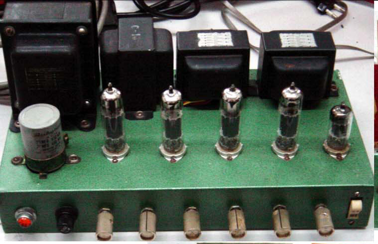

Hi guys,
Im new to tubes. I just bought this jewel from an auction, and now im trying to repair it. Is anyone here familiar with this model? All i know, it is Japanese made, and i need more specs on it... Thank you!!

What a hoot! Are there any tubes under the chassis? I can only see one input tube on the top- surely this is a stereo amp? Solid state input stages maybe?
I was counting the tubes too... my guess is that what we have is a 6BM8 PP amp with a twin triode as an additional pre-amp gain stage. 8W/channel. Honking big OPTs for 6BM8 thou.. maybe ECL86.

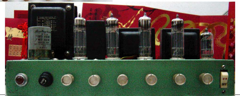

And a photo of the underside.

SY said:
Fooled me- I couldn't make out a second section in the output tubes and assumed 6BQ5 or something like that.
I'm just guessing -- the Japanese do like the 6BM8.

I agree that it's a stereo amp. Knowing the tube complement would help. Obviously, a schematic would help a lot. What has me wondering are the 6 controls, perhaps volume and tone for each channel. It would seem that there are not enough active devices on top to support the controls. Speculation about "sand" under the hood seems reasonable.
I'd like to see a close up of the label on the power trafo. I'd also like to see an image from underneath.
Volume, Bass, Treble x 2 makes sense... if the big tubes are triode/pentode, then the extra voltage stage in the 12AX7 (?) would give enuff drive for the tine controls ... no silicon required (except for rectification -- and there is a good chance it is currently a stack of selinium)
