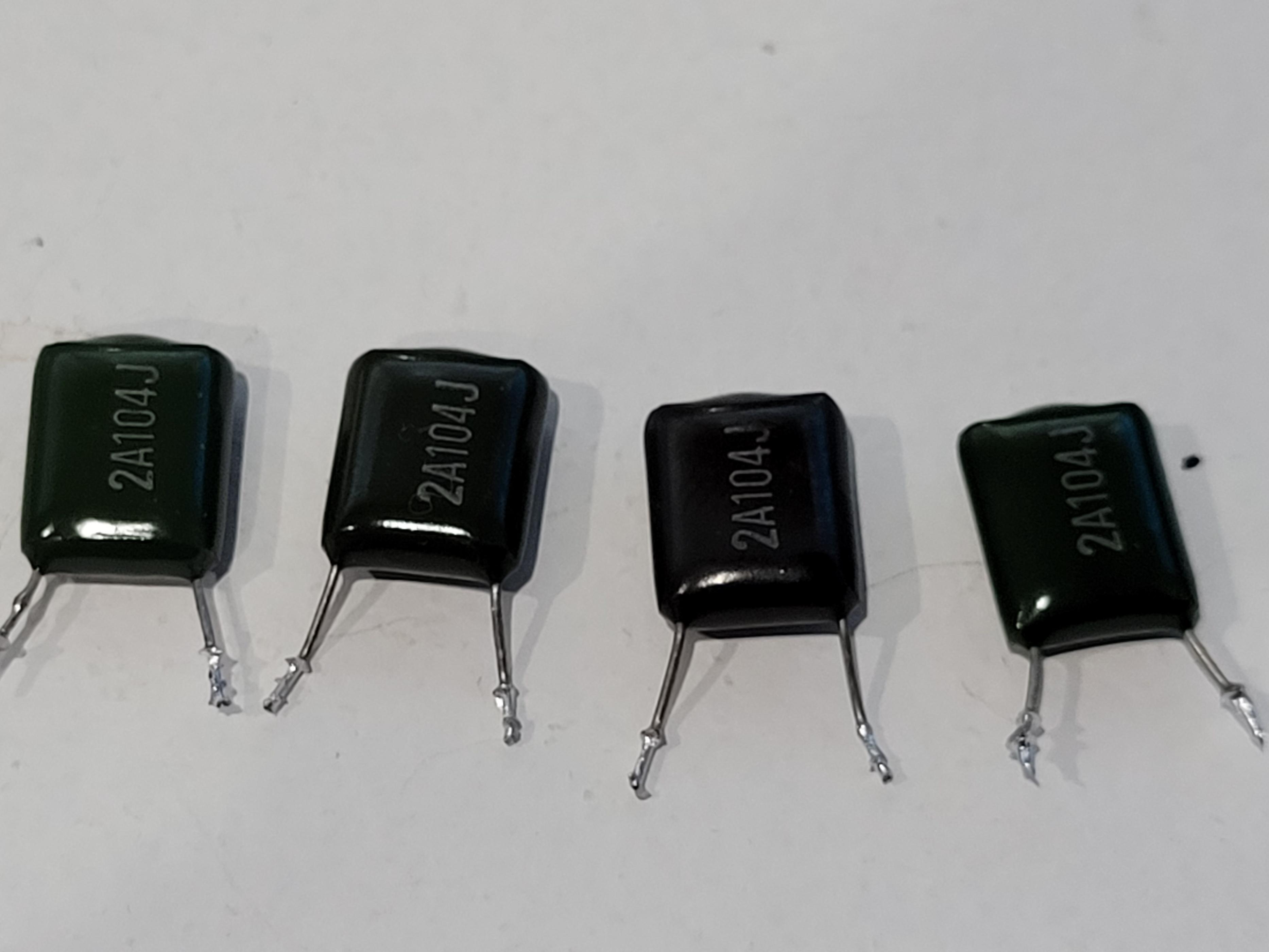

Hi everyone,
Firstly, thanks for the help so far.
Secondly, let's put the 'you should have done this' or 'you should have done that' to rest.
Right or wrong, I was advised to recap the amp as a precaution. Right or wrong, I decided to do that. That is something that is within my ability and I have done it before with another amp with no issues.
I noticed that 1 regulator looked like it was running hotter than it should, so decided to replace it. It may have been working perfectly, but for a few $, I thought it wouldn't hurt since I have the amp apart.
Normally I would have sent this to my audio repairer, but due to lockdown and other reasons he is unable to do it (that is another story in itself).
So now the options are put everything back, or replace it with new parts. I'd rather replace it new parts if I can do that safely.

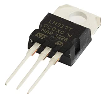

I will get both the metal back versions of the regs and will get the insulators for them. In terms of the heatsinks, they can't be any bigger. They are already squeezed into the space. But since it's been running for 20 years, does it need to have bigger heatsinks?

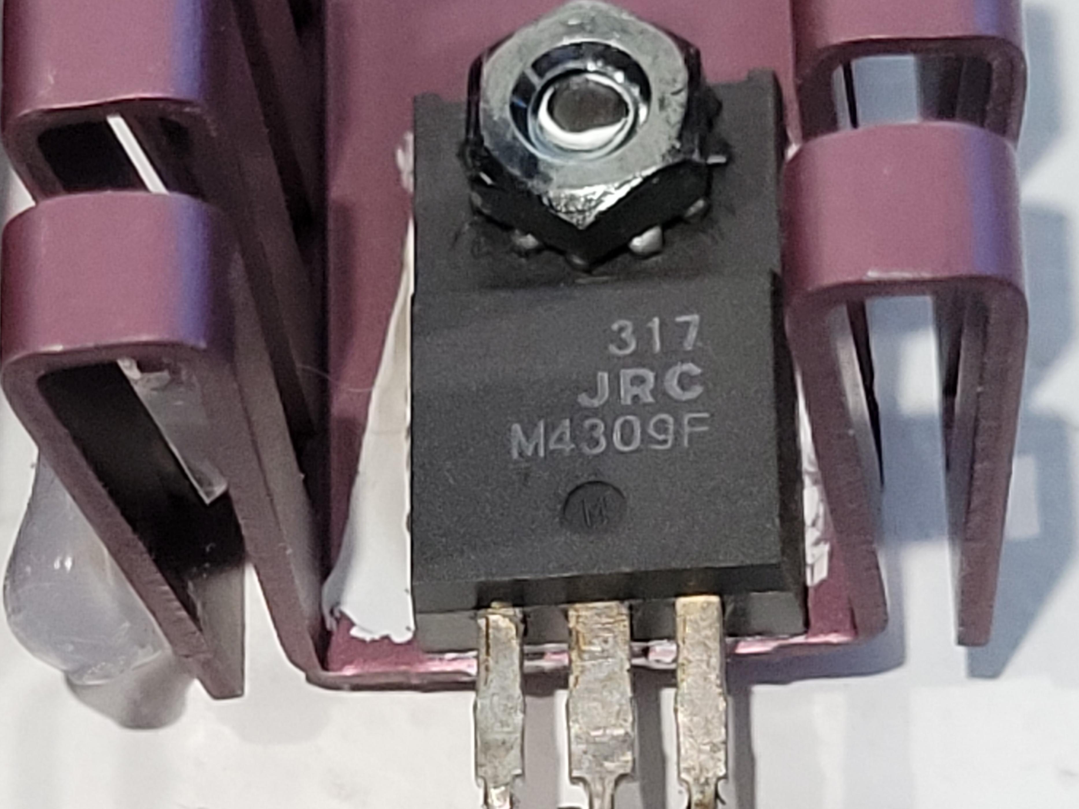

The voltage regulators and insulators have arrived. Do I need to use any thermal paste at all?
Always. Use just a very tiny bit. I am a bit worried you don't know... Also drill 6 mm holes for better air flow in the PCB when possible. Tip: don't drill where there are PCB tracks 😉 Better airflow is always OK, less heat is also always OK. There is no such thing a too good cooling/heat disposal.
It was suggested to check WHY the heat occurs and to check the difference in input and output voltage. Is the heat unavoidable (class A energy waster?) or is it a design imperfection? Reread the thread. Understand. Now, RandomAudioGuy, next time don't do random stuff but mention brand/type as it is a bit wrong to want advice without giving enough information not to say it is irritating.
