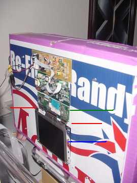

Someone else posted a pic of a slightly similar LCD. Sorry forget who but it was here- I saved the pic cause its kinda like my situation.
The lines I added to help describe some.
Green-this is a L shaped board on mine so its just a little smaller. The prob is its solderr where you see the red lines by 3 metal ground tabs to the frame that you see is bent? in this pic. Save it and zoomx2 or 4-it helps😉 .
RED-point where it is solderd by 3 ground tabs, very small.. one middle one at each end. Now under that? Thats is part what I'm asking. This Board at line green is conected to the lcd somehow. Is it at this point RED that it has a black ribbon or somthing under it? To conect it to the LCD.
Blue-the frame peice I'm refering to that the board is grounded to at line red.
Will post pics of my own when I can but its really similar to that.

I got brave and just snipped the ground tabs to the lcd panel metal frame. It works great, I'm suprised after I striped it! The black lcd ribbon was there under the frame and looks almost identical to the pic I posted. Getting back camera anyhow.....seems when you dont have it you need it most! Some weird lenses were under the lcd and i will eventually post pics of them on forum as I dont kow what they are. You'll def. need to see pics of those unless you all already know what I mean-they are silver colored and spred light big time! One has a grid etched into it...😕
