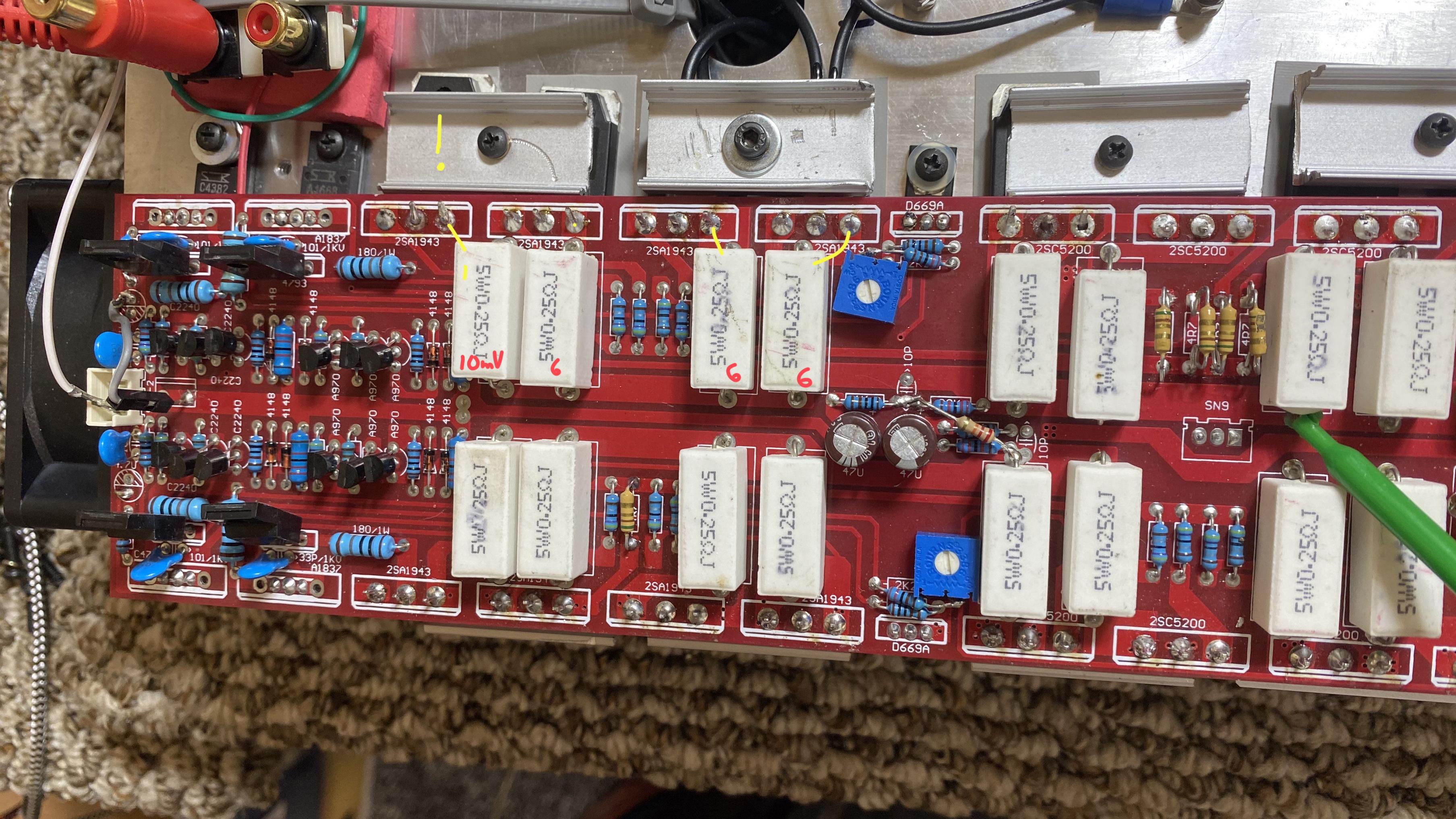

Pics of the area in question. The issue is with the first output device top left.

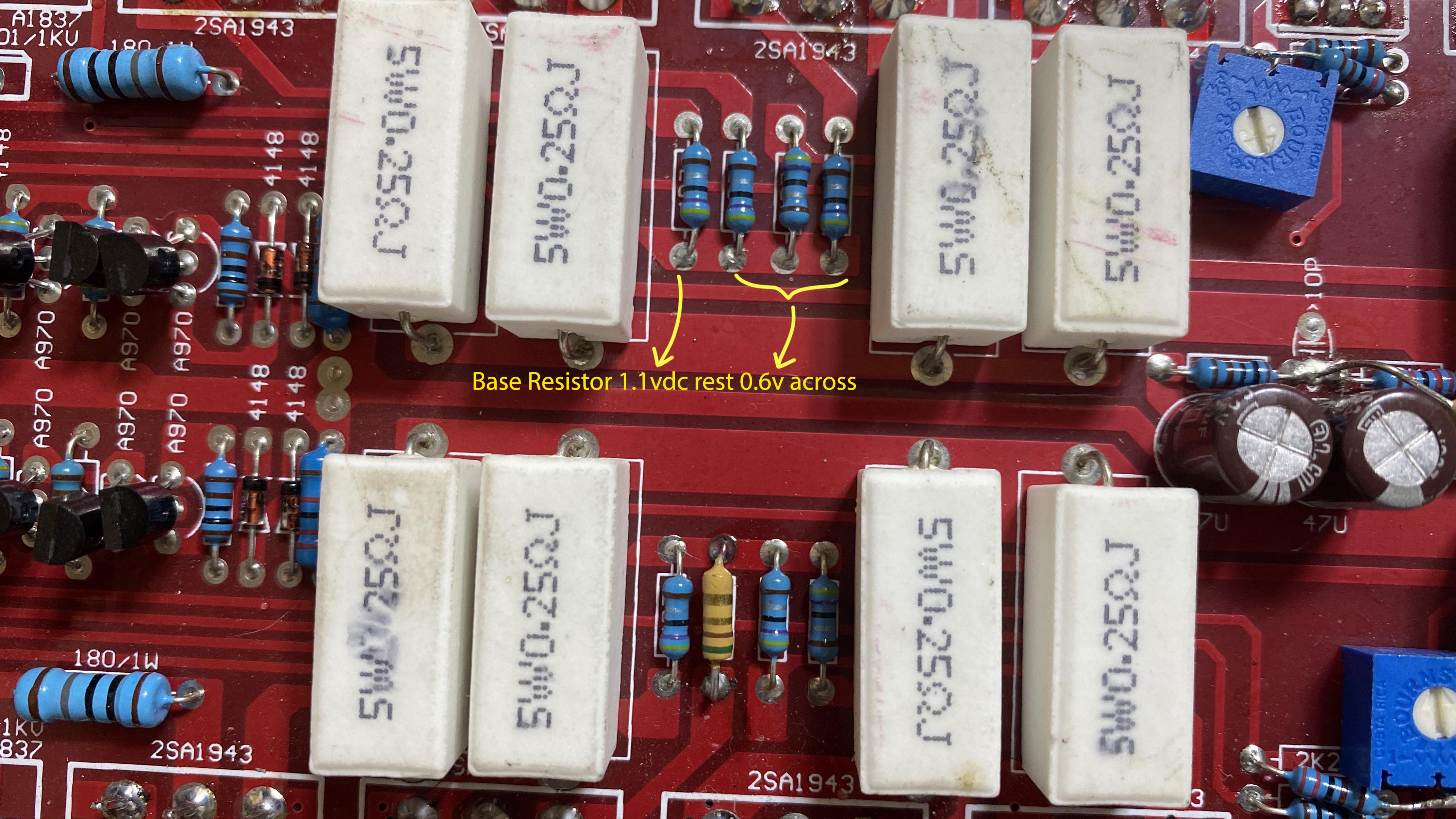

Repaired is a few times so traces are gone from top a few places but actual traces are below the board. The connections are fine.

The key here is that all 4 base stoppers originate from a 180 ohm resistor tied to the drivers emitter, so its not like they are getting different voltage drives , they all get the exact same drive.

Fine.I am trying to make this work as I have 6 boards (12 channels) each channel has 8 OP devices... I am not in the mood to buy another 96 OP devices...

Are these Ebay boards? Where did the output devices come from? As Nigel suggests, it's not really much use changing a single transistor, normal practice with On Semi parts is use devices from the same production batch. If a device fails the devices in the preceding stage should be replaced as well, as they would have taken a hit when the output device failed.
You dont have to buy 96 to prove the problem just one set for one amp.
If that fixes the amp you know where you are.
If it doesn't fix it then the problem is elsewhere.
Where did the original 96 comes from ?

As far as I know you don't get original 2240/970 transistors any more, maybe they are fake as well. Increase the Re to 0.47 or 0.68R, the voltage drop over the emitter resistor will be lower.I will not trust any components in that kit.
Tks Jan.
I used a 0.47e. The vdrop on the ER went from 10.4mV to 16.3mV. I wood have expected an increase in vdrop but decrease in Current. But the bias on that device is still 35mA vs 25mA for the others. I can try 0.68, but this will be amost 3x derating vs the rest.
