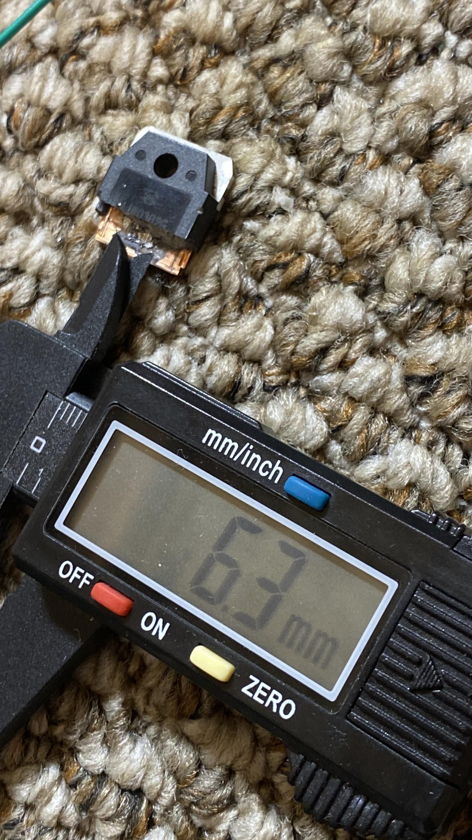

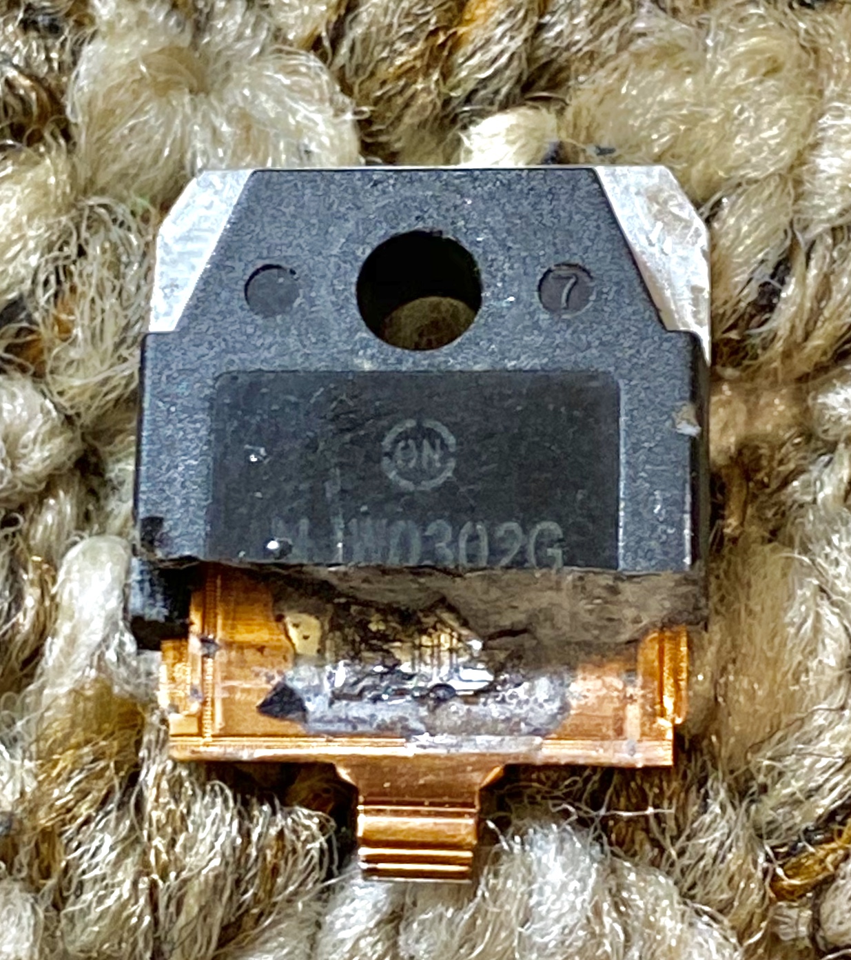

I am having a bit of trouble with a kit amplifier in what I believe being the output stage matching. Had issues before where one bjt would get hotter a lot fast than the others (current hogging) till it blew. Then after matching all outputs to within 2-4% of hfe and vbe, The amplifier ran fine, I was good till I did something and blew the amp...
The OP stage is 4 pairs of njw0302/0281 connected via 0.25ohm ER's and 4.7ohm base resistors from the drivers.
I replaced the shorted device, and after playing for a few minutes into a lowish load (4 ohms in bridged mode with +/-58vdc rails) one device blew again. I know the 4 pairs can take this load as the amp had been working fine for several weeks running stable.
As soon as it blew, I felt the temps on all of the devices by touch and the one that blew was a lot hotter than the rest, I assume it is was hogging current.
The other 3 have hfe ranging from 115 to 117 and the blown one was 107. The Vbe showed similar spreads. The replacement was not an optimal match as I did not have more devices to match it better, so stuck in the closest one I had.
The question I have is... given the devices I have , Is there a solution where I trim the current to each device? eg. should I increase base resistors from 4.7 to 20 or 30 ohms to allow better current sharing? or ER's? It seems these super beta devices like to take up all the load onto themselves.
I thought about the devices being fake, but they seem ok from what I can tell (see pic) , the wafer is over 6mm which is similar to the other 100-150w bjt's I have seen.
The key I feel is the fact that only one device got hot, not the others. After removing that device, the other 3 on the rail seem to work fine... all share the same temp.
What do the experts suggest?

Since the one with the lowest hfe blew not sure it was current hogging. And the matching of the transistor hfe that you had was very close. Most comercial amps are not even matched. Are you sure the transistor and bias spreader were properly heat sinked? You can measure the current to see if hogging is happening, by measuring the voltage across the .25 ER.
I used silpads, so that may not be the issue. Also I measured the hfe with a TC-1 which only uses something like 6ma? to drive the DUT, In real life there is a lot more current flowing... which may have caused it to current hog.
Something is not as advertised. Perhaps one resistor is not the same as the other 3? Perhaps the speaker/load is connected to the wrong end of that resistor? Perhaps the one resistor is shorted?
Yes, something like that.
The values you measured are way more matched than average, and amps are not exploding all over the place.
Still suspect marginal fakes where the weaker one dies first and protects the others by blowing the main fuse but also would not discard a gross misconnection error.
I was burnt by a lot of fake TDA2050 which overheat and explode, even no load, no signal, so it´s clearly a voltage rating problem, with TDA2050 sized rails: +/-22V ,yet are happy as a puppy and run cold all day long at +/-14V , so they are probably relabelled TDA2030 or similar.
Not junking them, just will use them within demonstrated parameters.

In 40 years of amp building I have never matched transistors in my amplifiers either self designed or designed by others.
The fact the faulty transistor is red hot suggests breakdown voltage was reached and they turned on fully.
Buying in transistors etc from ebay/China is a big lottery.
