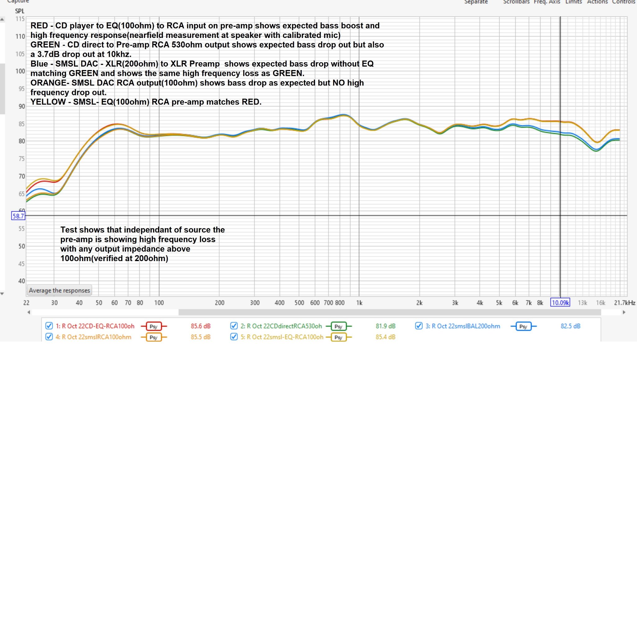

Well, I've got some more data. My SMSL DAC arrived today with has a 100ohm RCA output and 200ohm XLR. I ran the same tests and got the exact same results as with the CD Player. The pre-amp handled the 100ohm load just fine with normal frequency response but couldn't even handle the 200ohm load from the balanced output of the DAC. One thing I find confusing is that the 530ohm output from the CD Player caused the nearly the same high frequency drop out as the 200ohm balanced load. Perhaps the input impedance is different for each.
@rayma I wanted to do the testing and give the manufacturer some additional time to respond to my request for warranty support before outing the company but he continues to ignore me. I'll pull the pre-amp out and get some pictures of the circuit later today.
Also the charts look different than the ones yesterday as I measured those at my listening position and today's are measured near field at the speaker to eliminate room interactions and keep them more consistent. You can see that all the traces are matched within 0.4 dB where they aren't affected by the EQ or the high frequency drop out.

Well, I just measured the input impedance on the pre-amplifier using variable resistance between the source(1khz sine wave at fixed voltage) and the input of the pre-amp while measuring voltage at the output of the pre-amp. I set it up so that the voltage at the output read exactly 0.5v and then inserted different value resistors between the source and pre-amp until the output was halved meaning that the resistor and input impedance of the amp was sharing the load equally.
First I tested with a 100k resistor 0.500v turned into 0.007v clearly the input impedance isn't even close to 100k ohm
50k resistor - 0.125v so it's not even 50k
10k resistor - 0.323v so we know it's between 10k and 50k
19.7k resistor - 0.234v ....so it's under 20k!
17k resistor - 0.251v Bingo!
So not exactly the 100k ohm input impedance advertised by the manufacturer. This jives with the fact that the Rotel pre-amp with 47k ohm input impedance was able to successfully reproduce the signal without impact but the supposed 100k ohm pre-amp wasn't.

Not really, a device with 100 ohm output impedance should be able to drive 17k very easily.
I am not aware of any transformer input audio amplifiers with an input impedance higher than 10k.
Wide bandwidth audio transformers are difficult to build higher than 10k. For this reason, the impedance
levels are deliberately kept low as possible to extend the useful bandwidth.
It actually works as expected with 100ohm but with the 530ohm output impedance from the CD player it starts falling off at 2Khz and is down 4dB at 10khz.
I'm guessing the input impedance will be variable through the frequency range and fall off at the higher frequencies(I tested at 1Khz). I'll probably run the same test at 10khz to see if the input impedance goes down.

Also the measured input impedance is already down to under 3000 ohms at 3khz.
