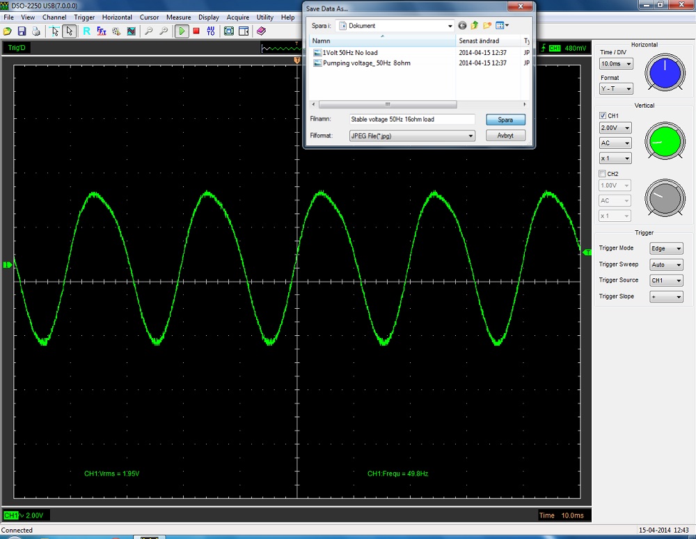

I allso have to tell, when testing with 16ohm load its 100% stable output but with less voltage.. (ca 3volt) When i messure the voltage on the main smoothing caps at 8ohm load i notice a change of some volt upp and down, the same behavior as shown on the output. Are the transformer simly to smal!! ??

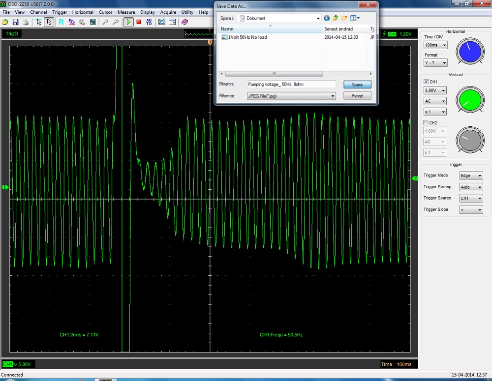

I believe the circuit is working. Just looked at the complex supply circuit and you need T402 to be a powerful transformer. I agree that the 8 ohm load is loading the circuit too much and the output is probably crashing the rails leading to oscillation.

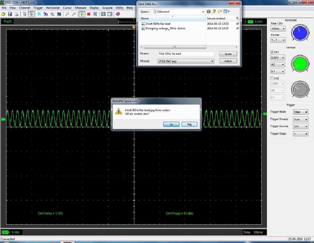

Ok.. Lets try again. Here are the Pictures from my scope , with no load, 8ohm, 16ohm load.
The scope is set to (100ms) for no load and 8 ohm load, in other case it would be impossible to see the "spike" on 8ohm load
What the f... is happening in the midle Picture??? A huge spike followed by almoast no output. I sugest that the output limmiter works just fine... But how does this huge spike apear?? Help Help!!!Ok.. Lets try again. Here are the Pictures from my scope , with no load, 8ohm, 16ohm load.
