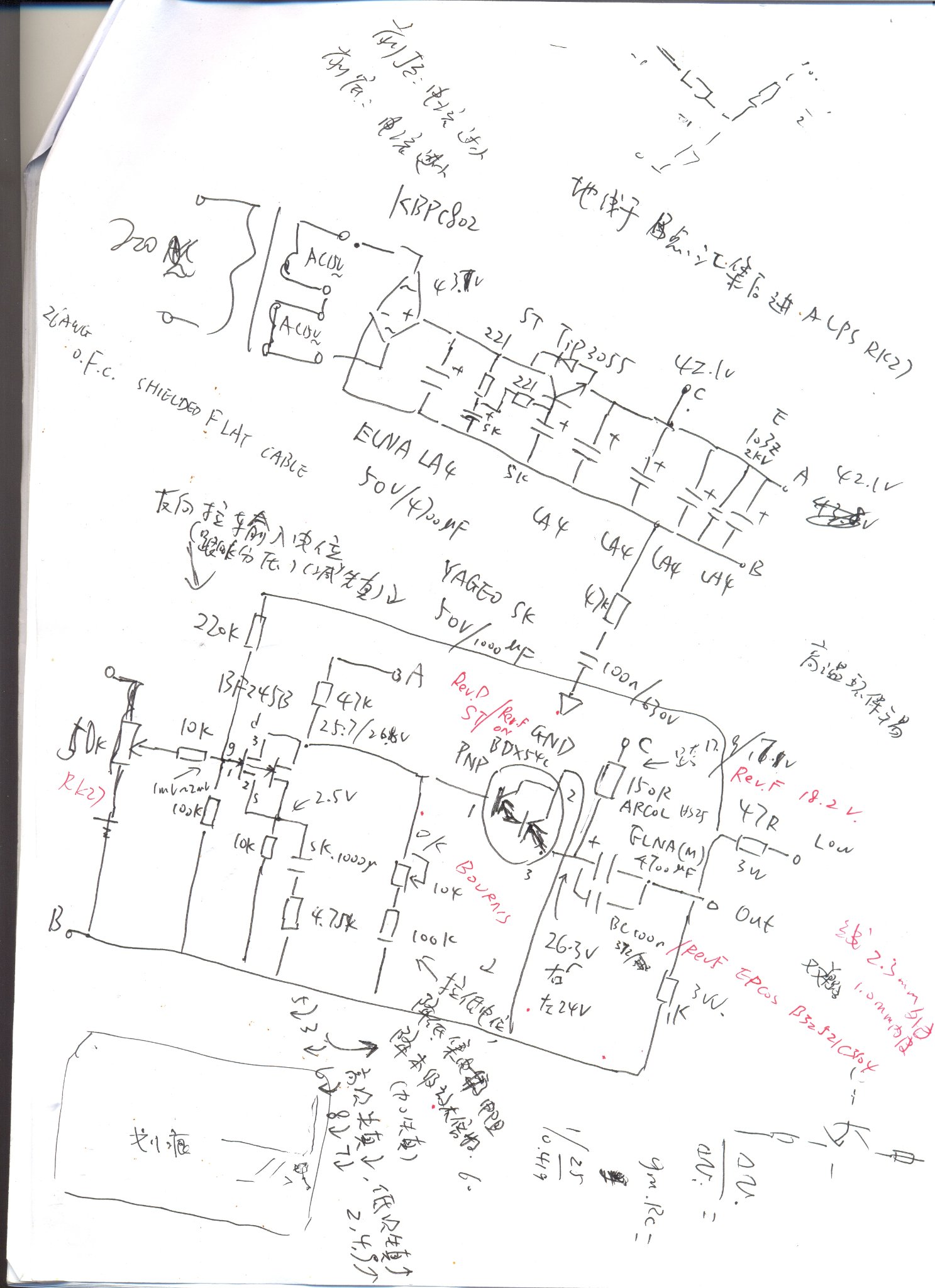

Attached a handscript I had many years ago, notice the res in series with the cap in the source of JFET is 4.7R, not 4.75k. This res should smooth the frequency response of the cap I guess.

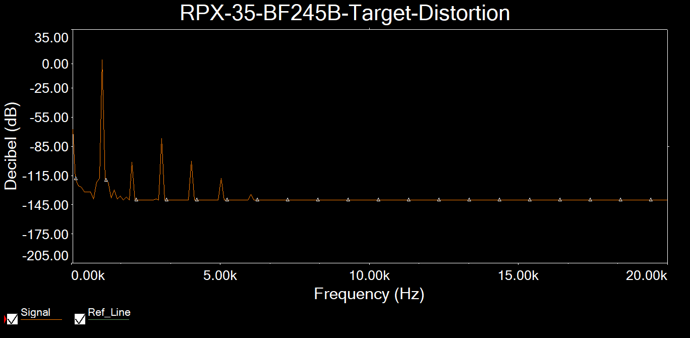

The schem is extremely simple, but opearting point could make a huge difference in distorion. Nelson Pass described this in his article< https://www.passlabs.com/technical_article/the-sweet-spot/>, he called it load line cancellation.
I have made simulation and a prototype, at a very perticular bias point (Mine is 6.8k, at 2.5V), the 2nd harmonic distortion is gone.
