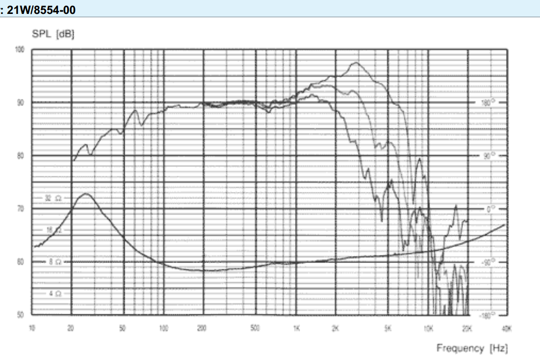

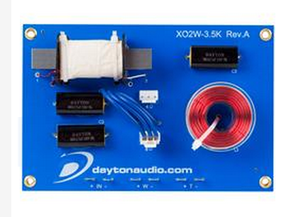

OK, here is the problem!!! Yes, the cabs should be ported and I will do that, but the bigger issue is that there is an 8db bump starting at 1khz up to 3.5khz AND the crossover is a Dayton prebuilt that crosses at 3.5khz!!!

Dayton Audio XO2W-3.5K 2-Way Speaker Crossover 3,500 Hz

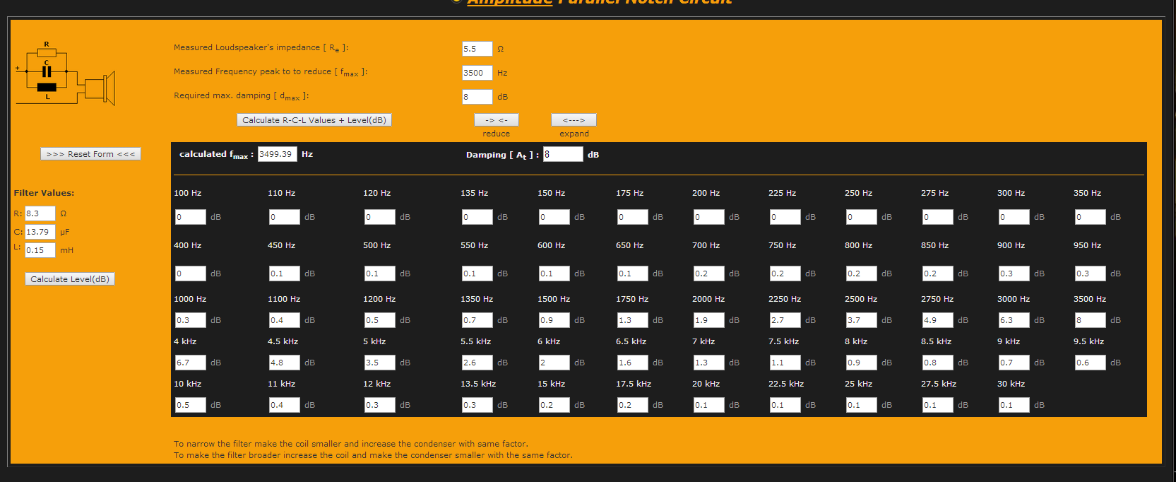

Looks like 4.7uF bass shunt. For all that, 1.2mH and 10uF shunt looks reasonable.
Audiocostruzioni - Il Portale dell'alta fedelt amatoriale
The Scan Speak 21w/8554 is a low inductance driver, so that explains the midrange peak. The bass Zobel is around a mere 4.7uF/6.8R.

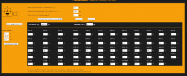

Impedance Equalization (L-Pad) Circuit Designer / Calculator

I would think the crossover can be tuned by ear. 2.5-3kHz. But for me, it's saying third order bass and tweeter electrically. There is something to be said for putting some inductance back in front of the bass to get a tidier rolloff around 3kHz.

PCD7 has software to predict a notch filter, but more often than not, you will find that the figures have to be fiddled with in the program before you get the result you want. For that reason I wouldn't trust that online calculator or you could end up with something only marginally better than the dayton XO.

The canned crossover was likely a budget operation to get it up and running, and you could at least "hear the drivers" with it reliably if the large inductor were replaced with an air core job. It gets one the starting point needed to modify or design toward a real crossover. If it weren't there you'd need something similar to get started.

The 3KHz bump has to be addressed in the crossover(*), but I suspect it is benign (without distortion down in frequency). For directivity reasons I'd opt for a 1.5-2.0KHz crossover point, but the tweeter should be "robust". Any idea of the model?
(*) Without modeling I think that baffle step effect and natural FR of the woofer will create a more or less flat response from 800Hz to 2KHz.
