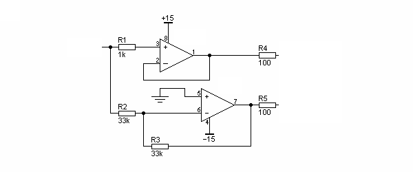

If you can use an RPi, which has some support for streaming internet radio, and may be able to play flac files (not sure), Allo Katana dac can be quite good. With modest, pretty low cost linear power supplies, it can sound like a $1,000+ dac. However, to get to balanced, either you would probably want to use transformers or a two opamp balancer circuit as below for each channel.
EDIT: Just heads-up thing, many dacs that have balanced outputs take them from before the last part of the SE output stage. That last part unbalances the differential dac outputs, but also finishes filtering out some HF noise and junk that can cause distortion in power amps and speakers. If you know how to finish processing the unbalanced audio and take care of it yourself, then the standard balanced outputs can be okay. Otherwise, better to take the SE outputs and rebalance them.
