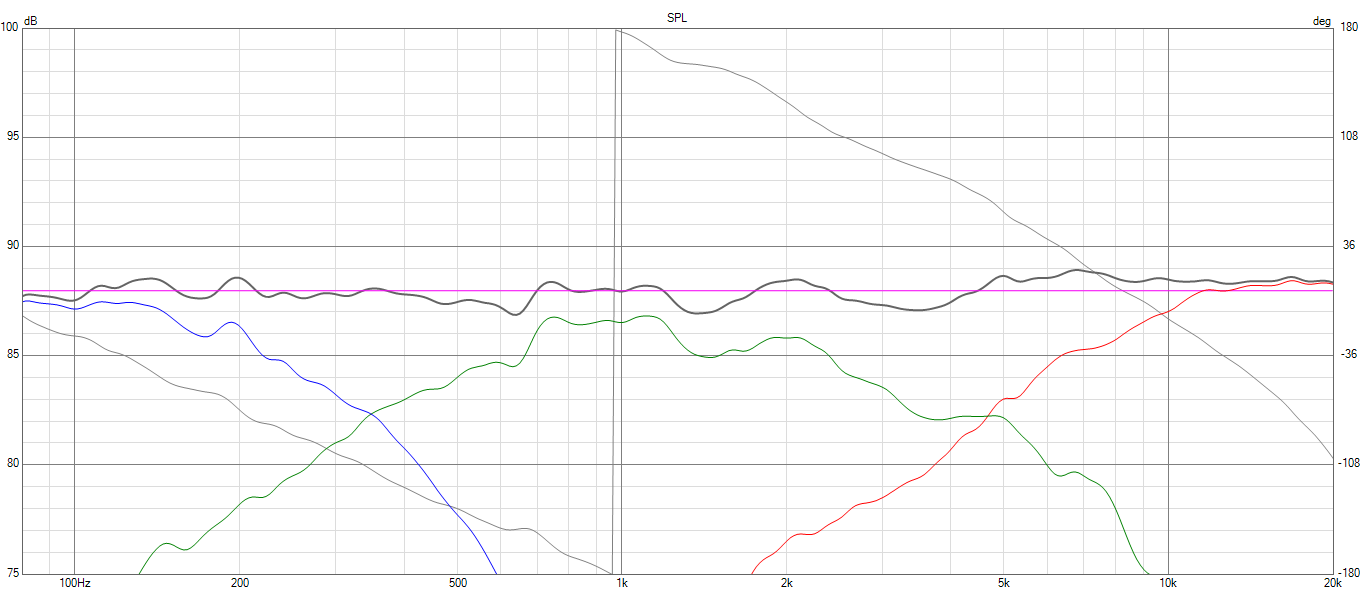

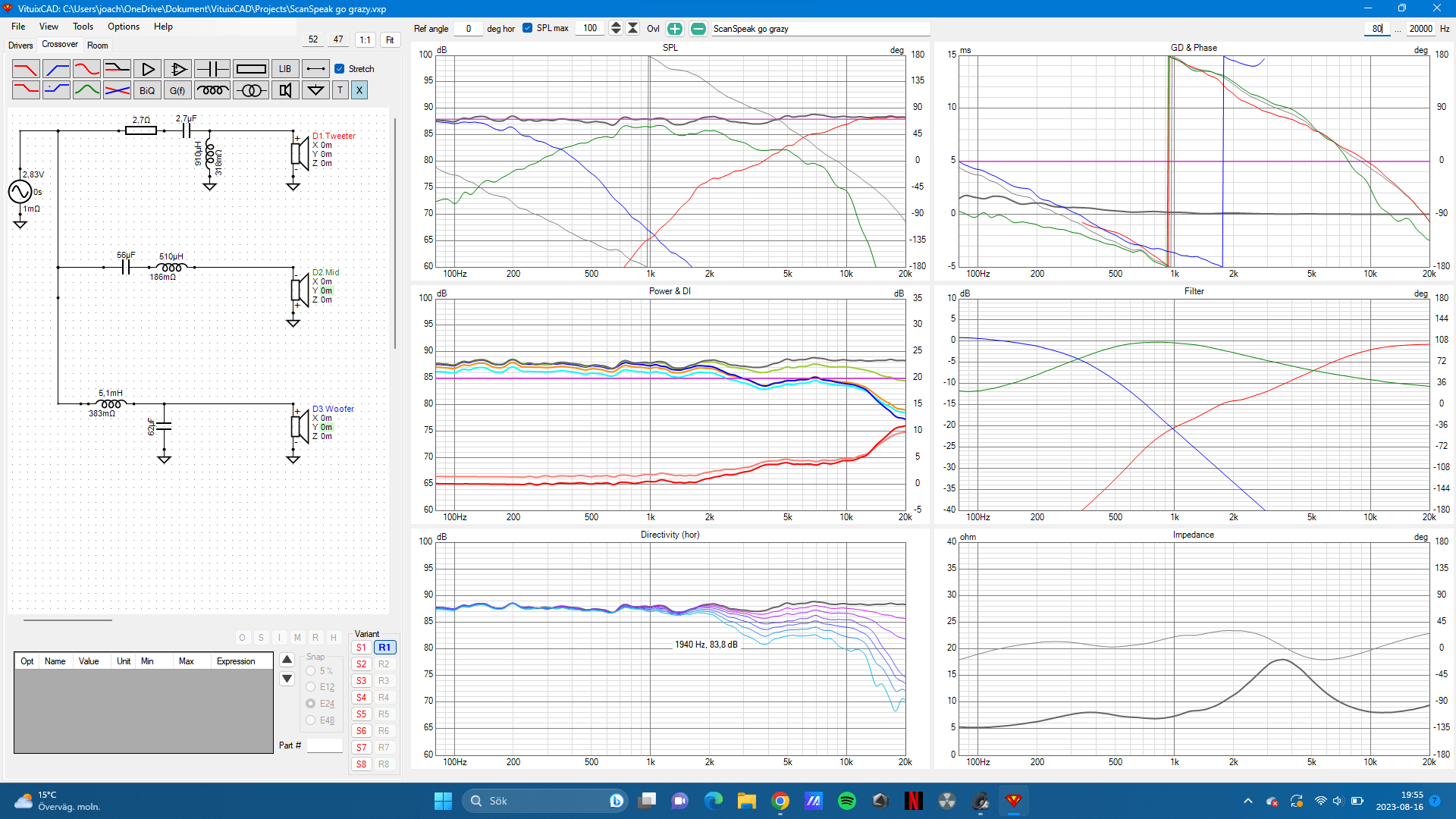

I've been wanting to get into DIY for a while now, a few days ago i found a very good deal on some Scan-Speak elments that i couldn't resist. My DIY journey shall begin!
Drivers Scan-Speak
Tweeter (pair): D2905/950000
Mid (pair): W15/8530K00 Revelator
Woofer (pair): W21/8555-00
Got it all for under 340 EUR including a bunch of crossover parts as well, so not all too expensive for a first build i guess.

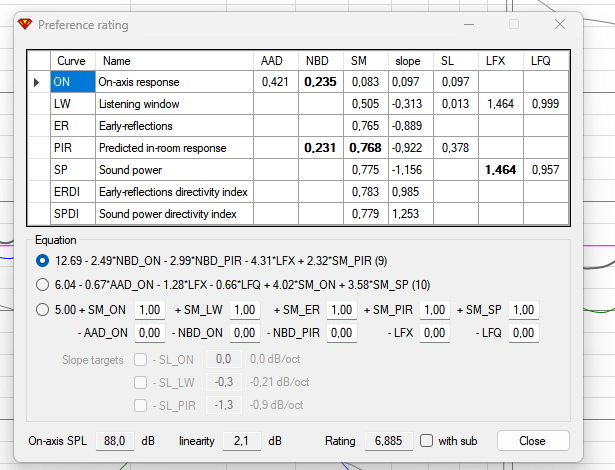

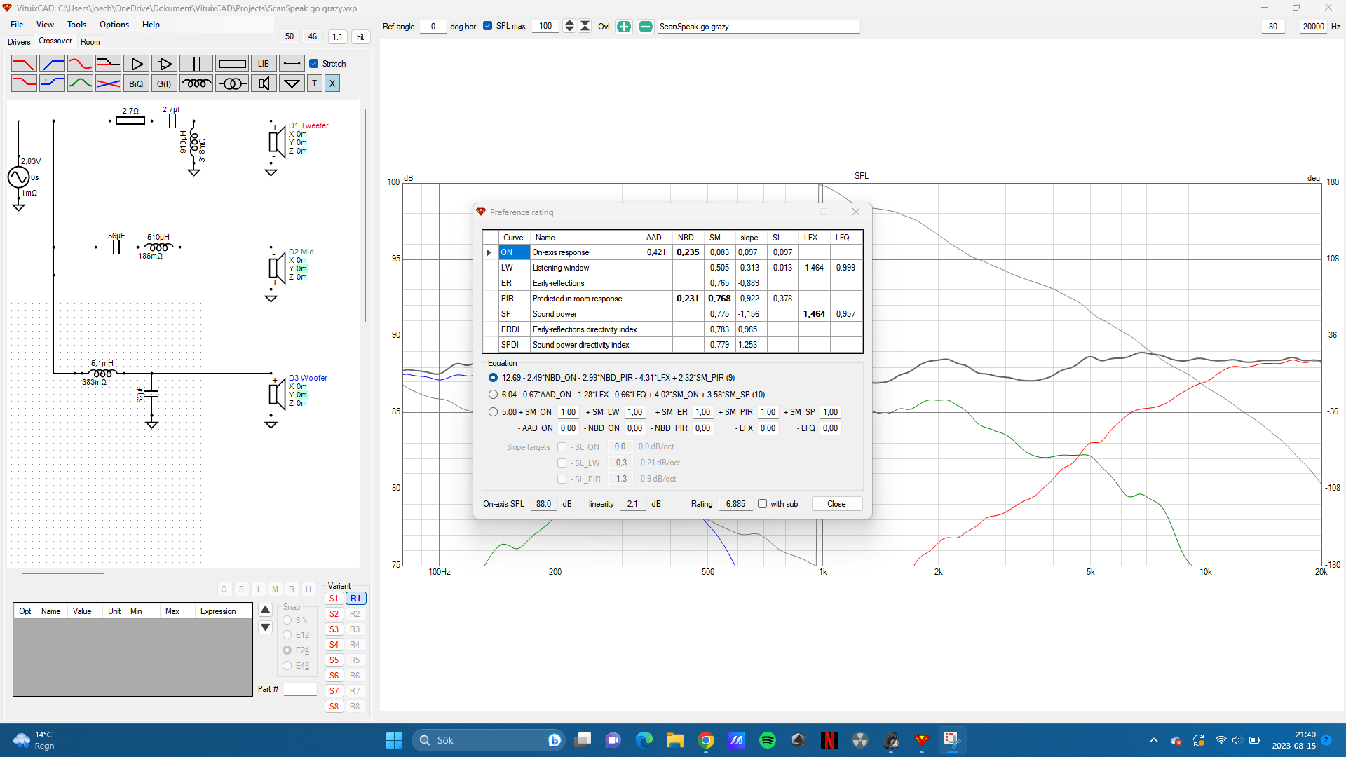

I've been fiddling with VituixCAD for a few hours now (I might also try Xsim later to see which one I prefer). Honestly, I dont really understand what I'm doing at the moment. I've assembled some components and tried adjusting their values until I achieved a smooth frequency response (within about +- 1-2 dB range?). However, it's clear that there's more to take into consideration. I would greatly appreciate a lot of feedback!
I plan to delve deeper into the enclosure features in VituixCAD and also fine-tune the x, y, z parameters for the drivers once I've settled on an enclosure design (I assume this affects phase?). According to WinISD, the woofer's f3 will be 29 Hz in a 50-liter enclosure. Maybe I should aim for a slight boost in the bass because of baffle step loss? Or will room gain compensate enough?
I suspect that the crossover point for the mid/tweeter might be a bit high. I suppose the crossover points are in phase due to the 6 dB summation?
My intention is to measure each driver within the actual enclosure and then base my design on the actual frequency response curves (or is that a bad idea?). For now, I'm primarily focused on learning the process of designing a crossover. I'm aware that my capacitor values seem rather high and could potentially be expensive, but the overall number of components appears to be relatively low, so perhaps it balances out.
I would greatly appreciate your feedback as I'm struggling to interpret the information presented by VituixCAD. Are there any red flags? Any positive/negative aspects that I should pay special attention to? Thanks for your time!

Sounds like a good start. Apart from the choice to pick a 3-way for a first time design. 3-ways are a lot more complicated than 2-ways. Mainly because getting useful input data is a pain.
Learn the measurement thing. It is crucial. And will teach you backgrounds for your crossover design work. Alas measuring bass and mid frequencies (<1kHz) becomes complicated quickly.
Learn VituixCAD on the way. Read user guidelines and backgrounds. For basic simulation Xsim and Boxsim are easier alternatives, VCAD has many features and in that is more complicated. If you are going to design a few systems only, refrain from VCAD.
Would you consider starting with a 2-way design? You could add two subs later, disguised as stands for the 2-way monitors you already successfully finished. Using an active (DSP) solution for the sub/sat integration will give you much room for improvement and learning, without fiddling with a complicated and expensive passive bass-mid crossover.
Just my 2 ct.
Reactions: Turbowatch2
That's a great first start. Don't be put off doing a 3 way first up. I did and it turned out very well. But it does take more effort.
Some observations.

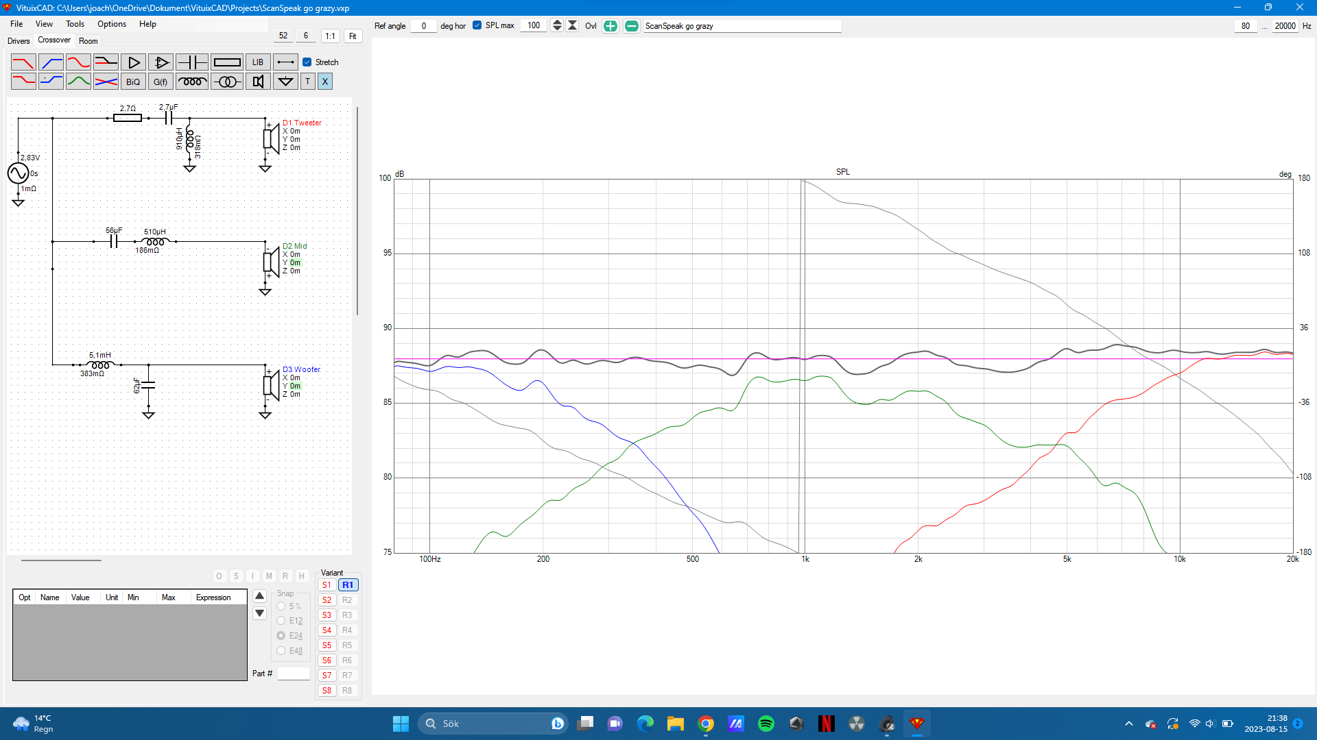

By using Manufacturer FRD data (I assume) - you are using Infinite baffle on the drivers. As you noted - you are missing baffle step "rise" meaning the bass response is overstated. Your woofer will lose 3 - 4 dB sensitivity progressively below ~ 500Hz meaning your overall system sensitivity will be around 83-84dB otherwise you'll end up with a midbass lacking speaker (thin sounding). So either apply a simulated baffle step response to the manufacturer curve, or invest in a measurment microphone and do a quasi-anechoic measurement (nearfield, baffle response applied then farfield merge).
Second - your mid-tweeter could probably benefit with a higher order slope and lower crossover point. the tweeter is capable and you will offer better protection for it (and better off-axis / DI response).

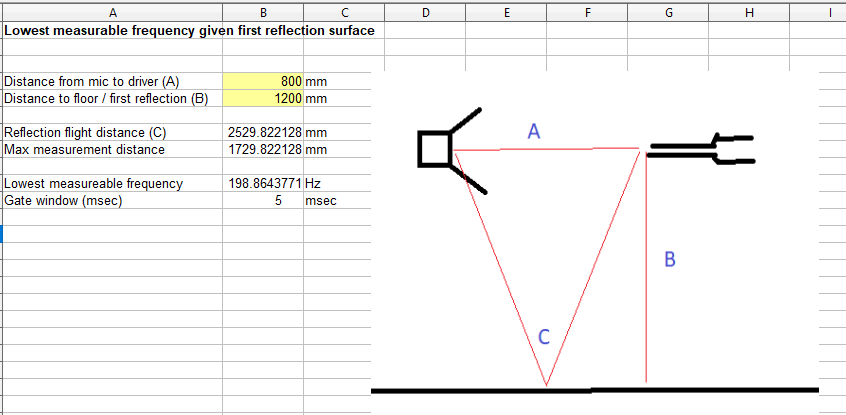

8msec may not be low get adequate measurements for a 3 way if you are crossing 250Hz or lower. This will only give you a 125Hz lowest usable frequency response measurement, and crossovers are best served by at least 2 octaves of data either side of the XO point.
Unless you go outside and do a ground plane measurement or mount the speaker very high off the ground (both require an equal distance in all directions to be reflection free - e.g. a warehouse / gym / hall with high ceilings), a quasi-anechoic measurement is your best option. This splices nearfield and port, applies baffle step resposne then a merge with a gated farfield measurement (e.g. 5msec which we can achieve in most listening rooms)
My suggestion to go for a 2-way comes back to mind...
The merging of responses certainly is viable, but prone to calculation errors. That is why I suggest going for a longer time frame. 8ms is enough for crossing at 250Hz if you roughly combine far field measurements with near field (to check for anomalies). At 250Hz the far field only serves to get the level right, which -being under the baffle step and in room contribution territory- is a bit arbitrary anyway. Furthermore, I would consider crossing W to M at frequencies near the baffle step. This offers addressing both the BSC and the X-over to mid in one step.
Crossing passively at 250Hz sure will bring some more issues: big expensive coils, impedance flattening of the woofer to counter the 100Hz bump, big expensive foil capacitors for the mid and impedance flattening of the resonance of the mid to assure proper working of the highpass to name a few.

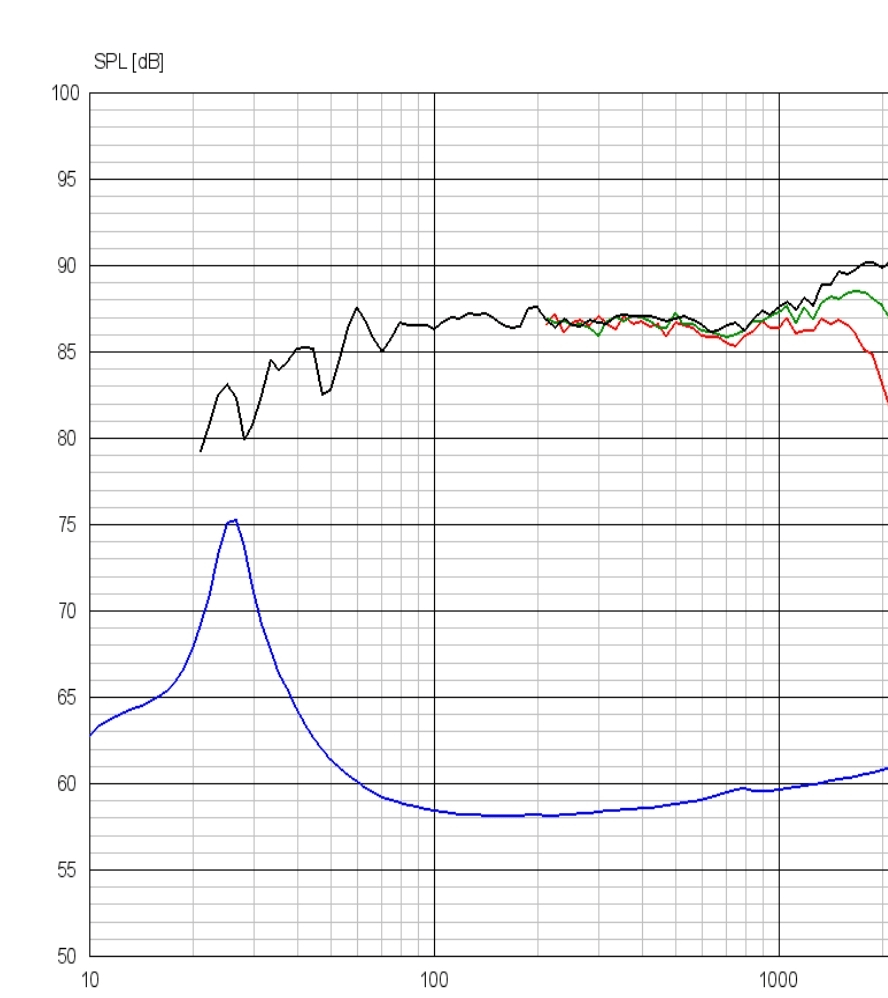

-BSC Your bass driver has sensitivity of 87db, your mid has 86db. You will need 3-6db more sensitivity for bass driver to compensate for baffle step.You already have 1db, so if you put your speaker very close to backwall, you might get away with this doing nothing, but i don't know without simulating.. Maybe someone could?
Baflle step happens when lenght of the soundwave becomes tiny as you go up from bass to midrange, that it stars to become directional and bounces from the front baffle. Effect is that upper range is amplified, and you bass is not so without bsc you will have bass levels playing 3-6db less than mid_high.
You have few options:
-Go for active bass section(i do this with hypex fa251), example of this is Troels MUN17:
http://www.troelsgravesen.dk/ScanSpeak-MUN-17-3W.htm
-Double the bass drivers in series, you will gain +6db sensitivity for bass driver section, so your new sensitivity for bass is: 93db
-Pad the mid with resistors,(this is cheap & easy, just make sure to use right big wattage resistors as troels so they will stay cool (check this out with your prototype playing music for few hours), and check you don't cross to bass lower than 450hz. Example of this is troels Jazzman:

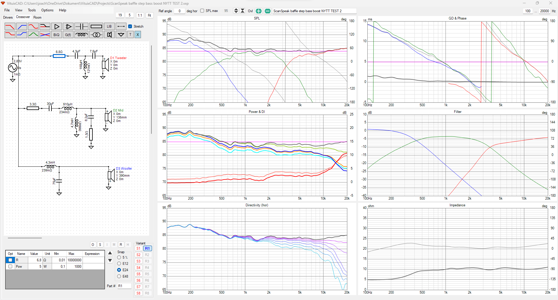

Hi again!
First of all, thank you for all your input, I am slowly learing more and more!

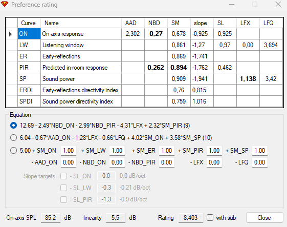

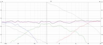

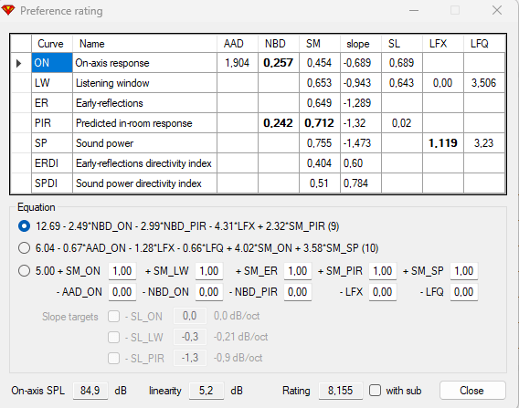

I've done some baffle step simulation i VituixCAD and have made two new crossovers with some bass boost under 500 Hz. The next step i to assemble the cabinets and see how far off I am.
Out of the the two designs below, which one do you think would be a better startning point (and why)?
Theres more "overlap" between drivers in "B" and it has a lower crossoverpoint for the tweeter (2.2k).
Alternative "A" has its tweeter crossed over at 3,4 KHz and less "overlap" between drivers. Freq. response within +-1 dB from 500 Hz. I dont know what "prefrence rating" in Vituix is, but alternative A gets a higher score (8.4 vs 8.15). Alternative A "looks better" to me. Is this a good starting point?
The tweeters Fs is 550 Hz.
Alt A
Alt B

Sanity check time.
You are running 2 21w in parallel so your sensitivity will be 87 + 6 dB = 93dB
Minus 3 to 4 dB baffle step losses (allowing for front wall reinforcement).
Your target SPL should be around 89dB
Why is your target so low?
Getting the right sensitivity is the first step in crossover design. Or all values will change again
