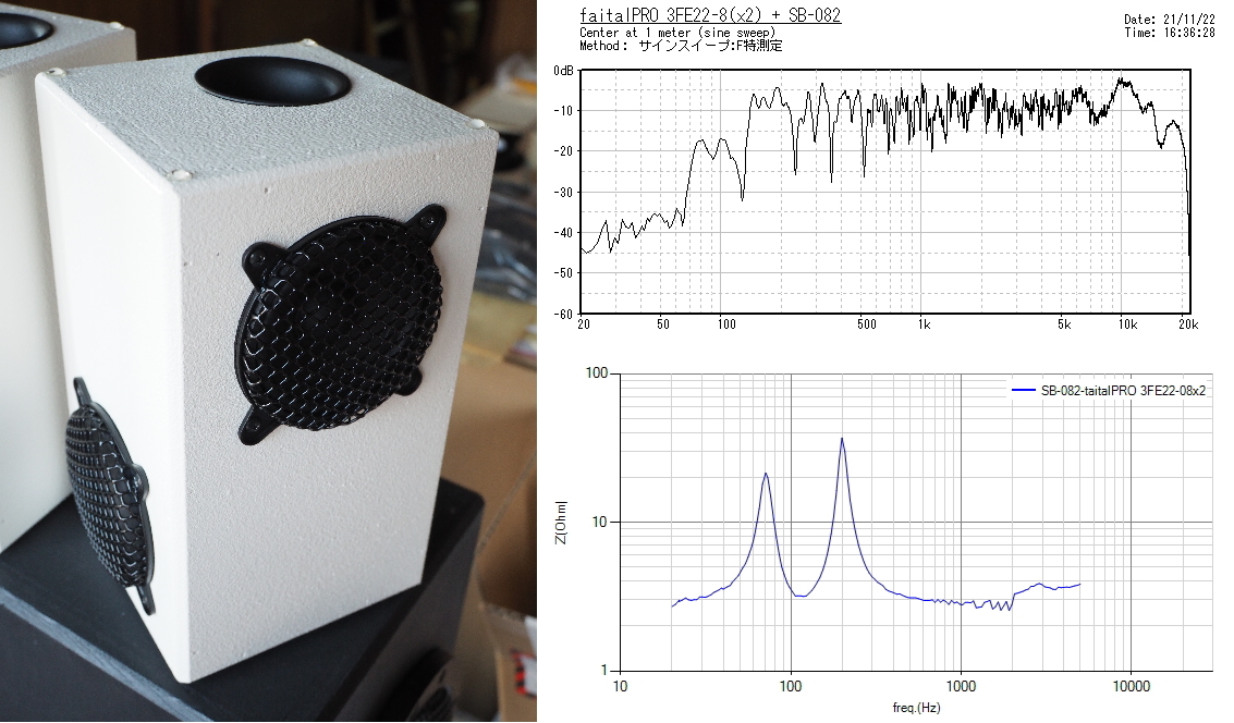

With the 2 driver specification, 100 dB is possible over 150 Hz.
If it is over 400Hz, one driver is no problem.
Reactions: mayhem13
