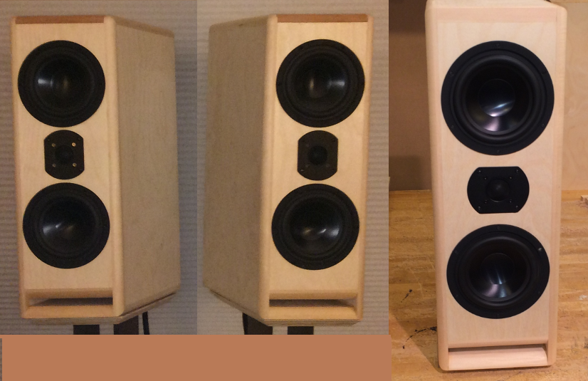

Aye I remember someone recommending the Parts Express RS180 design when I first found this DIY website.
Probably should have listened back then, but then again -- wouldn't have found these (image below) Dayton 28F tweeter with Anarchy woofers: They measure beautifully and have unbelievable bass extension.
Would like to hear a side by side comparison someday RS180 vs. the Anarchy.
