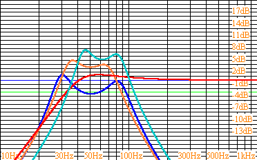

Okay, here are some suggestions.
Four boxes of different configurations. Two are 2 cu ft,
two are 3 cu ft.
Red. 3 cu ft. Closed box. Least output of the four.
Orange. Bandpass. 3 cubic ft total. 1.5 cu ft front chamber, 1.5 cu ft rear chamber. Tuned to 48 Hz.
Lt. Blue. Bandpass. 2 cubic ft total. 1.2 cu ft front, .8 cu ft rear. Front tuned to 60 Hz.
Dark Blue. Bandpass. 2 cubic ft total. .7 cubic ft front. 1.3 cu ft rear. Front tuned to 48 Hz.
Note that the bandpass boxes exhibit higher sensitivity and/or bass extension than the sealed.
Except for the dark blue, the depressions in the middle are not so unmanageable-2 or 3 db. Bear in mind that when a bandpass is near a corner, the tuning frequency is emphasized most of all, and that will fill in the middle depression.
The front chamber can also be tuned with a 10" or bigger passive radiator.
If you want less than 2 cubic feet, let me know,
but you are not going to get anywhere near 30 Hz output if it is smaller than that.
I have never built a bandpass box, but with the extra output it seems to put out, I plan to soon. I have also never used a passive radiator, but I understand the principles. I have built plenty of sealed and ported enclosures.
The graphs are only there to give you an idea of some possibilities.
Good luck!! 🙂 🙂
