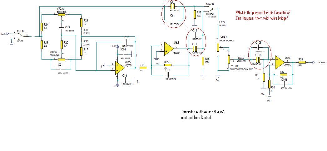

Looking for advice:
Double capacitors 47U and 10N in parallel in signal path, what is the reason for them?
Can I bypass them with a piece of wire?
Regards. Sasha.🙂
:cop: Kjozsi - the material you posted was clearly marked as copyrighted, complete with a statement that the material may not be copied, retransmitted, or otherwise disseminated without the permission of Cambridge Audio. Such materials may not be posted here.
You may hand copy the original schematics or redraw them, and post your interpretation of their instructions with questions. Note any quotes.
Please do not do this again. (Next time will get you an infraction)
