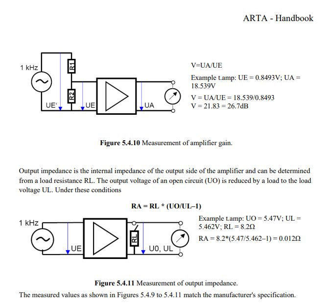

Hi, I'm interested in measuring a SE tube amp with different output tubes and load resistors. I'll be doing the tests initially on my SS amp until I'm confident with the testing process.
My setup consists of a PC with E-MU 0404 PCIe card, pmillett SC interface, Windows 7 (for driver compatibility) and ARTA.
I've done calibration and run the SPA FFT measurement and I _think_ it is working as expected.
Things I'm unsure of: 1) How to set the amp volume - I've been setting the amp volume so that the output voltage matches the input voltage, i.e, if the generated signals is -3dbFS, that is where I set the volume pot on the amp. Is this the correct way?
2) Frequency Response - I've done this both through FR1, and though IMP. In FR1, the response is almost ruler flat. When running the IMP test and marking a region, rolloff can be observed below 40hz. What is the proper way to measure this?
3) Power output - This part confuses me. With signal generator set to -3db FS, that is about 2.8V output. Due to matching the amp volume to input (as described in #1), the output is always 2.8V RMS or ~4V pk-pk. To measure output, I am doing V^2/R (R is the resistance of the dummy load). Doing it this way basically results in the same power output for anything I measure. Opening the pot all the way causes significant distortion, so what is the correct procedure here?
4) Output Z - is it possible to compute with ARTA?

Take a look at STEPS (part of ARTA package) and the Help for that. For amplifier testing the stepped sine method can be more reliable.

Have you tried the method from ARTa handbook
http://www.artalabs.hr/AppNotes/ARTA Handbook Version 2.4 English.pdf
And for power see the handbook for LIMP
http://www.artalabs.hr/AppNotes/STEPS_Tutorial_Version_2_4_English.pdf
and the
3.3. Voltage- or power-related measurements with STEPS
and the
